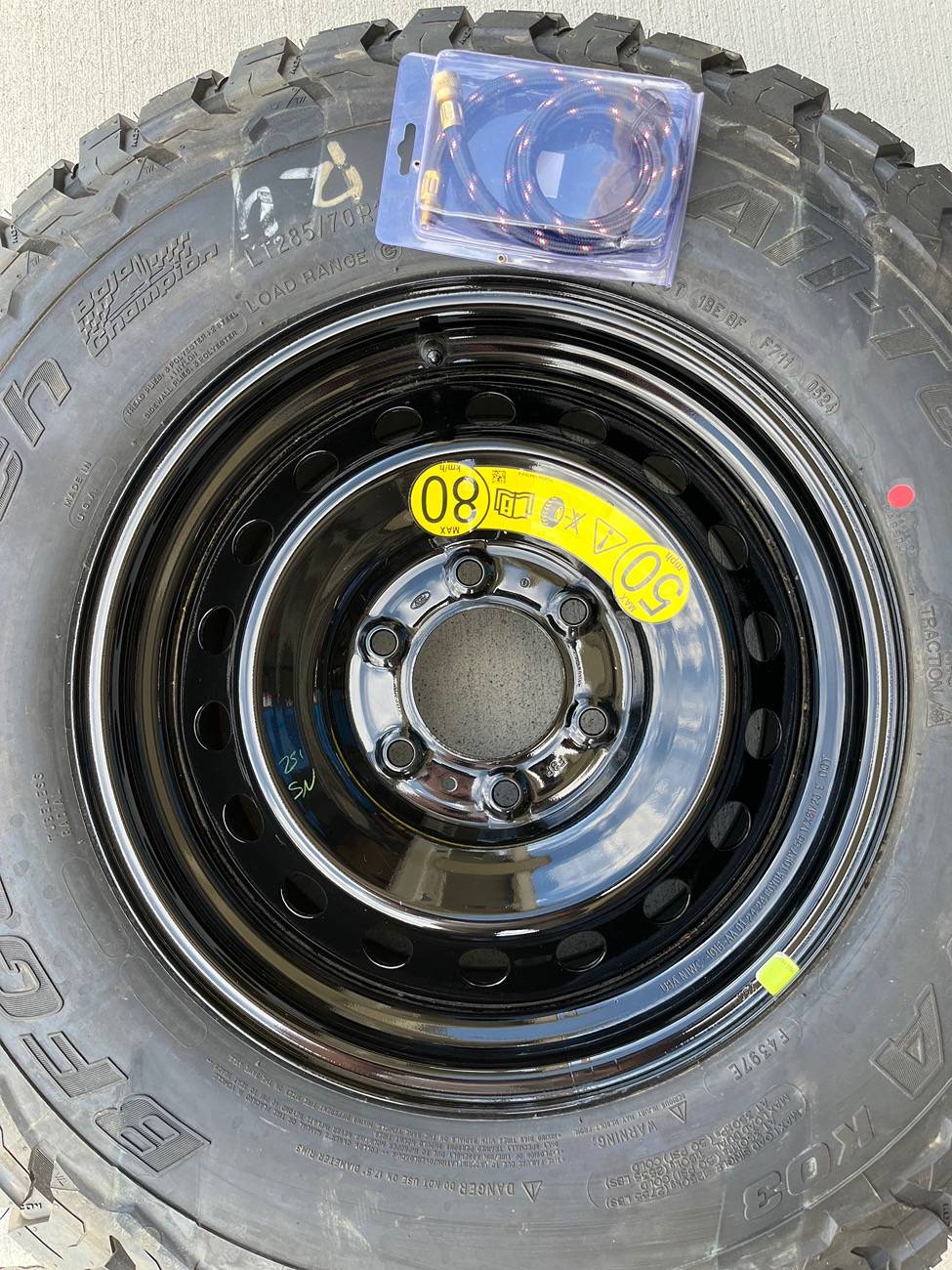

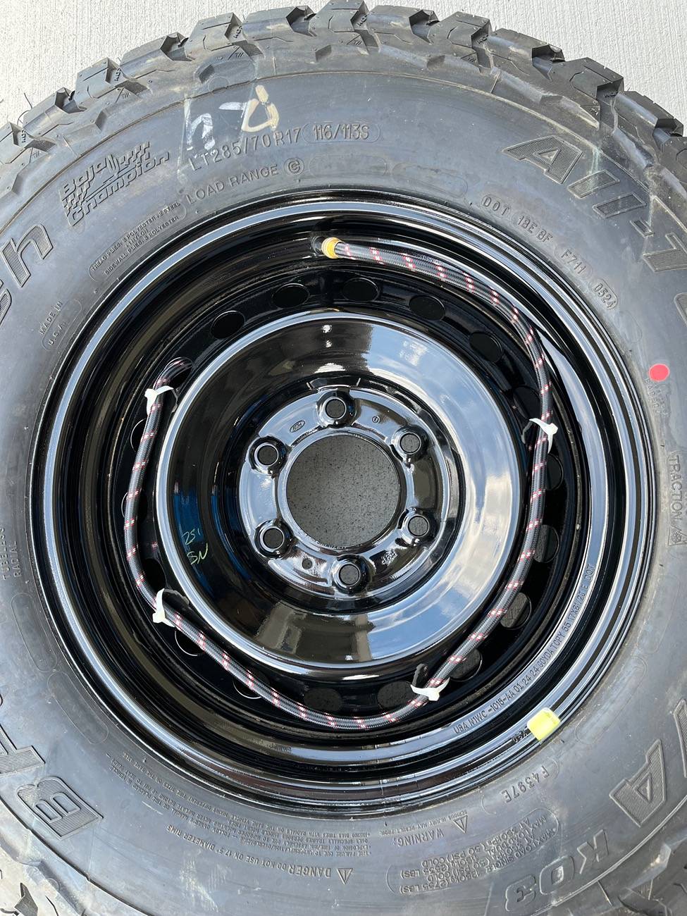

This is a simple mod, I had a 30” one in my spare parts box. Any length over about 10” will work.
EDIT 12/12/25 If it came with a metal valve cap, toss that far away and install a plastic one that can’t corrode and seize. You could also add a tiny dab of anti-seize compound to the nut that screws onto the valve stem, but that part is not nearly as exposed as the one hanging down...

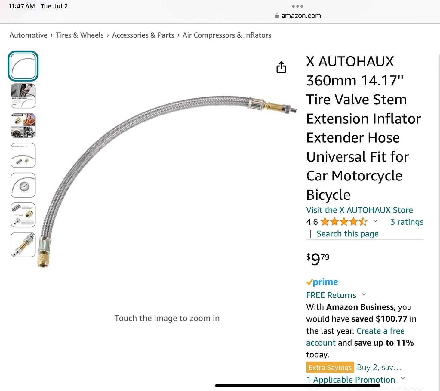

Here is one possibility.
Ford Ranger HOW TO: Spare tire extension hose - check the pressure without lowering it IMG_6816
https://www.amazon.com/AUTOHAUX-Extension-Inflator-Universal-Motorcycle/dp/B0BSNSBVYT/ref=sr_1_11_sspa?crid=XOJNH76BJ30W&dib=eyJ2IjoiMSJ9.lls5pWE7-elpUdZrtYBcJvDRj-NijOppLIxNjakz55L2w5f6ZMNy703XJdrxnZrtfSdY_wabSVR13k328uyLW2GReMkOQFk_W6ufS5uKdWLhFMCKe2qmAKfB9hX2UxNxMSoyBsd6IEPOuNFuWhXEPj06pYWnEG6FDBJU3BZK-ZNpQJXZfy-acy4HwMZfZ_5sw7gjSKRm9Le1UQbzCm1IV_c_Y0OsEQCcMV7_oDTA8KovOvPJerPlzOjwcCTJ1TjraWniyir4l8yaGf97M2yYiPzJxKRqURXxUyj4tr2Xogo.AH2dx_Y__w-Om_PzlRTkxzL267D_q7ah_rzgXs5jAfw&dib_tag=se&keywords=schrader+valve+extension&qid=1719947018&sprefix=,aps,153&sr=8-11-spons&sp_csd=d2lkZ2V0TmFtZT1zcF9tdGY&psc=1

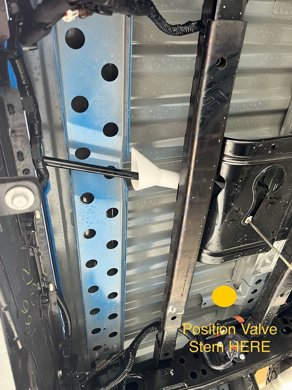

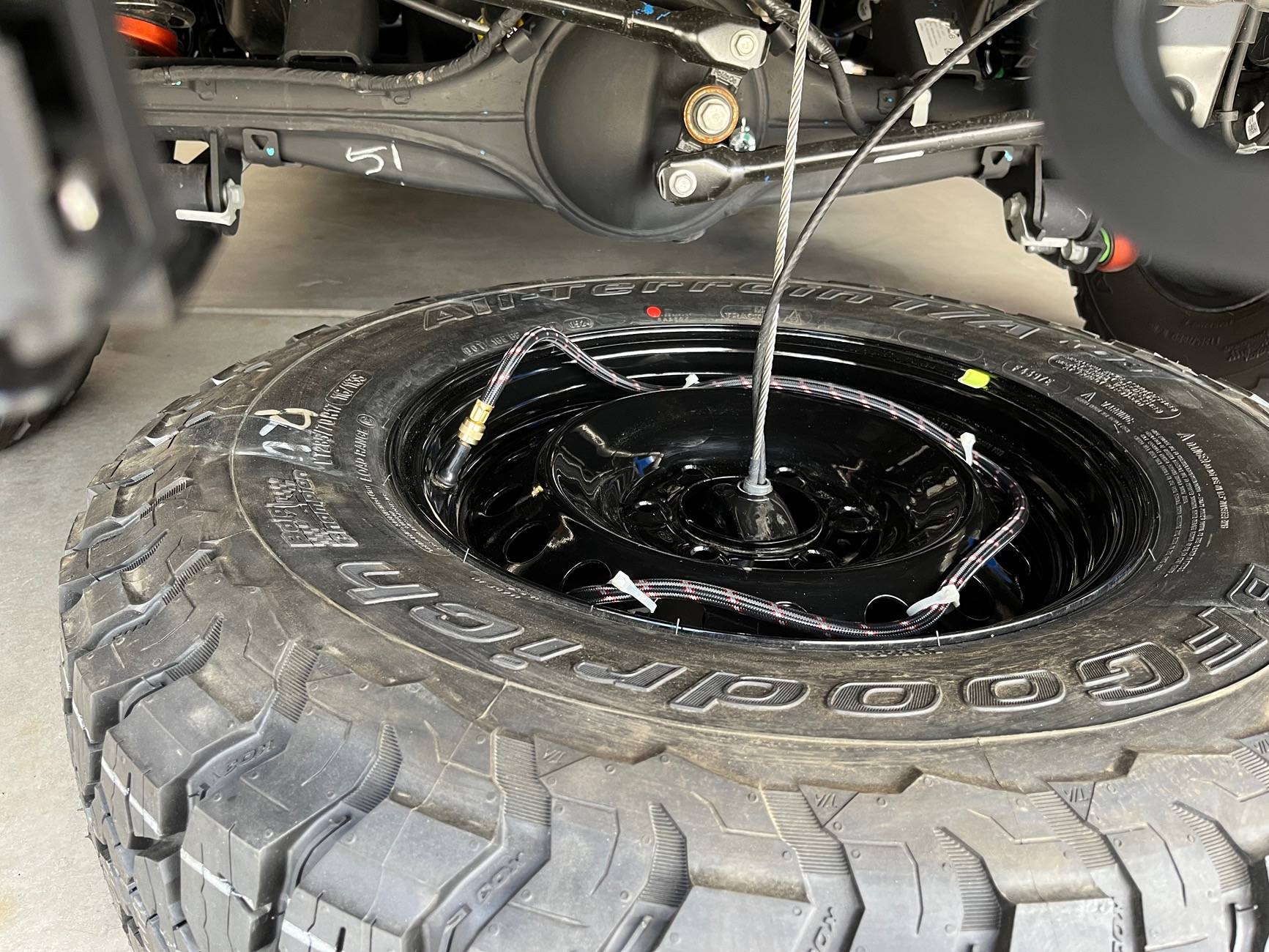

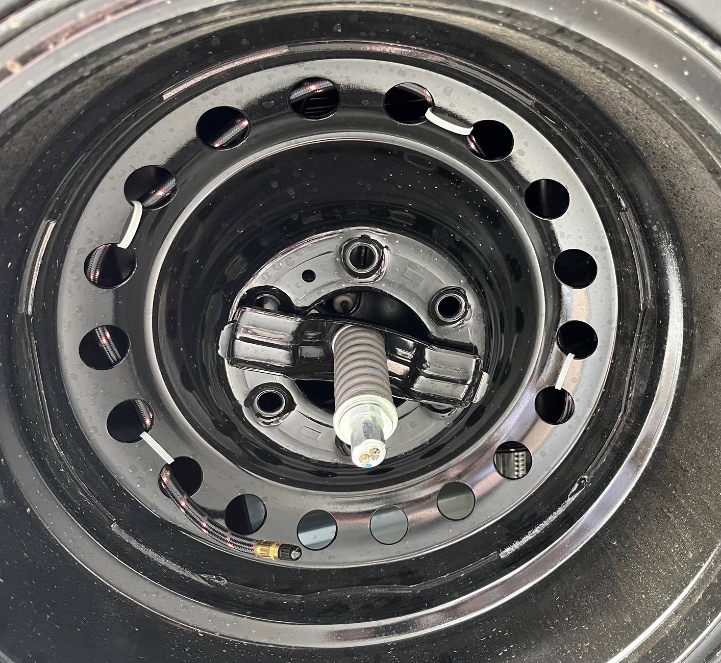

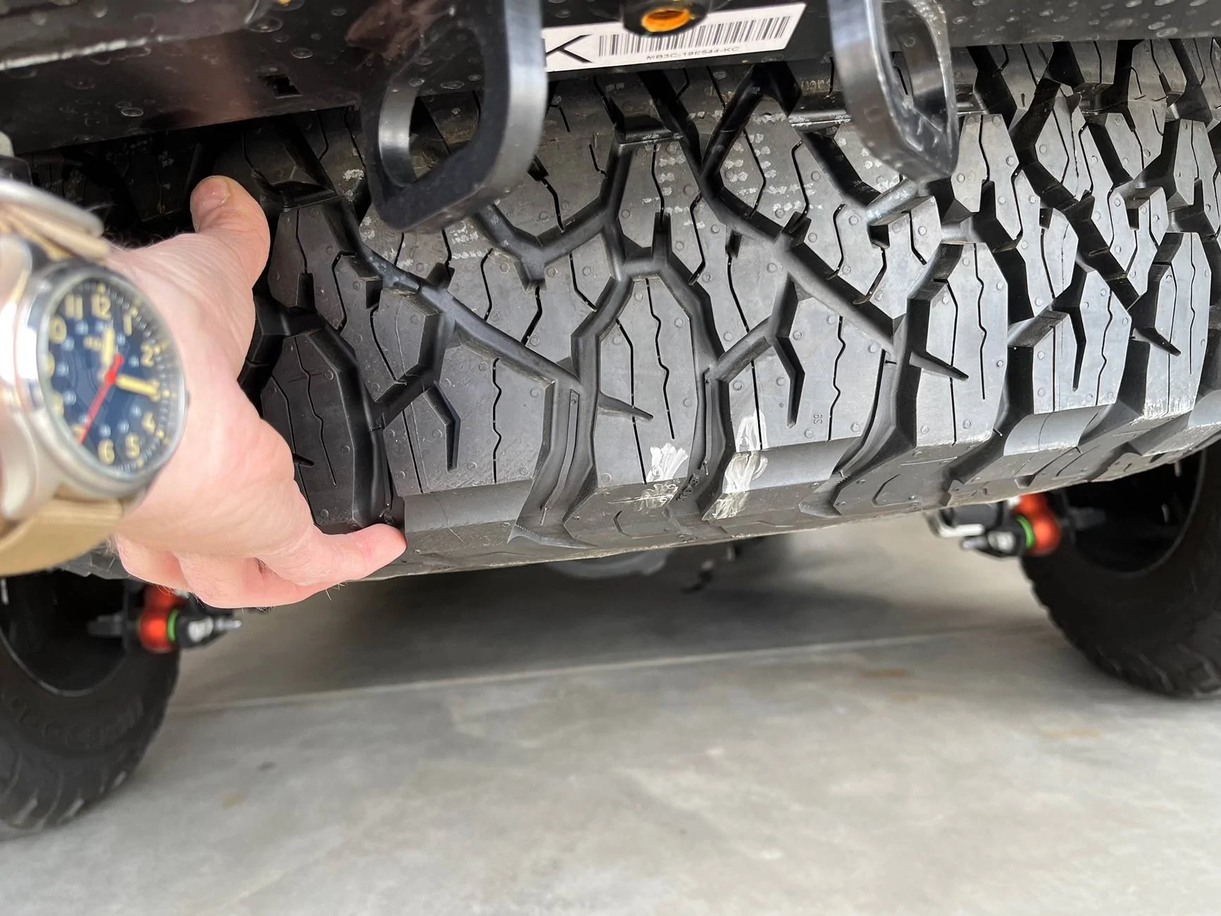

My Raptor spare wheel still had the silly 50 mph max sticker on it, that has to come off. If you have a temporary tire, then you should maybe leave it alone. The hose sticks up above the tire sidewall, so it is important that it be positioned as shown, in a gap between the two support crossbars, and also away from the plastic funnel for the winch handle. I marked the tread with a silver Sharpie, so I could easily get the stem where it needs to go. The tire spins as you lift it back up. Make sure that there is a few inches of hose sticking down, but not enough that debris flying off the front tires could damage it.
I have done this for countless vehicles, I have found that the hose may start to leak a little after five or six years, if you start to notice that the pressure is dropping, it is time for a new one.
