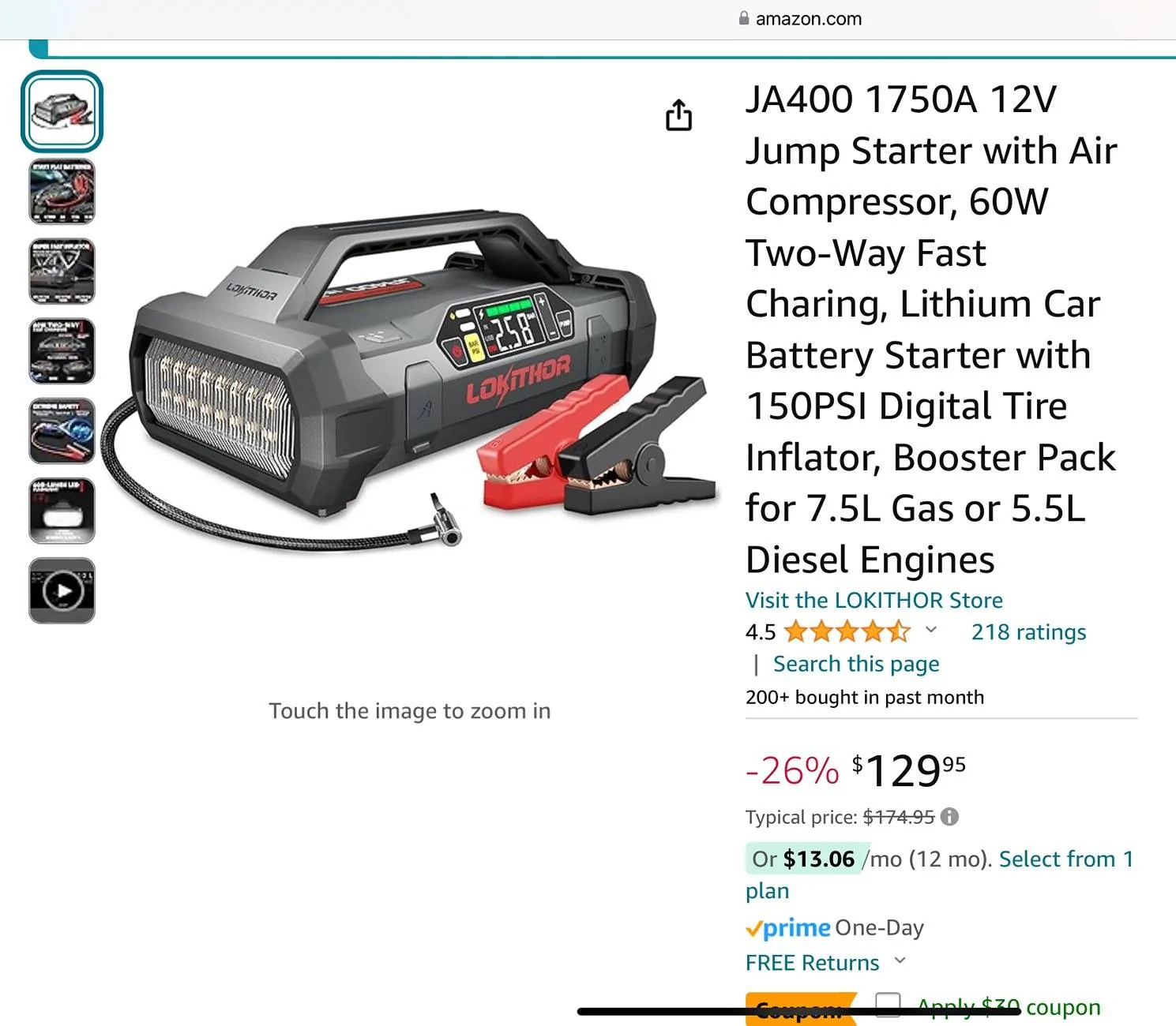

Mine were set to 41. Will lower to mid 30's after my flat tire had me check correct pressure. went up a rugged road to a mine on Saturday and got a slow leak. I even received an email stating low pressure. The pressure monitor allowed me to get off the dirt before total flat.
You really do need a compressor/ jump starter box of some kind for those roads, I just got this unit and I am very pleased with it. It has a safe lithium polymer battery that won’t catch fire in a hot vehicle, and the features are well designed. it is fine for your situation, topping up one or two tires, but it is a pretty marginal for regular airing up all four tires.
Ford Ranger Tire pressure Ranger Raptor IMG_6661
Lokithor JA400
Test it first! I had to buy adapters (extensions) for my beadlock wheels.

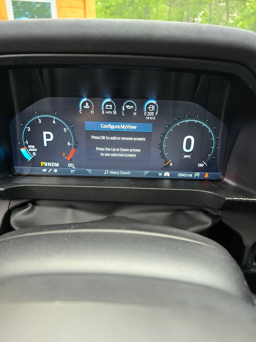

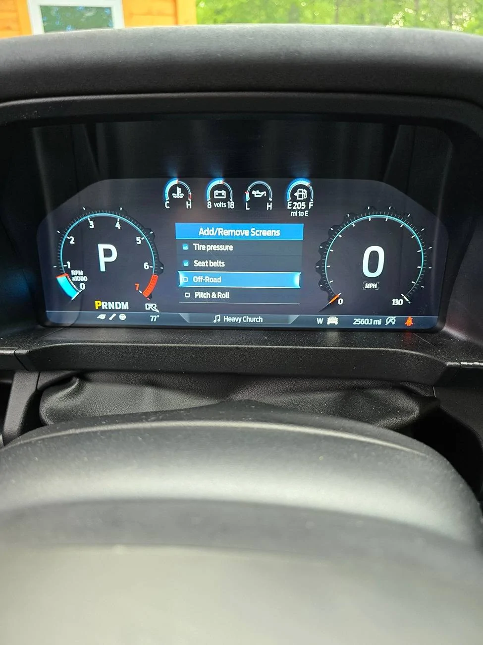

Here you go KevR. Use the "OK" button on the right side of the steering wheel and toggle it up or down to get to the "Configure My View" screen. Then, push that same "OK" button (following the instructions on the screen). Then you check the "Tire Pressure" box, and now your tire pressure screen is added to "My View". And if you ask me that is the most wisest (if that's even grammatically correct) thing to do is to leave your tire pressure screen on your display at all times. The first thing you need when you get in your truck or vehicle is good tires. And when you're driving, you need to know this stuff. Safety's number one with me. And that's the screen I always keep it on. I hope this helps my friend!

Here's photos I forgot to attach.
