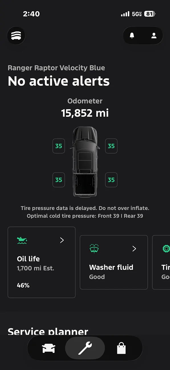

My RR sensors are accurate, but only if the truck is in shade - readings are delayed because the sensors have to “wake up” each time by tire rotation. This mornings readings, outside in 62 degrees - they were set to 36 psi in a 80 degree garage. Close enough, the main thing is to alert you to leakage!
