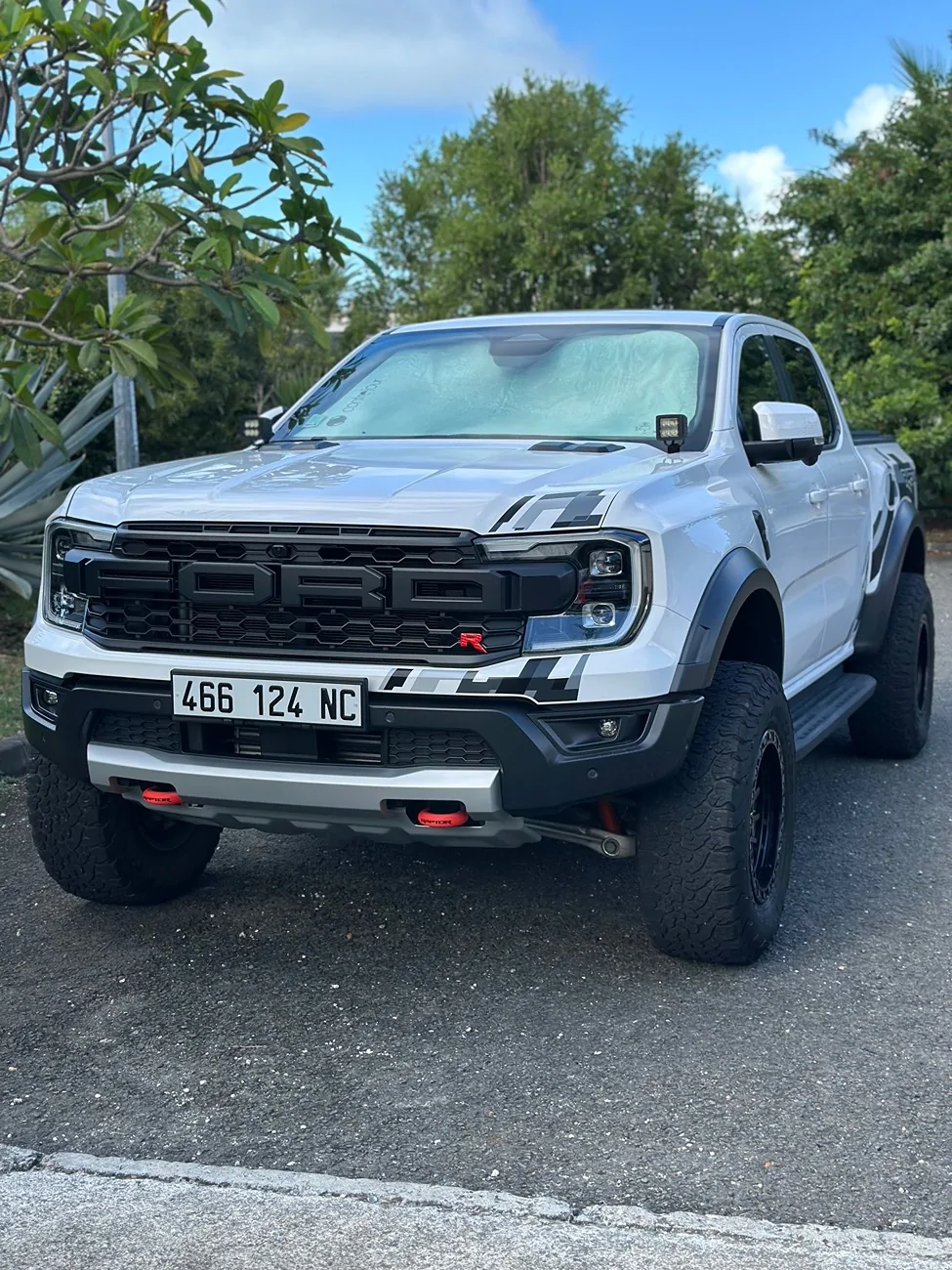

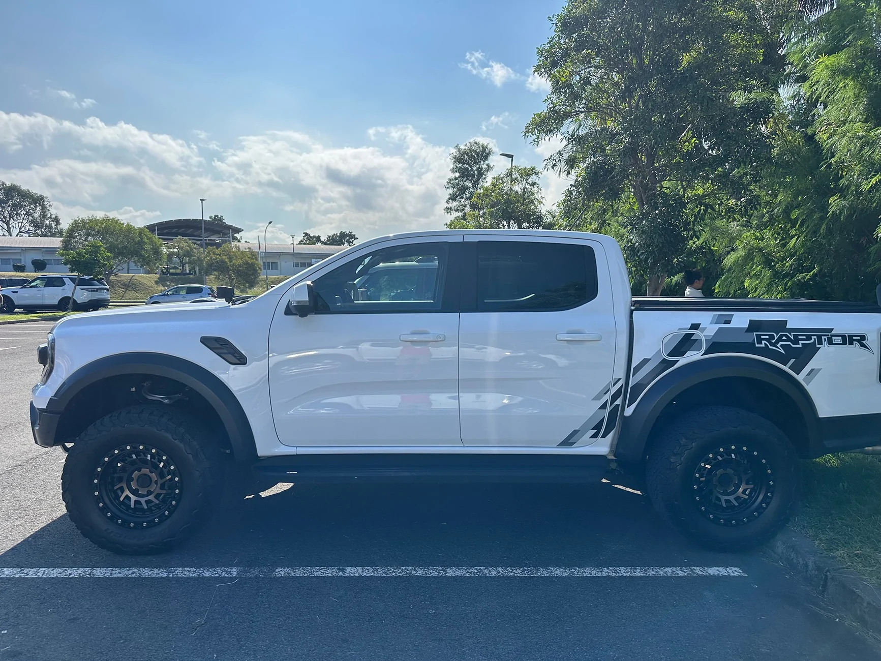

I bought my RR already lifted and I measured from center of hub to fender flare to get 610mm all around.
Considering the stock height is 570mm front and 620mm rear I guess I only have a 1.5" lift in the front? Thanks!
(Tire size is stock)
