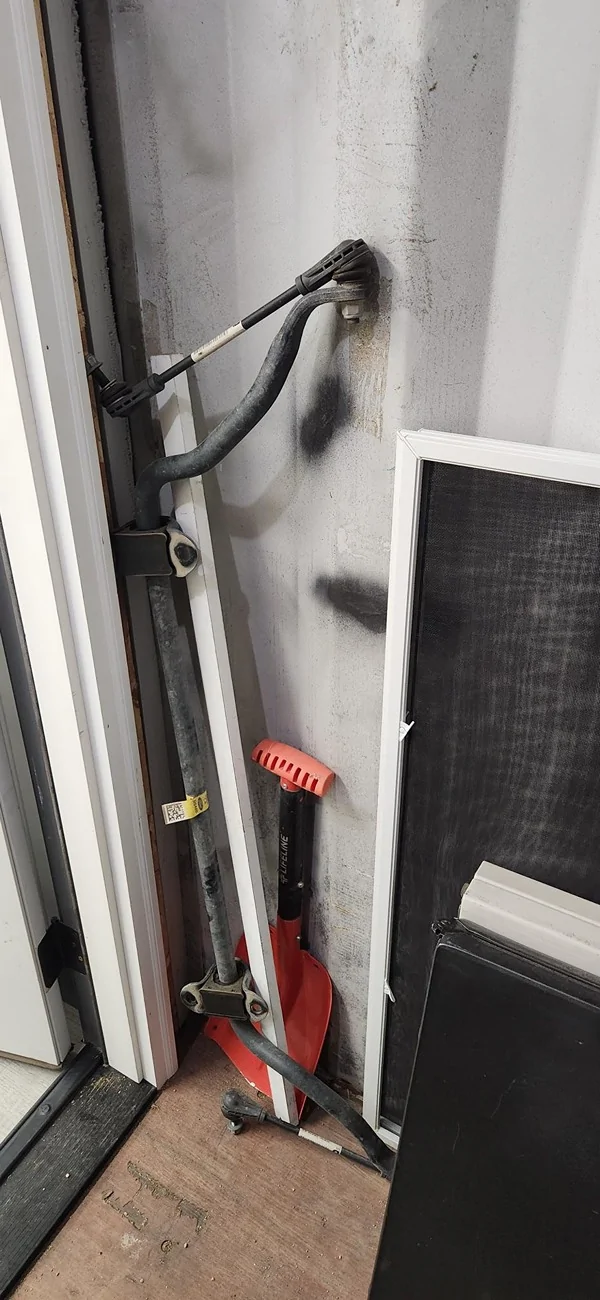

Edge6
Jair
Aug 25, 2024
Montana
It's dirt road season here in Montana (hunting season). I took mine out two months ago. It is a significant improvement in ride quality on rough dirt roads but you can definitely also feel much more body roll on pavement. I will be buying the Apex links as soon as they are back in stock. I cant go back to fully connected when it comes to dirt now that I know how much better it feels.
