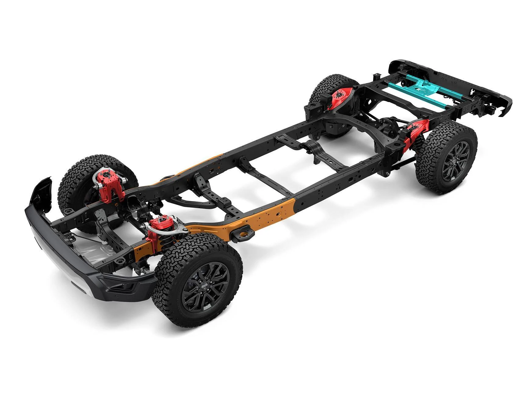

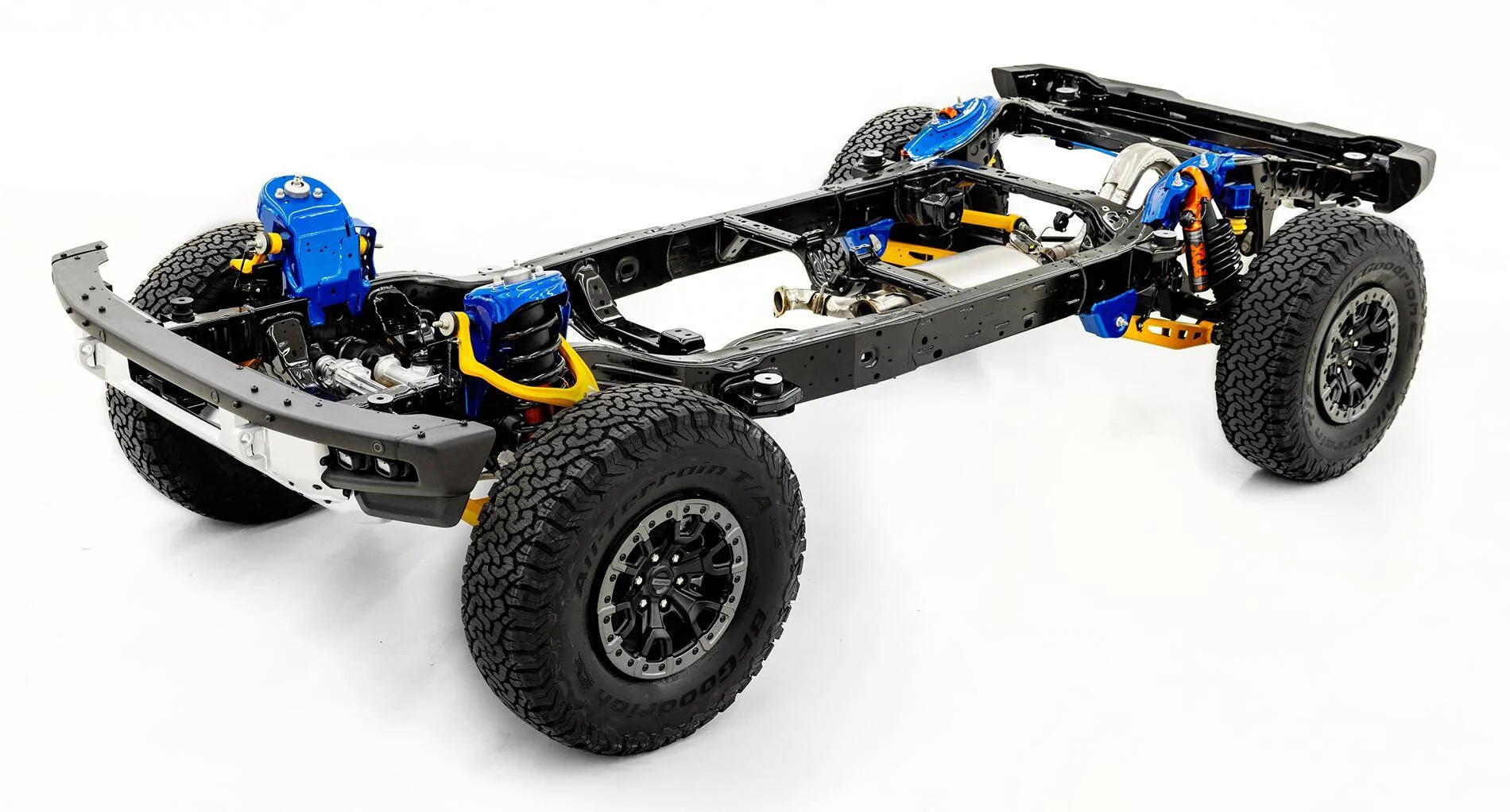

My assumption is that most or all of the suspension mounting points are different due to the 4" difference in travel. Shock mounts, control arms, and trailing arms. You've also got the Watt's linkage in the Ranger vs. a Panhard bar in the Bronco.
Based on the images below, the front shock towers on the Bronco appear to be significantly taller while the rear shock mounts look like completely different architecture.

Frame modifications would be needed so as to add the upper shock/strut mounts front and rear and put them in the proper positions.
Some of the suspension parts/stuff on the Bronco Raptor are taken from the F150 Raptor, so it's not a simple remove this and install that. There are other things, but you'd have to find the youtube video from a couple years back that did a walk around of a Bronco Raptor frame with suspension and such mounted to it.
The tech goes into depth on what is all different from a Sasquatched Bronco, which to an extent applies to the G6 Ranger Raptor.
