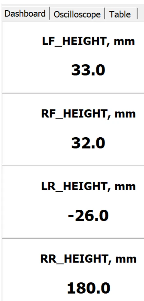

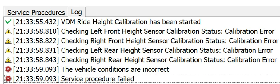

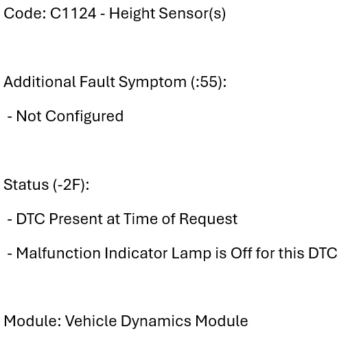

@nedmo your insight was a real asset in the process. Now I just have to get ride height calibration to run successfully. I followed the procedure and it fails per the attached screendhots. My first time connecting a computer to a vehicle, I do know computers and was a mechanic before computers were in cars in the 1970s. Any insight from anyone would be appreciated. I am considering options on how to proceed with resolving.
BEFORE - IT SEEMS TO READ SENSORS OK

CAN NOT GET THIS TO RUN. AFTER SEVERAL ATTEMPTS I DID GET THE INITIAL SETUP OF THE VEHICLE "RUN, SET NEUTRAL, HIT MANUAL, TURN OFF, FOOT OFF BRAKE, TURN ON WHILE HOLDING OK BUTTON TO SET ET MODE"

I CAN NOT GET THIS DTC TO CLEAR. I DID NOT CHECK FOR ANY DTC BEFORE ATTEMPTING TO RUN THE FIRST TIME.

The system is only able to calibrate within a certain range of ride heights. We have issues recalibrating lifts of over 70mm. That RR Sensor being at 180mm is causing your issue. Has the ride height sensor snapped? As thats crazy high.

@nedmo Yes snapped right off. Sensor reads fine moving lever by hand so just waiting for the epoxy (JB Weld) to set. Do we really have to wait till June for your ride height sensor pivot ball upgrade?
