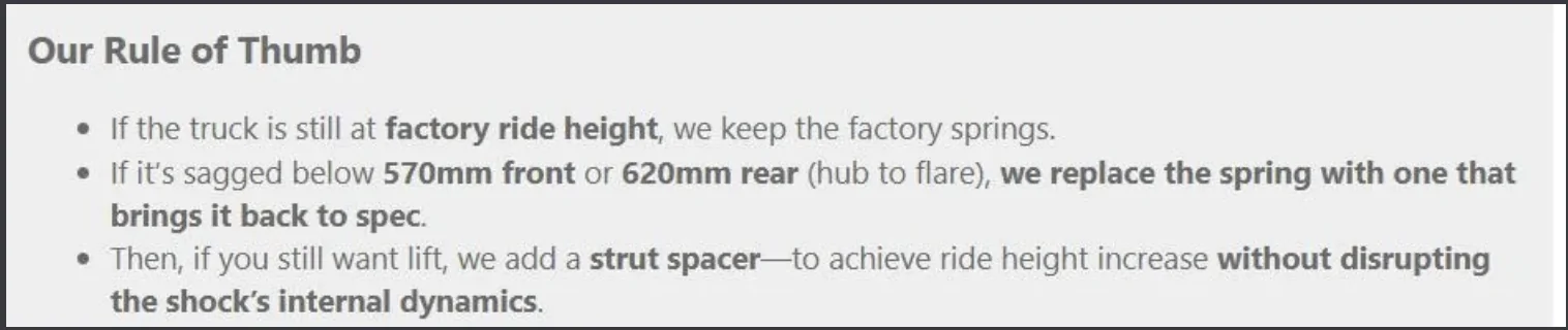

Our Rule of Thumb
  • If the truck is still at factory ride height, we keep the factory springs.
  • If it’s sagged below 570mm front or 620mm rear (hub to flare), we replace the spring with one that brings it back to spec.
  • Then, if you still want lift, we add a strut spacer—to achieve ride height increase without disrupting the shock’s internal dynamics.
This process keeps:
  • The piston in the right part of the stroke
  • Your bypass ports in the right part of the stroke
  • Your Live Valve (Next Gen) functioning properly
  • Tyre clearance predictable
  • And travel balance preserved

What is are the measurements fron center of hub to edge of fender flare in the front for a completely stock 2024 USA Ranger Raptor? Trying to determine what a bumper and winch did to the suspension height in the front and I forgot to measure before starting. Same question for the rear as well since I added a drawer and tools. Thanks in advance!
Front = 570mm centre of hub to bottom flare
Rear =620mm centre of hub to bottom of flare
To get a truly accurate measurement, you can hook the tape measure to the bottom lip of the wheel. Then measure your wheel diamater and subtract half the the wheel diamater from the initial measurement.

Thanks for the info on factory ride height. I come up with 535mm front and 552 rear. The front is lower due to a Rival bumper and Warn winch. The rear is lower due to an ARE shell and Decked drawer with tools. Priority is keeping original ride quality both on an off road. Thoughts?

Thanks for the info on factory ride height. I come up with 535mm front and 552 rear. The front is lower due to a Rival bumper an Warn winch. The rear is lower due to an ARE shell and Decked drawer with tools. Priority is keeping original ride quality both on an off road. Thoughts?
Springs to maintain ride height to extra load

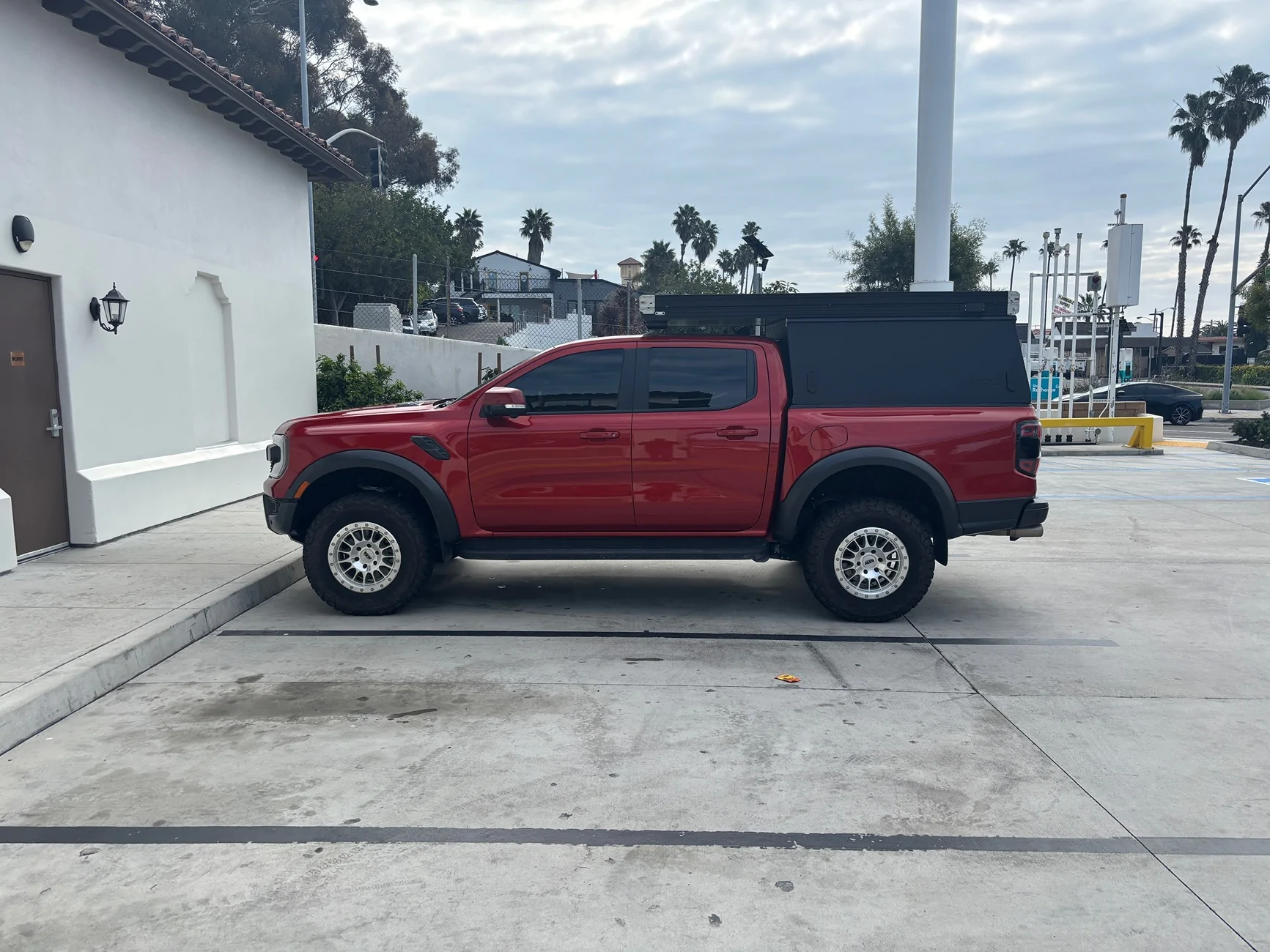

~330lbs of weight on the back of the truck.
Stock tire size. No front lift. Eibach Rear 500# springs only.
Rides absolutely perfect.
Look up @socalexpeditions on Instagram for a video.
How do you like your raptor with the gofast? Was thinking of getting one of those.
It legitimately drives like stock with the Eibach springs. I bet if I did a blind test with someone they would be very hard pressed to find which one has it. You’ll hear it at 70mph+ but it’s so so quiet that you’d buy the truck still cause the wind noise isn’t loud.
I wasn’t a big GFC fan till I got one and I’m really enjoying it.
