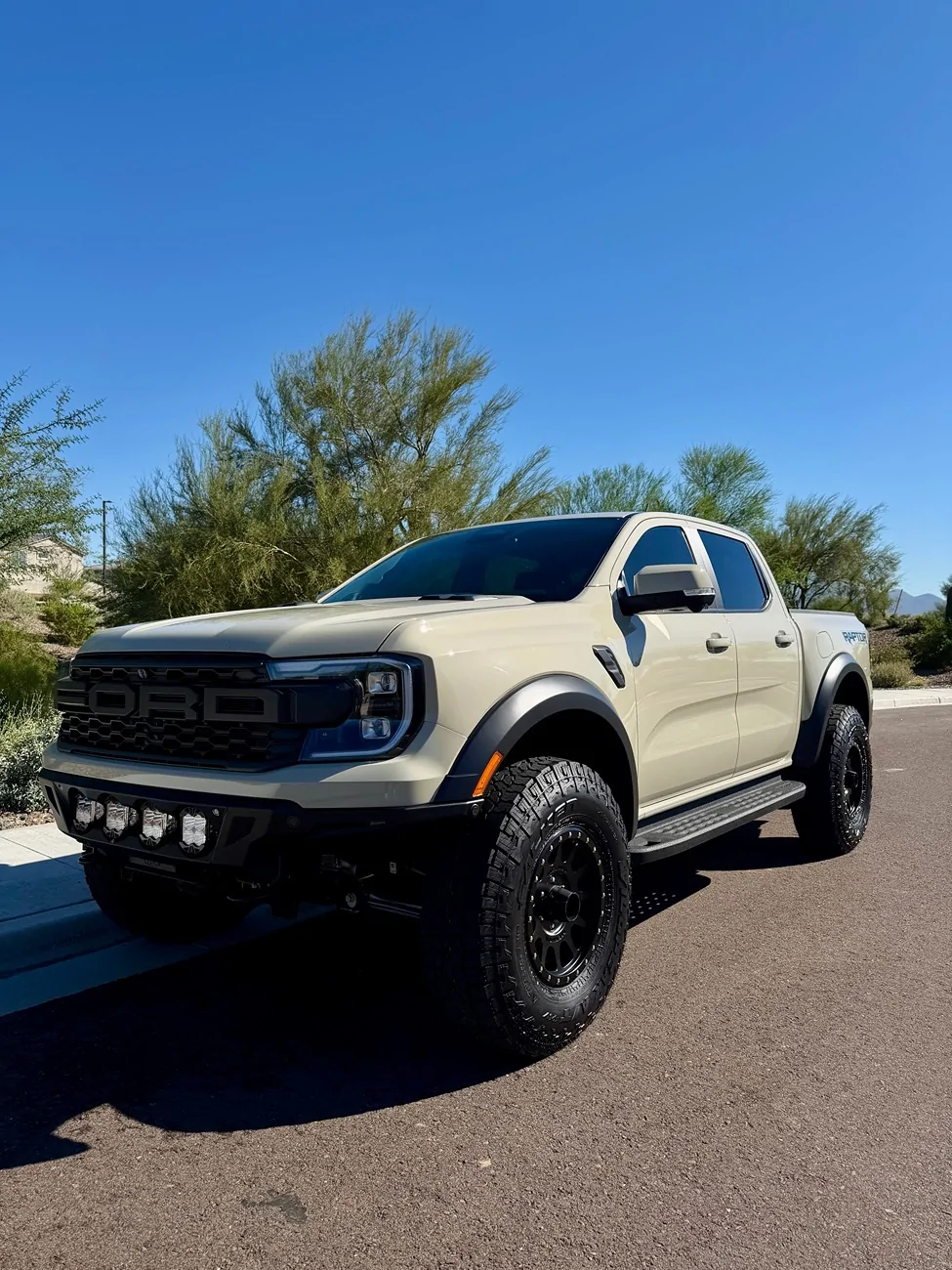

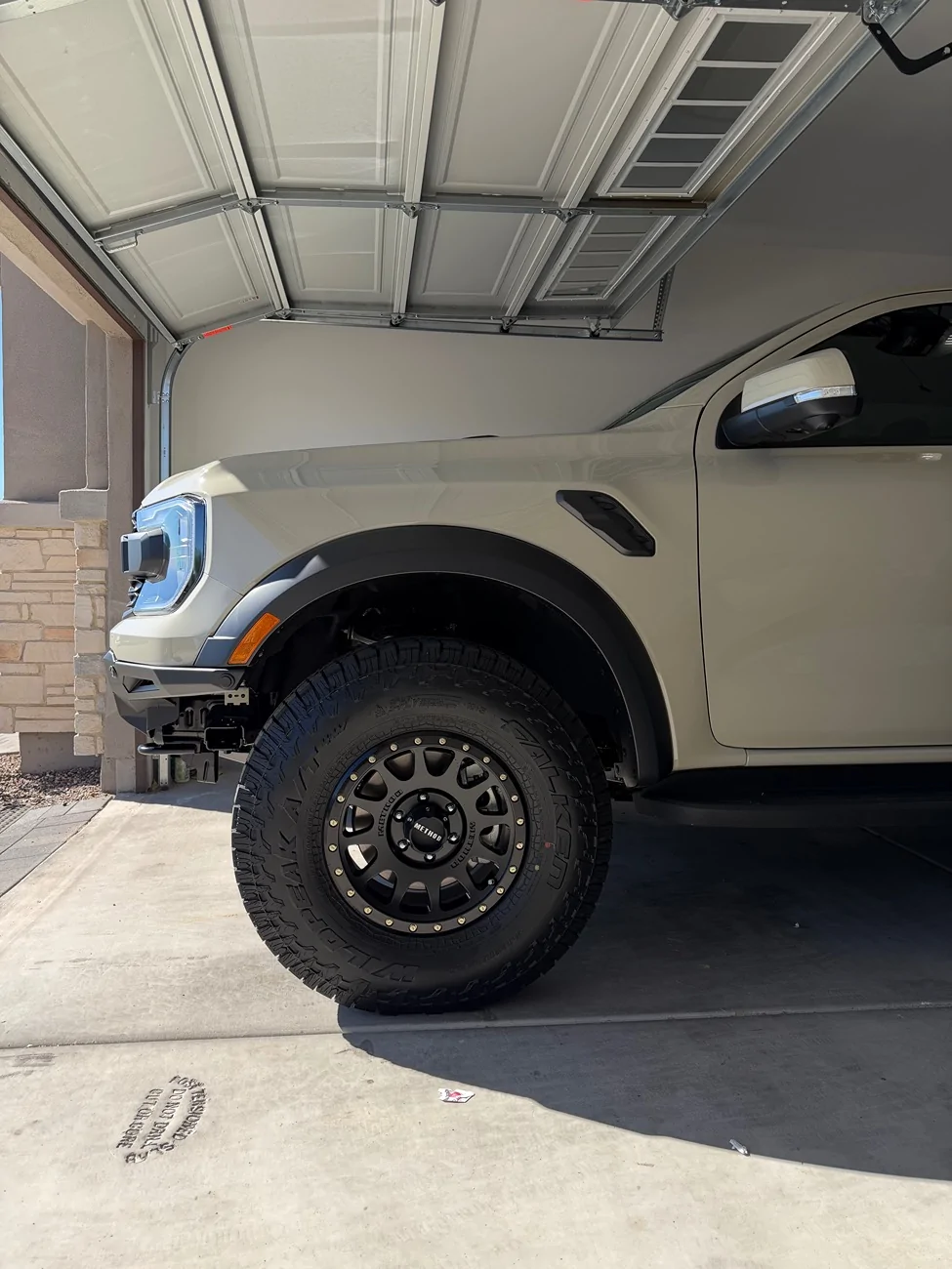

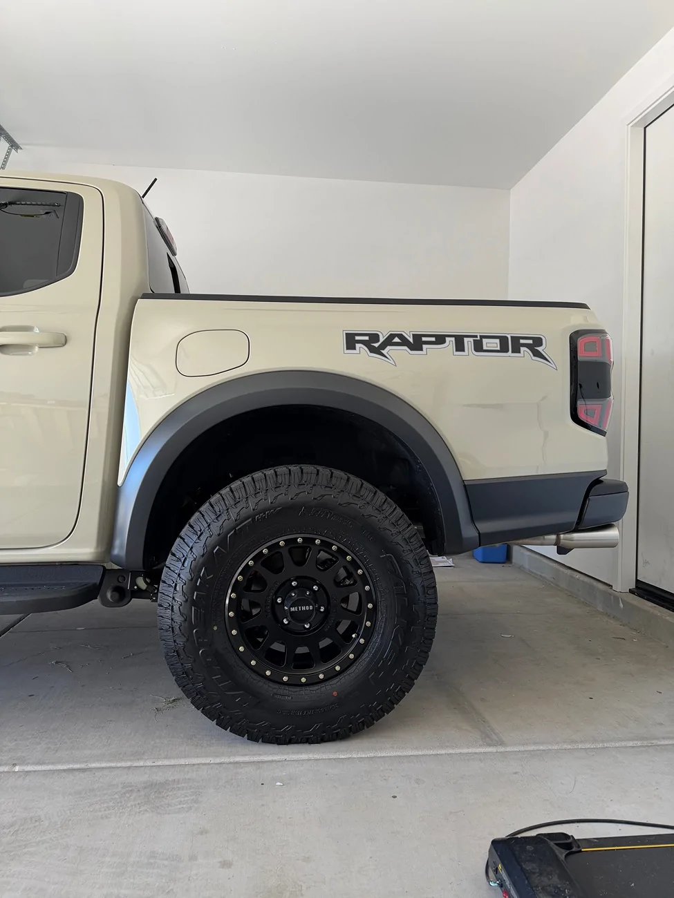

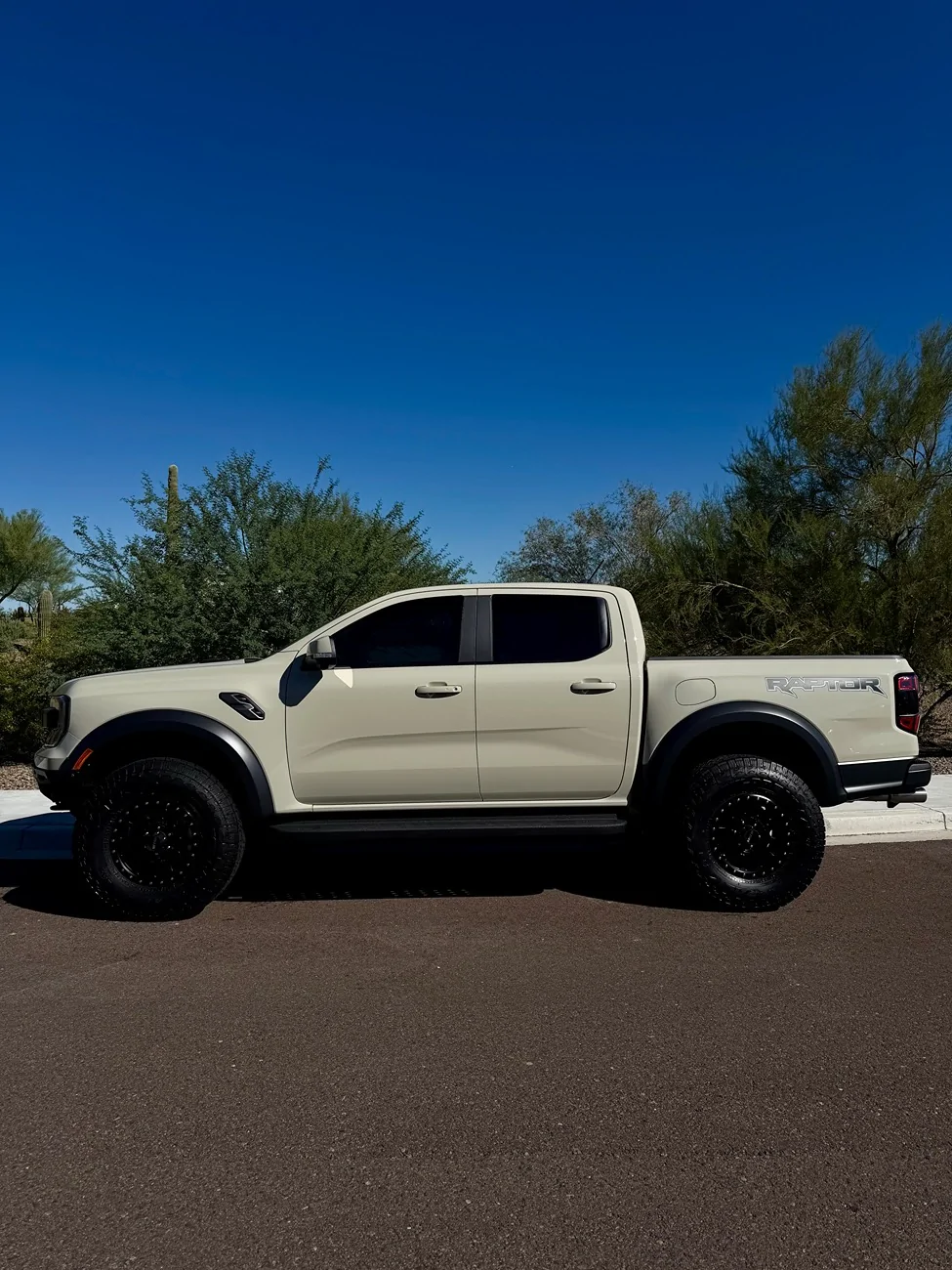

I also purchased the 2”/1” lift kit from @nedmo and it delivered all the way to Phoenix within a week.
Ned also recommended purchasing 35x11.5s
Very happy with the look and performance. Thanks!
Looks awesome man! 35x11.5 are look perfect!
