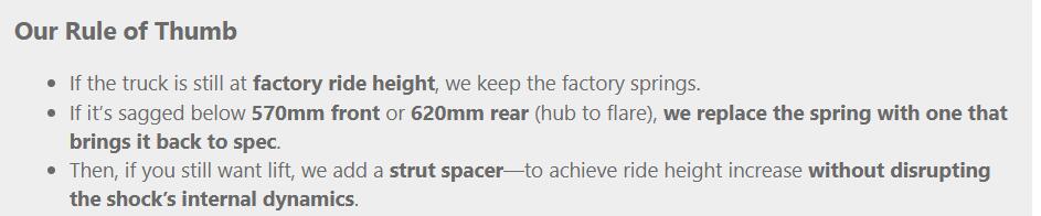

But regardless, we believe that offering generic "X Y Z combo, use this spring" advice is more unhelpful than helpful. There is so many different combinations of accessories that all have different weights. The proper way is to get your truck sitting with all of the constant weight, then measure sag and determine the appropriate spring rate to return to stock. That way, your getting as close to perfect for YOUR setup as possible.

@nedmo Do your spacer thickness to lift ratios hold true for both the front and rear or the Ranger Raptor?
"We made our own perch collars, made our own strut spacers in varying thicknesses from 1in lift all the way up to 3in lift. 3in lift was too much for the CVs and ball joints, so we only sell up to a 2in/32mm thick spacer.
1in lift = 16mm thick
1.5in lift = 24mm thick
2in lift = 32mm thick
3in lift = 40mm thick"
So does your 32mm spacer also raise the rear by 2"?

All spacers we sell are interchangeable front to rear and provide the same amount of lift on either end.
