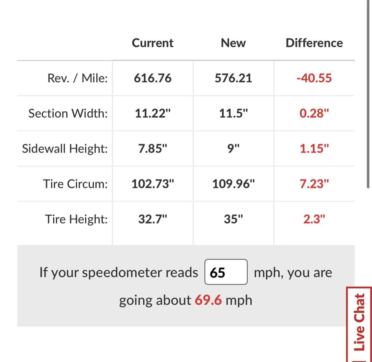

I think i've decided on the Falken at4w, just not sure which of the 3 sizes below to go with. Kinda want to stick with a C rated tire for comfort but maybe it's negligable? The 315 has the proper speed rating. Then maybe with the tight clearances the 35x11.5 would be a good choice?

I wanted to do the 315s but I can’t justify the 75lbs per tire. You will feel a huge difference with that weight change of nearly 20 pounds per tire.
I’ll most likely end up going with the Toyo open country at3s in the C range.

Wondering too if the 11.5 wide tire is the way to go over the 12.5?

So here’s the comparisons between stock and the 11.5. I think it depends on what size wheels you are going with and how you want it to look. I’m personally doing 17x7.5 with a +25 offset so the 11.5 is the way I will be going to get as flush as possible with a bigger sidewall and overall tire.
