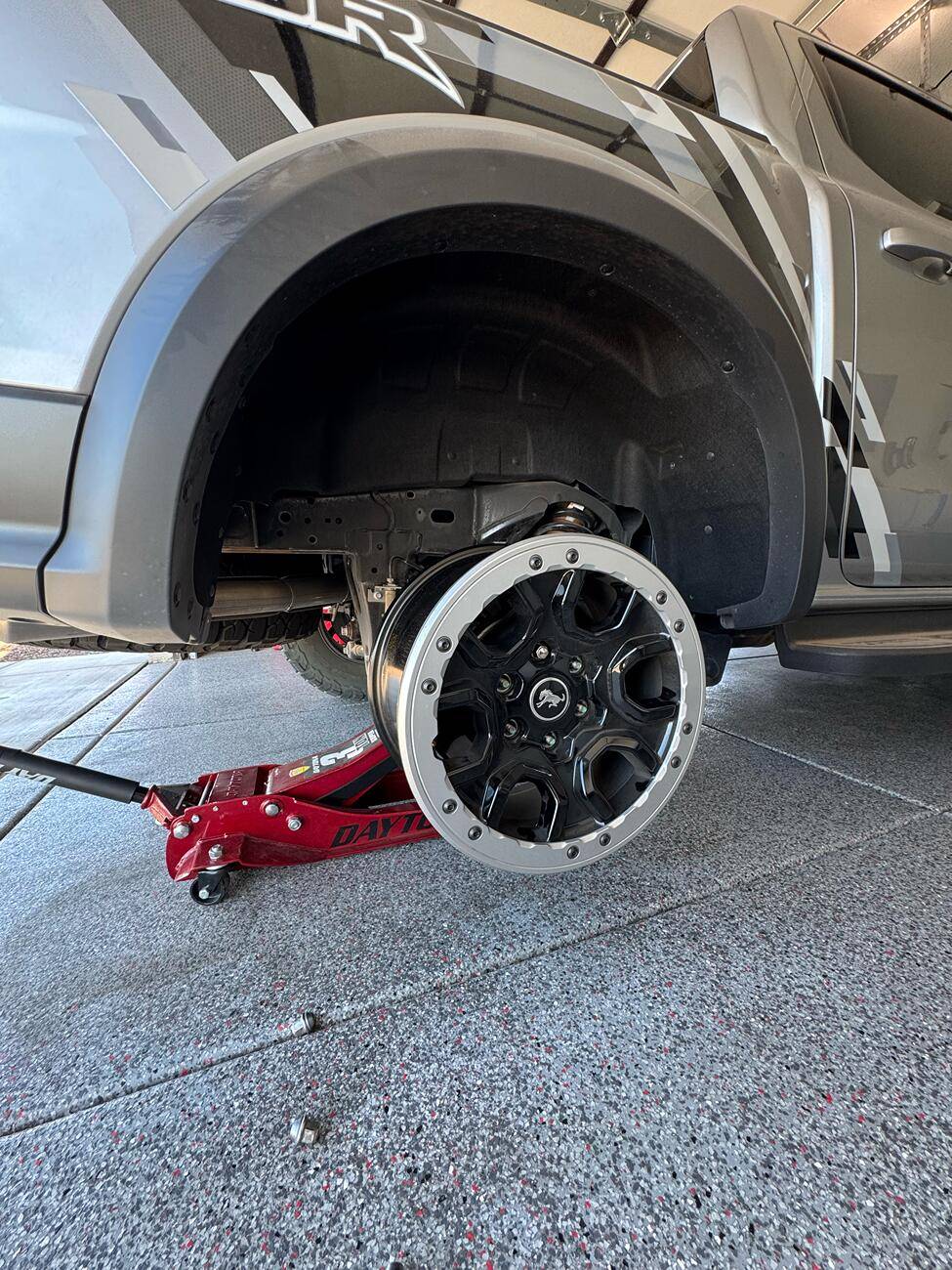

Yeah that's correct, stock is 17x8.5 +55. I actually scooped up a set of bronco SAS wheels @17x8.5 +30, but the cost in powder coating to get them to my liking, and the additional weight of those wheels swayed my opinion to go with the methods @ +35 offset. I'll gain about .8 inches away from the upper control arm with this setup so I think it'll clear the suspension components fine. Here are what the SAS wheels looked like.

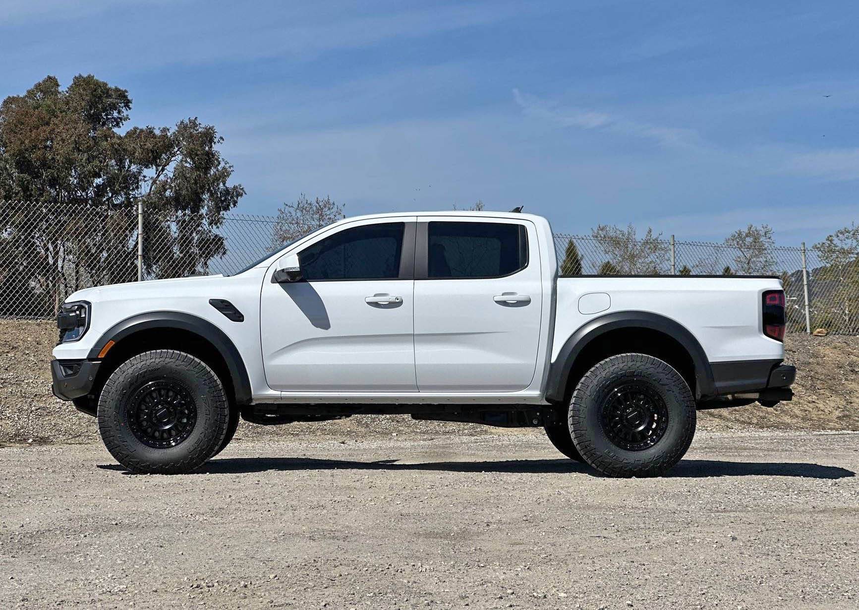

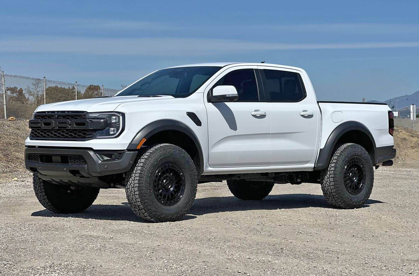

Ford Ranger FMI 2" Collars + Falken Wildpeak AT4 35/11.50/17 on 17x8.5 +25 offset KMC KM552 Wheels tempImageEpkViA
Ford Ranger FMI 2" Collars + Falken Wildpeak AT4 35/11.50/17 on 17x8.5 +25 offset KMC KM552 Wheels tempImageUT7yZ1
