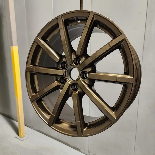

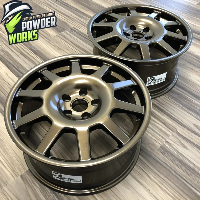

Any downside to powder coating the OEM non-beadlock rims? I think bronze would complement the Shelter Green Ranger Raptors. Something like the Prismatic Powders Bronze Chrome.

I have done it on a few vehicles over the years. Never been a problem that I am aware of.
I never had any issue with it.
Just takes a week or so if your local powder coating shop is quick with their turnaround times.
Meaning the biggest challenge for some is not having a second set of wheels and tires to put on the truck while they get the OEM set powder coated.
Ballpark cost with dismounting, powder coating and remounting and balancing.
Your looking at around a $600-1000.00, cost can vary a bit since there is quite a few options when it comes to powder coating.

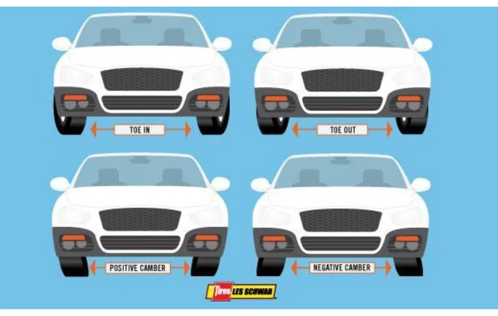

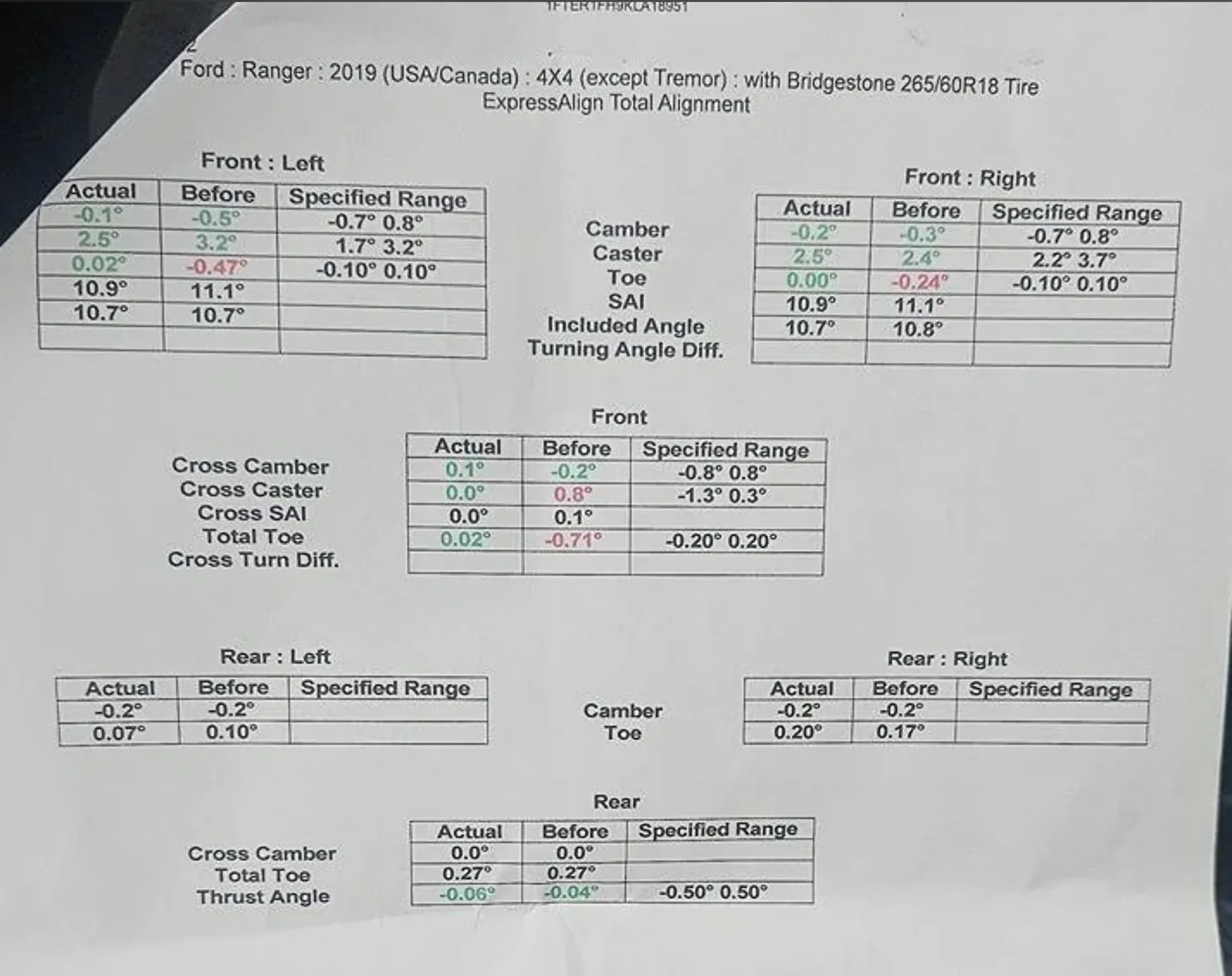

I think it would not hurt to have it checked.
Changing the offset will change or exaggerate the factory alignment specs.
I could not find a spec sheet showing the specified ranges, but this will maybe help illustrate what I am trying to say here.
Found this over on the 5G Ranger forum .
The added offset won’t effect caster but will effect camber and toe all be it very slightly.
Ford Ranger New wheels for the new truck: 17" Method 709 wheels +25 offset 1767545947429-z1
Ford Ranger New wheels for the new truck: 17" Method 709 wheels +25 offset 1767546200436-8t
Pushing the wheels out 20mm with +35 offset wheels will exaggerate whatever setup is on the truck from the factory with +55 offset.
Is it enough to take it out of spec range, is what is really hard to say or know without checking it on an alignment rack.

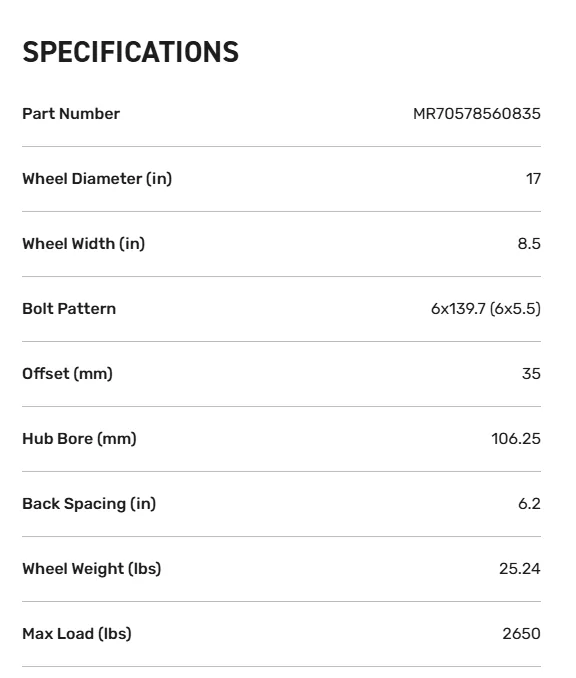

705's were the lightest bead grip I could find in +35mm offset and bead grip is a requirement of mine for the dunes to maximize flotation (and be street legal / low maintenance), so I can push some speed in corners without de-beading. Nice to have for dirt as well as you can probably push a bit lower pressure than 30 without de-beading. I like the added reliability. Now if only it was Jan 17th so they would ship!
705 | Titanium – MR70578560835 – Method Race Wheels
Ford Ranger New wheels for the new truck: 17" Method 709 wheels +25 offset 1767710323110-ng
I ordered my 705's from Tire Rack (got 5x, so the spare has the same off-set), includes the lugs and hub centric rings.
