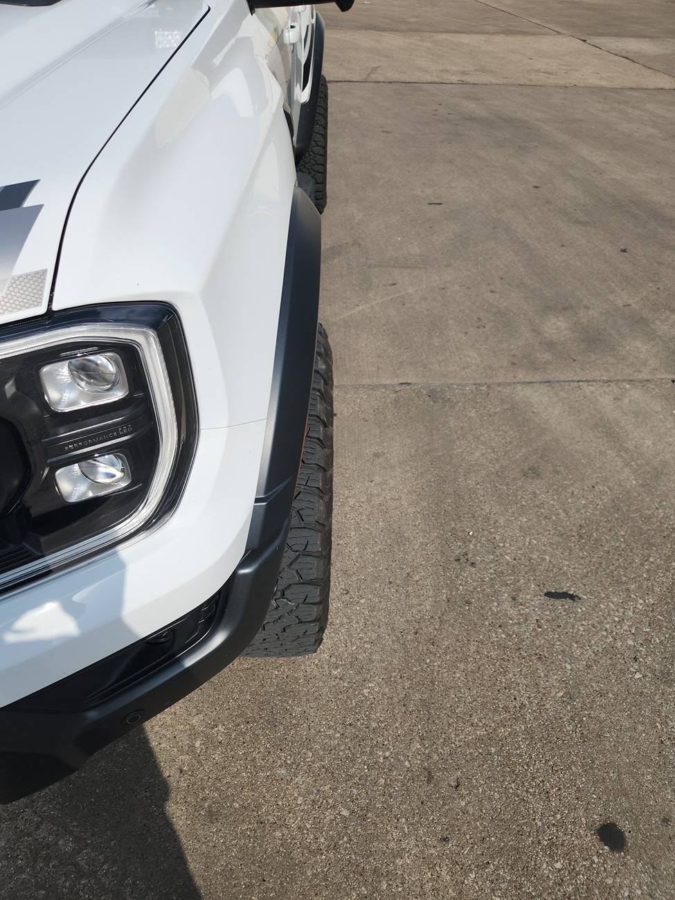

I couldn't say for sure, I would be surprised if that rubbed at all, but I have not done enough of a variety of setups on these trucks yet to say yes or no with confidence. If you are going to that offset I would just come to terms with removing the front crash bars so you aren't surprised if you need to. It does not require any cutting, just unbolt and slide them out, they can always be reinstalled down the line very easily.
Heres a pic of his setup, it kicks the tire out a decent amount compared to stock which is why I would say you may need to remove the crash bars even though you aren't going for much larger tires.
