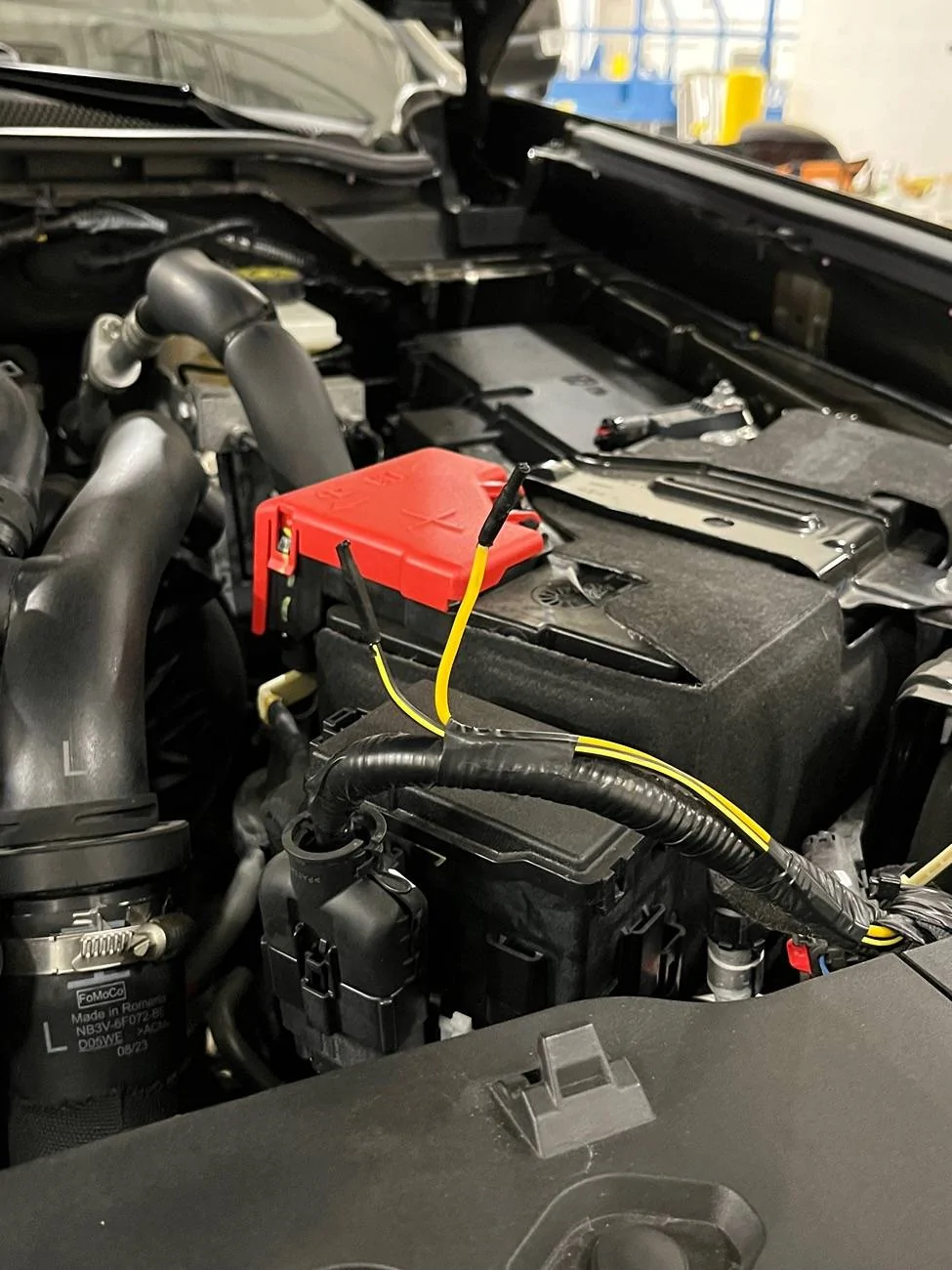

Can someone please tell me what these wires are for? Thanks!
Mgrmax Well-Known Member First Name Mike Joined Aug 13, 2024 Threads 3 Messages 112 Reaction score 76 Location Detroit Vehicle(s) 2024 Ranger Raptor Dec 2, 2024 Thread starter #1 Can someone please tell me what these wires are for? Thanks! Sponsored
CACTUSGREYFX4 Well-Known Member First Name Pat Joined Jun 13, 2023 Threads 7 Messages 1,858 Reaction score 1,714 Location ON, Canada Vehicle(s) 2024 Ford Ranger Lariat FX4 Occupation Fire Dept Dispatcher Dec 2, 2024 #2 Something aftermarket can you trace them to the end.
stuartmunto Well-Known Member First Name Stuart Joined Aug 25, 2024 Threads 21 Messages 572 Reaction score 956 Location Perth, Western Australia Vehicle(s) 2023 Ford Ranger Raptor Occupation Engineer Dec 2, 2024 #3 Those ones are connected to AUX switch #6 on the overhead panel
OP OP Mgrmax Well-Known Member First Name Mike Joined Aug 13, 2024 Threads 3 Messages 112 Reaction score 76 Location Detroit Vehicle(s) 2024 Ranger Raptor Dec 2, 2024 Thread starter #4 stuartmunto said: Those ones are connected to AUX switch #6 on the overhead panel Click to expand... So they are both hot? Thanks!!

stuartmunto Well-Known Member First Name Stuart Joined Aug 25, 2024 Threads 21 Messages 572 Reaction score 956 Location Perth, Western Australia Vehicle(s) 2023 Ford Ranger Raptor Occupation Engineer Dec 2, 2024 #5 Mgrmax said: So they are both hot? Thanks!! Click to expand... No - solid yellow is hot, the black stripe is ground

Akin47 New Member First Name akin Joined Nov 26, 2024 Threads 0 Messages 2 Reaction score 0 Location Ranger4747 Vehicle(s) 2024 Ranger Raptor Occupation Pipefitter Dec 3, 2024 #7 Believe the yellow is 25 amp. There is another set right behind that for AUX #1 and #5
GLW Well-Known Member First Name Gary Joined May 26, 2024 Threads 26 Messages 480 Reaction score 538 Location Missouri Vehicle(s) 2024 Ranger Raptor Dec 3, 2024 #8 Mgrmax said: Can someone please tell me what these wires are for? Thanks! Click to expand... https://www.fordservicecontent.com/..._Owners_Manual_version_1_om_EN-US.pdf#page533
