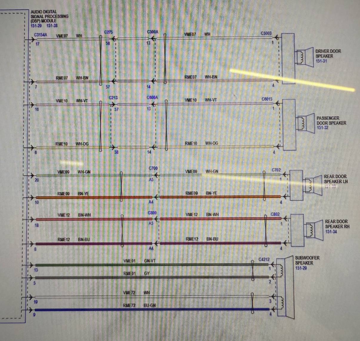

Did multiple searches here and didn't see it listed.
I plan to install the kicker key 200.4 amp and lose the B&O amp. Can anyone tell me what each speaker wire colors are for this system from the amp behind the backseat to each speaker?
I plan on swapping this out soon. I've watched (and subscribed to) flaberdoopin's YouTube channel but he talks so fast and yacks alot, I would need a stenographer to write it all down and draw a diagram lol. He goes on to say that the wires on all 4 doors of his 24 RR change speaker wire color when it goes from the main harness thru the door to each speaker and changed again at the amp. It's a shame no one makes a plug and play adapter that goes from oem to the new amp, that would save me alot of Tylenol!
My truck is being built monday, it's a 2025 RR. I Googled the diagram but it didn't pop up.
Thanks in advance!

From the diagram above, it appears that the B&O Amplifier does not have separate channels for the A-pillar tweeters. Do they just connect through the door speaker harness somehow?
RCMUSTANG
Ray
Jan 22, 2019
1,539
573
Los Angeles
1989 Mustang 2017 Fusion
They're run directly off the radio.
