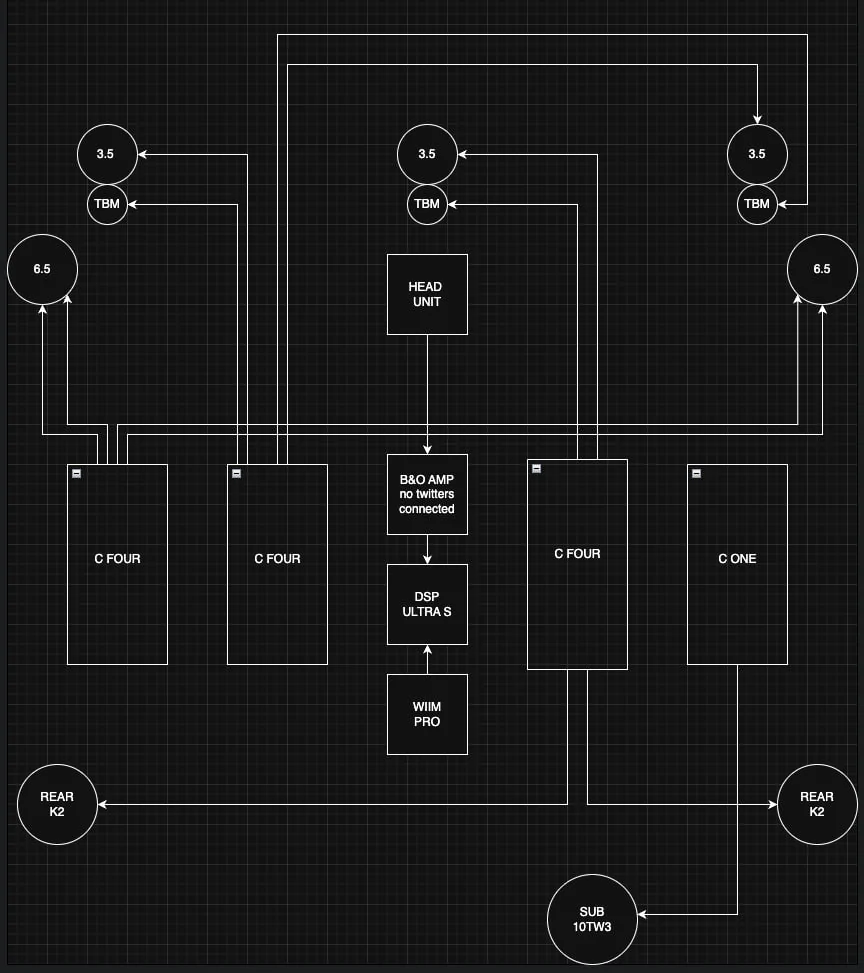

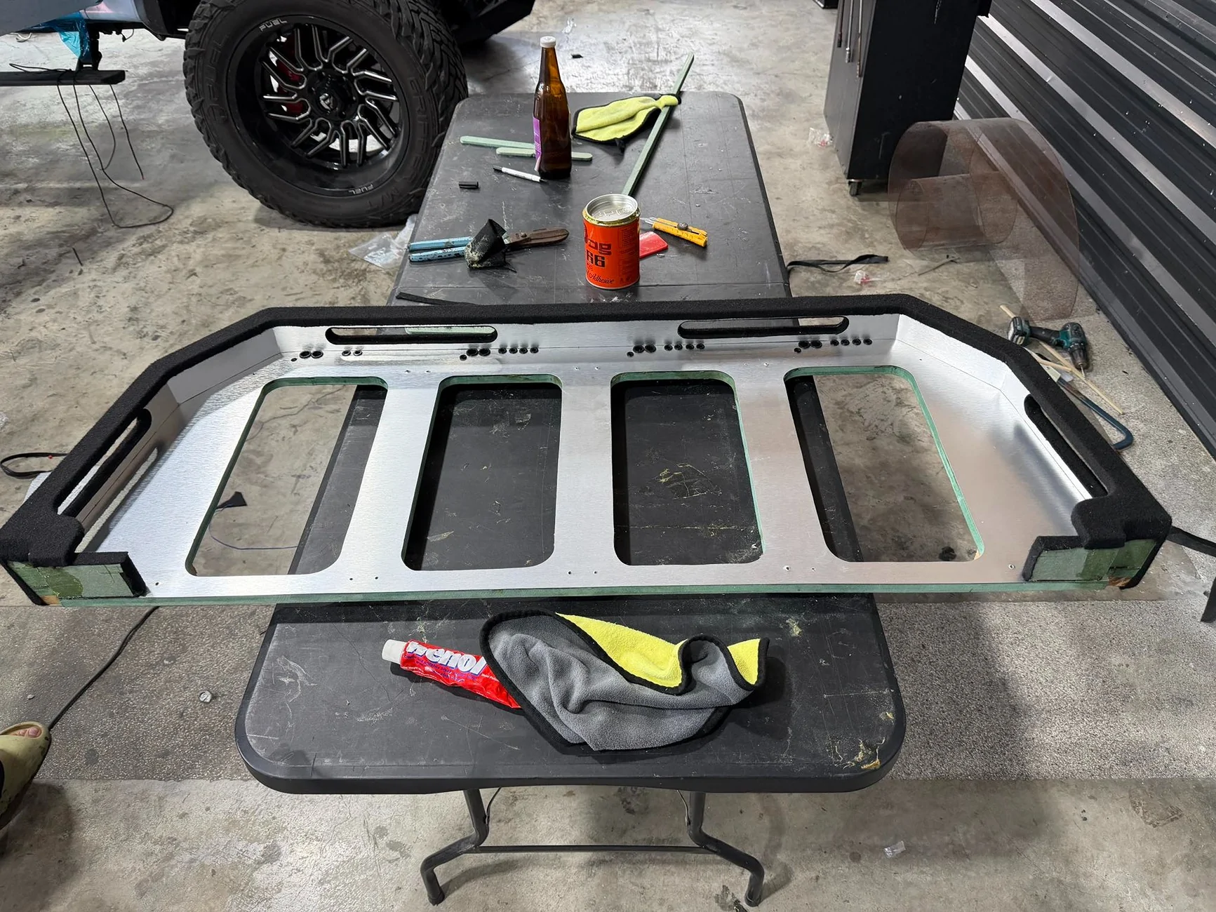

Hello, im owner ranger raptor 2022, v6 ecoboost
I'm going to seriously change the music system,
My setup
Front
https://media.focal-naim.com/dam/tbm/fp_tbm_en.pdf 3 pcs
https://media.focal-naim.com/dam/3-5-wm/fp_3-5wm_en.pdf 3pcs
https://media.focal-naim.com/dam/6-wm/fp_6wm_gb.pdf 2pcs
Rear
https://media.focal-naim.com/dam/ec-165-ke/fp_ec_165_ke_en.pdf 2pcs

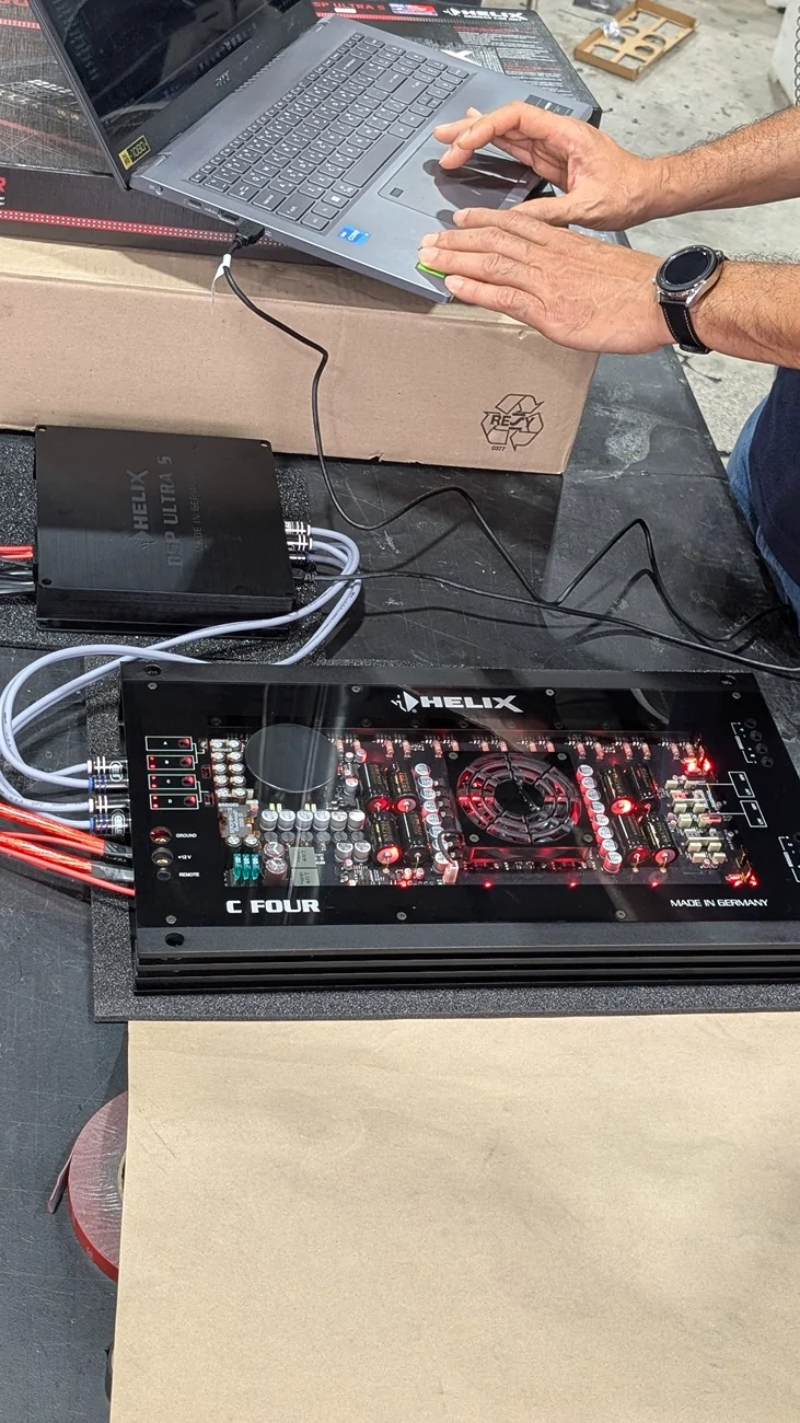

Speaker amp
https://www.audiotec-fischer.de/en/helix/amplifiers/c-four 3pcs
DSP
https://www.audiotec-fischer.de/en/helix/processors/dsp-ultra-s
Subwoofer amp
https://www.audiotec-fischer.de/en/helix/amplifiers/c-one
Subwoofer
https://www.garmin.com/en-US/p/1667337/
10", 4 ohm

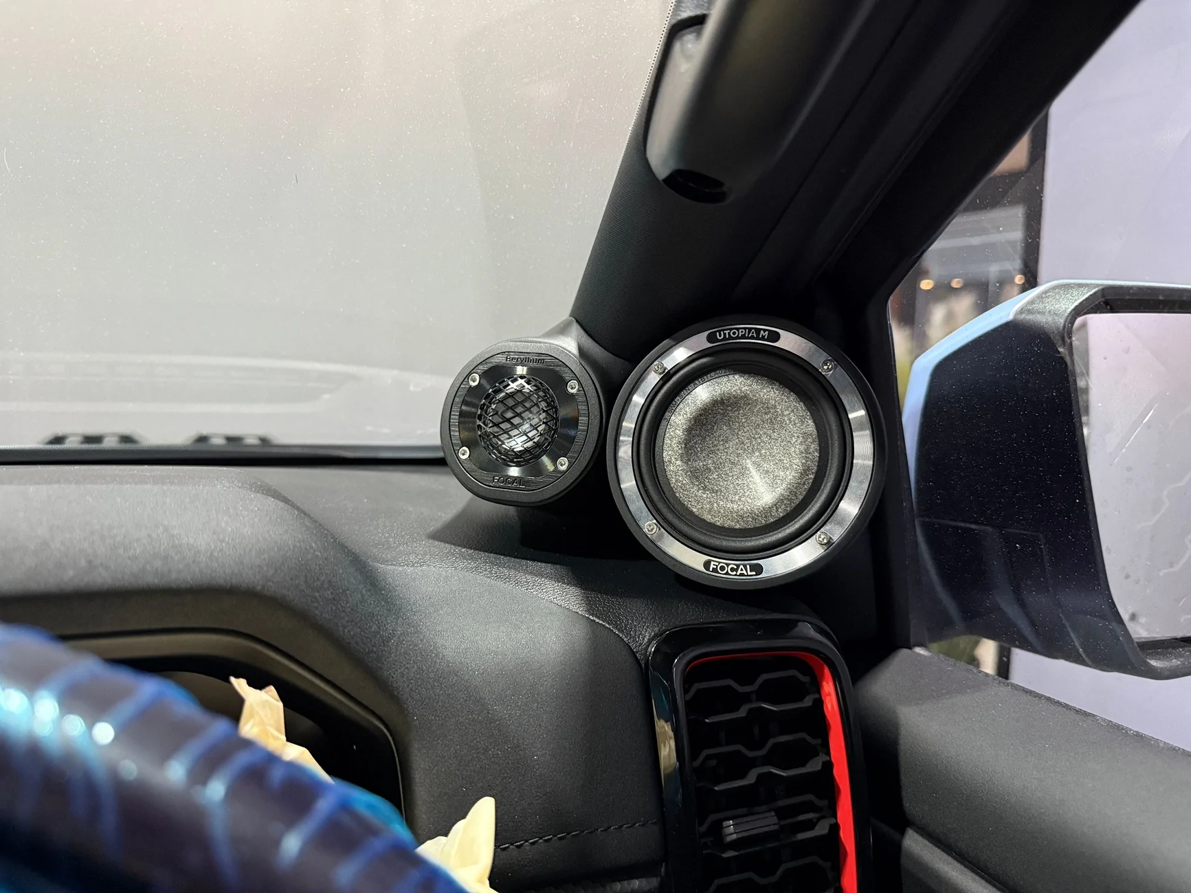

the main problem is the noise from the twitters, when the signal is missing, after many tests, they concluded that the original amplifier is noisy, when using the signal directly from the usb, absolute silence
that is, just when the car door is opened, there is already a noise, without ignition
how to remove standard amplifier, saving all system sounds
Thanks in advance🙏🙏🙏

The problem with removing the stock amp is that it is part of the can bus system and without it you will throw a fault. One reason I went with the Mobridge amplifier/dsp.
The stock amp uses the front speakers for warning chimes and without feedback from the speakers it will be unhappy.
https://mobridge.us/product/ford-ranger-amplifier-plug-and-play-a2b/

So, after many tests found the exact reason of the noise, that hu
We try other ground ways and points
Any way for power
Soldered high levels bypass to hu chip
if just turn off hu, no noise
there is even noise when the standard amplifier is not connected
Noise only from tweeters
Tried other twitter models, have noise
Has anyone encountered the same problem?
