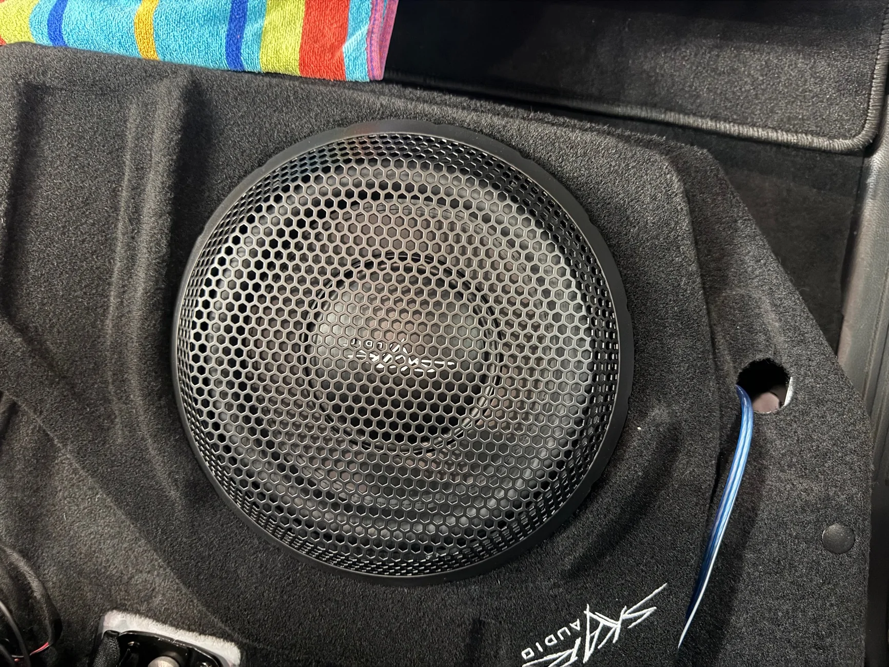

Skar sub with the cover fits fine.
Im driving mine with a Skar 800.1 amp,and hits harder than I was expecting.
Not disappointed at all with this simple setup
