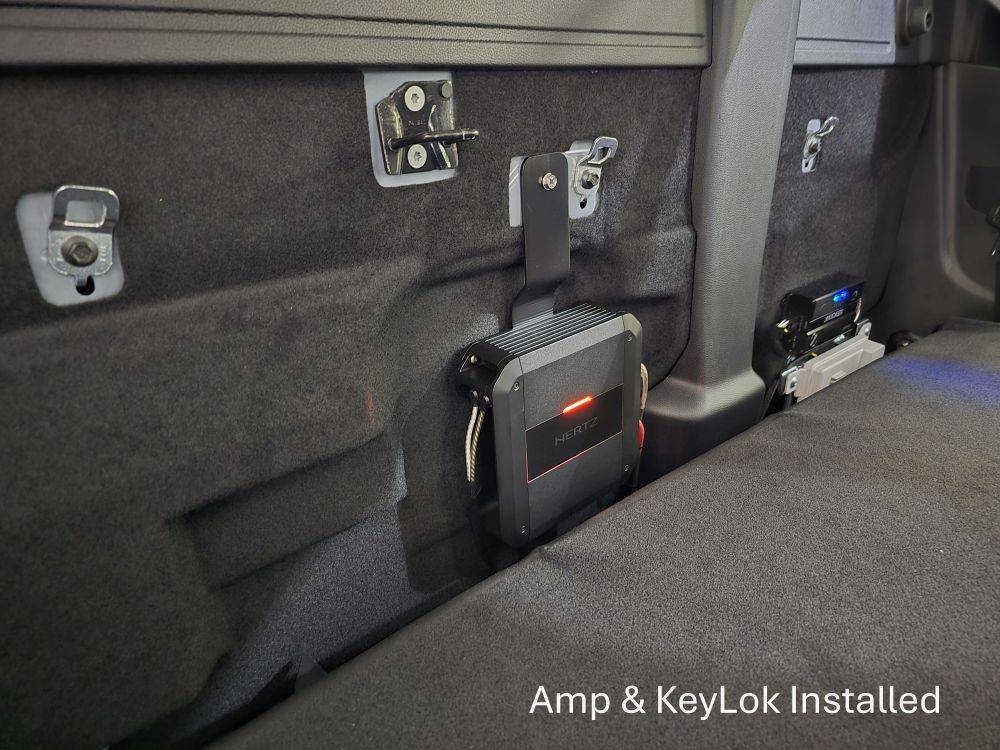

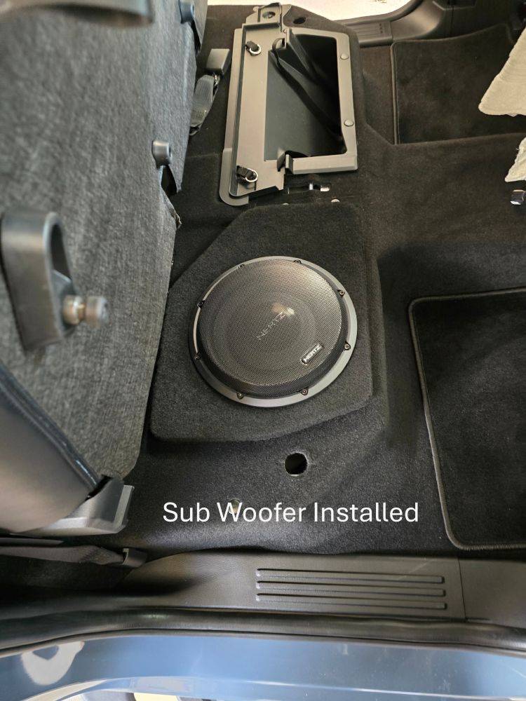

First off, I have to thank nate.co and his excellent thread Mega audio upgrade -- sound deadening, speakers, stealthbox sub, GMRS radio for guidance. The information was invaluable and a major time saver.
I went with the following components:
Hertz MPS 250 S2 shallow subwoofer
Hertz DIECI POWER DP 1.500 Mono Class-D Amplifier
Stealthtech Sub Enclosure
Kicker Keylok & Harness
I used 6061 T6 Aluminum 2'' x 1/8'' Flat Bar for the mounting brackets.
Tools used to fabricate the brackets:
-hack-saw
-assorted hand files
-1/2" disk sander
-6" bench vise
The factory sub is a 5 1/2" driver in a tuned wave enclosure. It operates in a very narrow frequency range. It sounds hideous and does more harm than good if you leave it connected.
My advice to anyone contemplating a similar upgrade is to shit can it and utilize the space to mount your amp.
I too had to reduce the gain on the KeyLok as it is pre-set way too high.
Overall I'm very happy with the outcome. I didn't bother upgrading the rest of the speakers. They sound pretty good once you remove the factory sub and add a real one.
Here are some images of what I concocted for bracketry and the end results:
-hack-saw
-1/2" disk sander
-6" bench vise

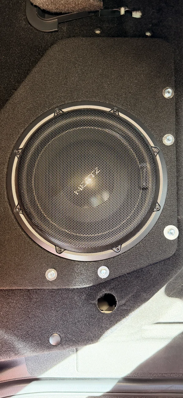

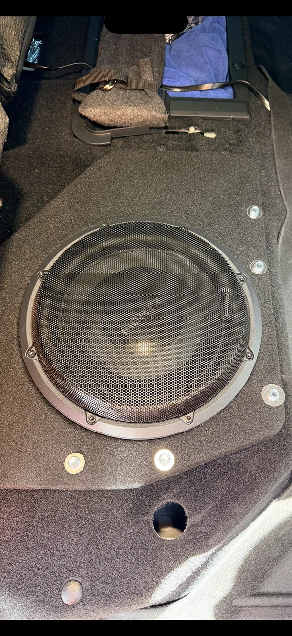

How did you mount mount the sub to the box? Did you put screw inserts or just screwed right into the box?
Buellsox
Scott
Oct 22, 2025
289
439
Tacoma, WA
Local 26 Union Plumber
For my install I screwed the sub directly into the meat of the sub box itself. No nut-zerts or inserts were needed for the Hertz 10” in the StealthTech box. Just don’t over tighten or go full ham with an impact or screw gun.
I also tek screwed into the sheet metal flange at the front of the box as the box itself would rattle around in the tub with the Hertz 10” being pushed by a Rockford Fosgate Punch 300.1. It frigging pounds! I also sound deadened the tub before the box dropped in.
Hope this helps!

#10 tek screws ?
How long?
Still have not fixed my sub into my truck (have the exact Hertz + Stealthtech setup)
5 screws and that's it ? Good enough !?

#10 tek screws ?
How long?
#10’s or 12’s. Can’t quite remember, but I do remember they were the bigger 3/8” head versus the regular smaller 5/16”. I predrilled and used 2” long Tek’s. The area I have them located is the only area where the flange has open tub underneath.
DON’T continue around to the rear or side towards the center of the truck or you’ll drill through the under side of the truck. That’s the curved/rolled area at the back of the tub. I crawled under the truck before doing any drilling and that rolled hump is direct sheet metal to the underside exterior of the truck with no void space to land those screws.
Yes! Those Tek’s settled my box down from rattling around in the tub.
