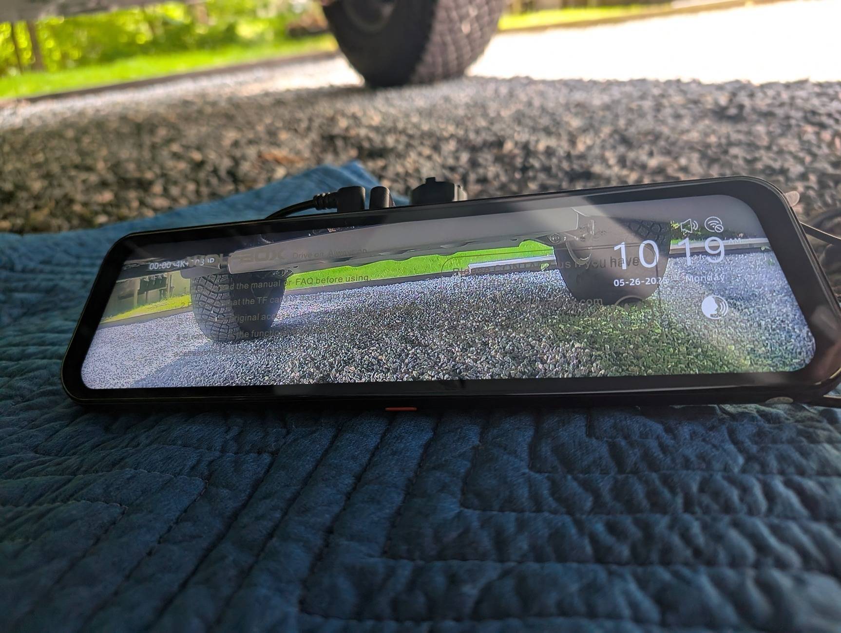

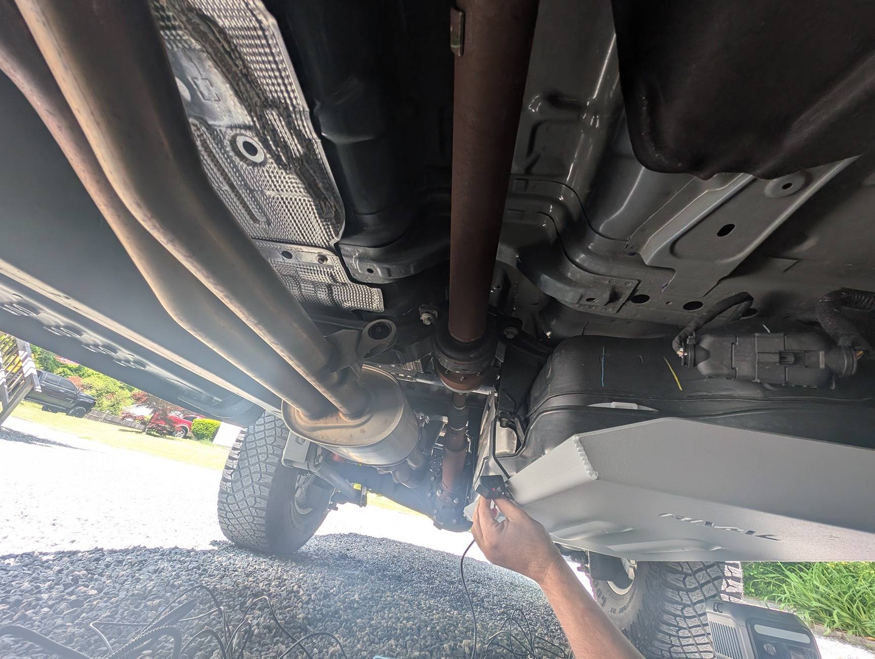

Started working on it this week! Still a a long way to go, weather hasn't cooperated this week for me.
Ford Ranger Wolfbox pro 3 channel install question PXL_20250526_151956437
Ford Ranger Wolfbox pro 3 channel install question PXL_20250526_151913049
Looking to bend up a bracket to mount it along side my gas tank Skidplate. Seems like it will be a decent shot

That looks like a very good placement for a good shot to see clearance up front!

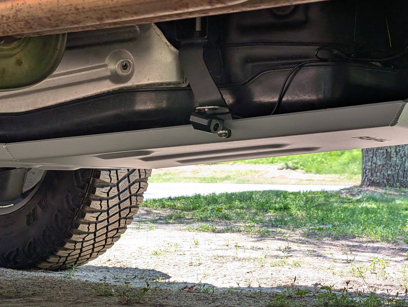

Got it all mounted up. Pretty happy with how it came out

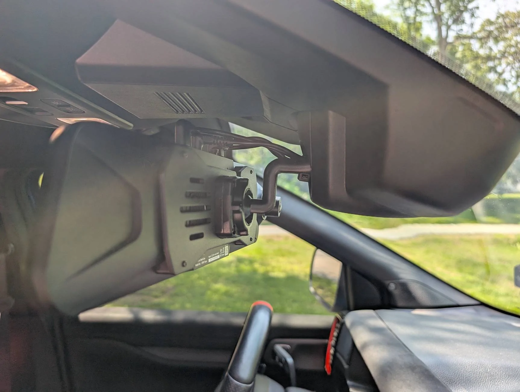

I replaced the factory mirror completely, used a bracket from eBay and a metal plate from AliExpress as well as the Wolfbox hardwire kit. It's getting powered from a fuse block I have installed behind the rear seat however you can use a fuse tap on the interior fuse panel. I used the factory run/start wire that's left behind under the dash for the accessory trigger. Wiring for power and cameras runs across the headliner and down the A-Pillar. Power terminates near the fuse box, cameras continue along under the trim past the doors to the back seat. The rear camera goes back up the C-Pillar and across the headliner to the camera, the extra camera wiring goes out the factory grommet behind the rear seat and connects near the front of the gas tank.

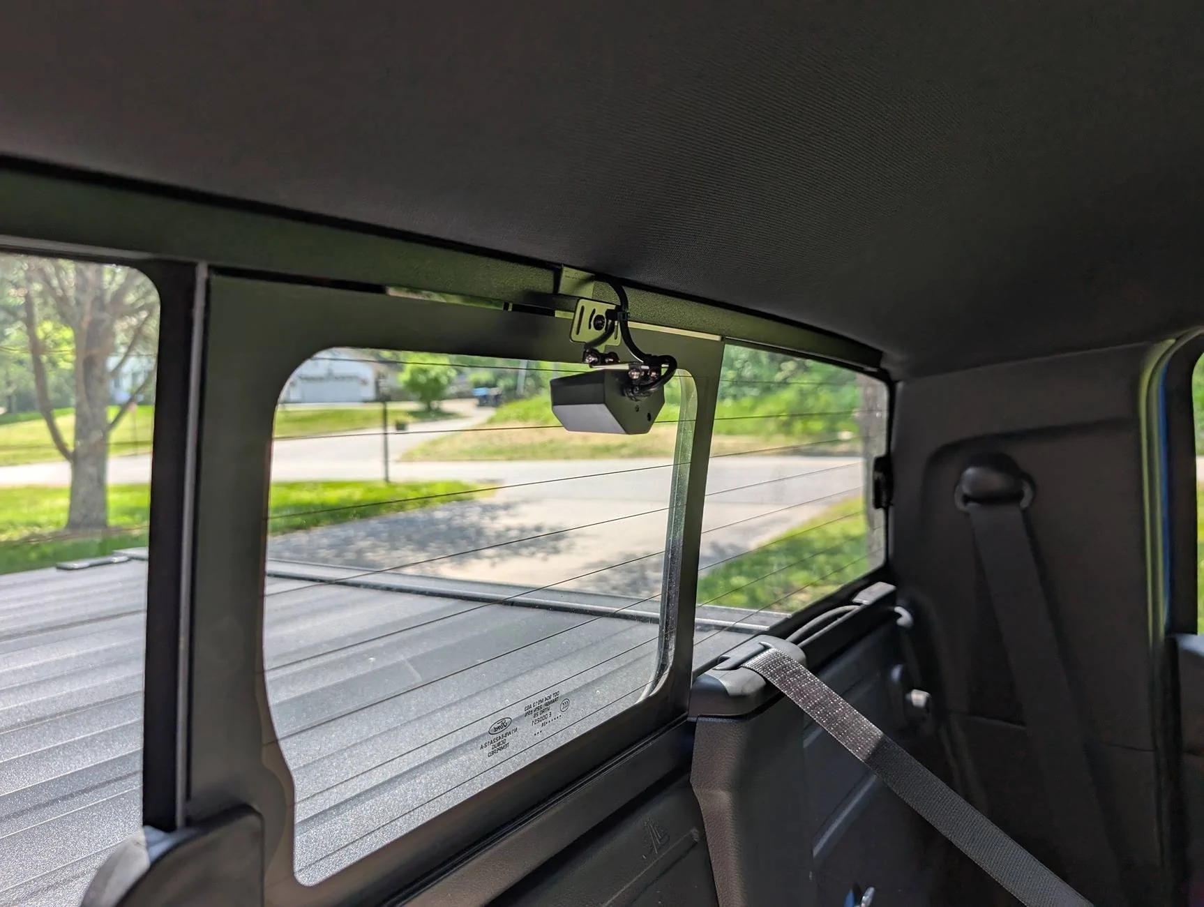

Rear camera is mounted inside using a bracket from TheDashcamStore.

The extra camera on a bracket I bent up and sandwiched between the Rival gas tank skid plate and it's mount.

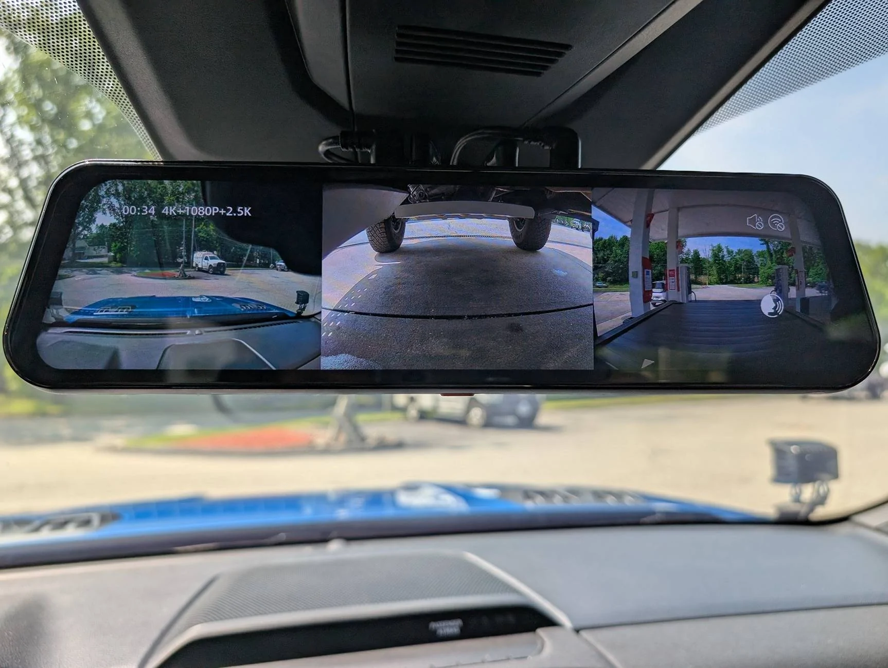

Great idea that you mount the bumper cam under your car. Can you please tell me why you choose that place?
mtesni
May 15, 2023
65
144
CT
24 Ranger Raptor, 23 Bronco Badlands
Since the truck already has a front camera from the factory I figured adding the camera underneath would be more useful spotting rocks while off-roading. If you ever come out with a 4 camera option it would be cool to have both forward and rear facing views like the Colorado ZR2 can have from the factory
