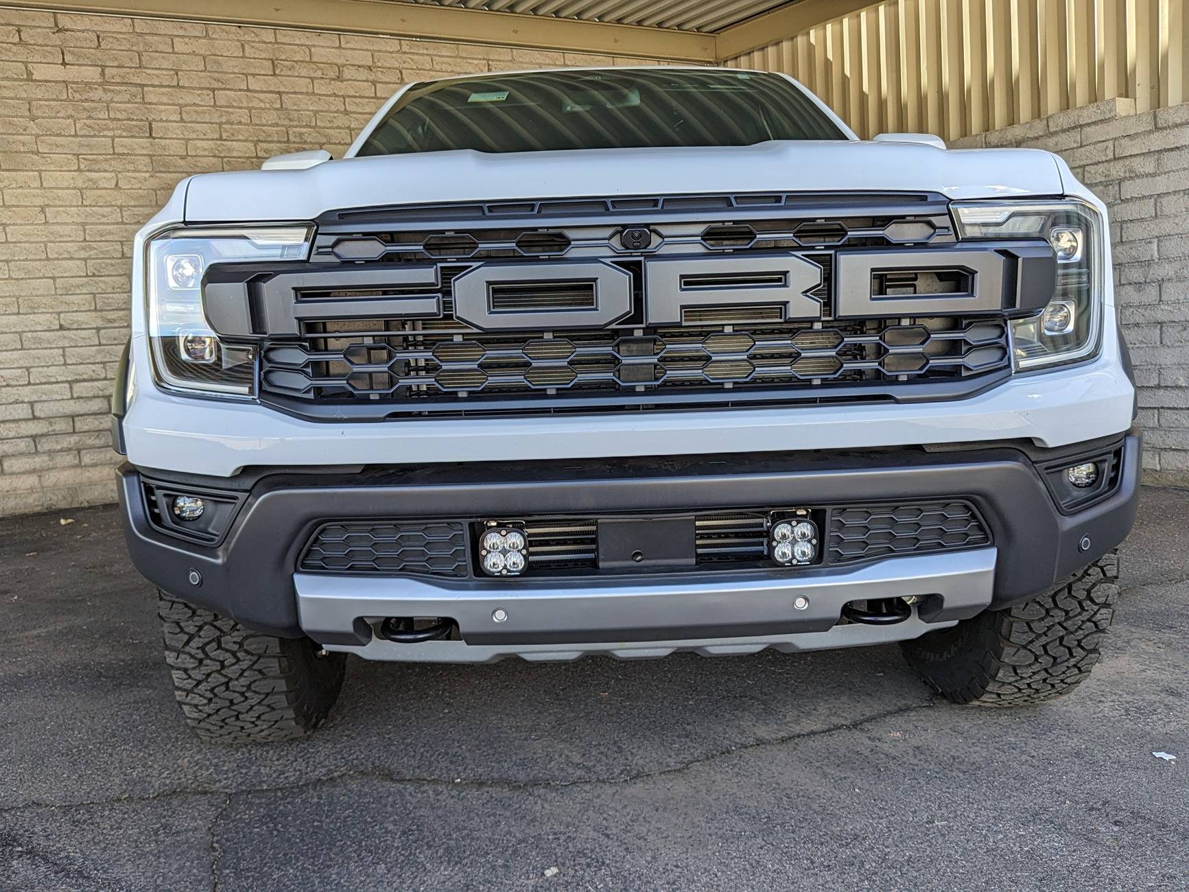

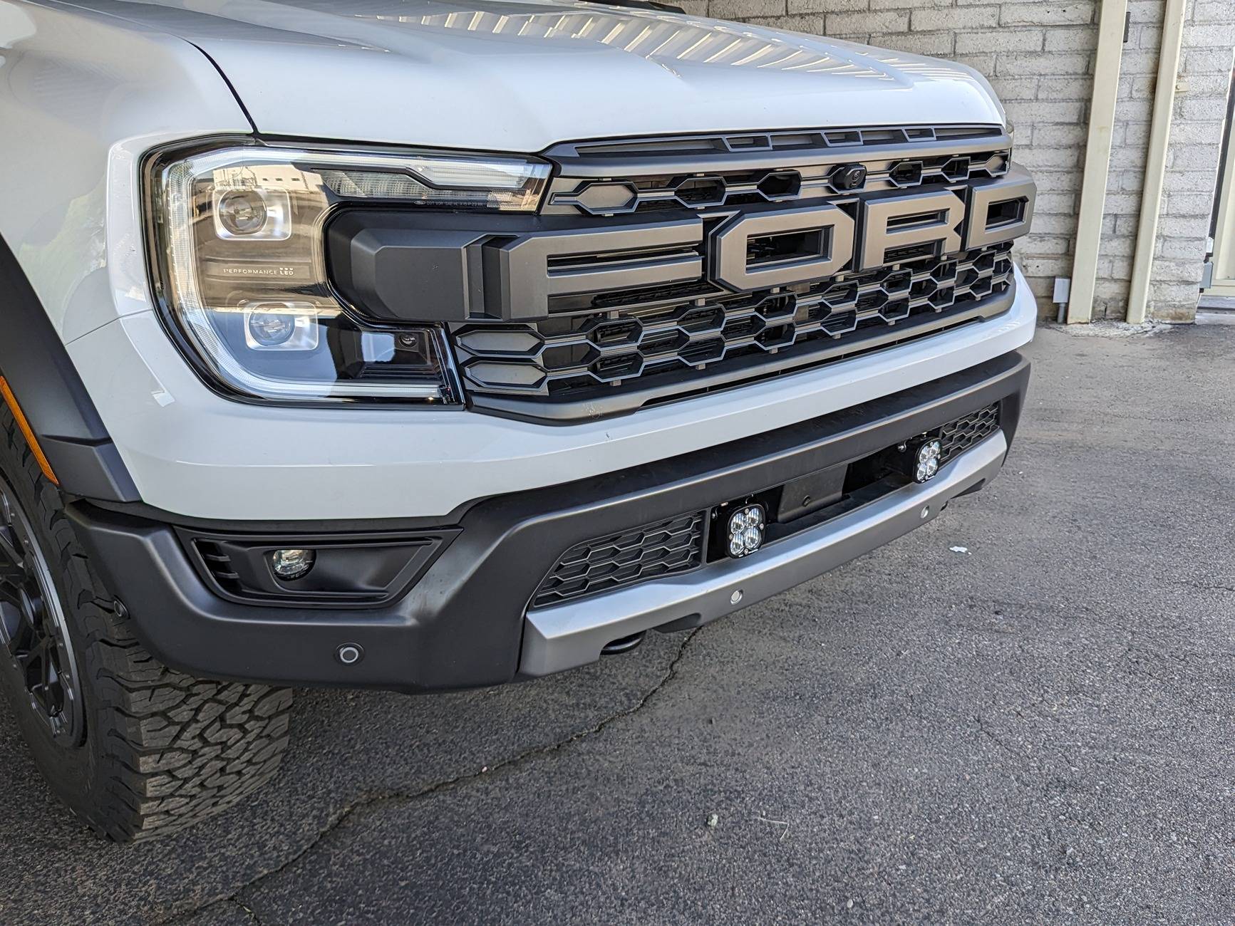

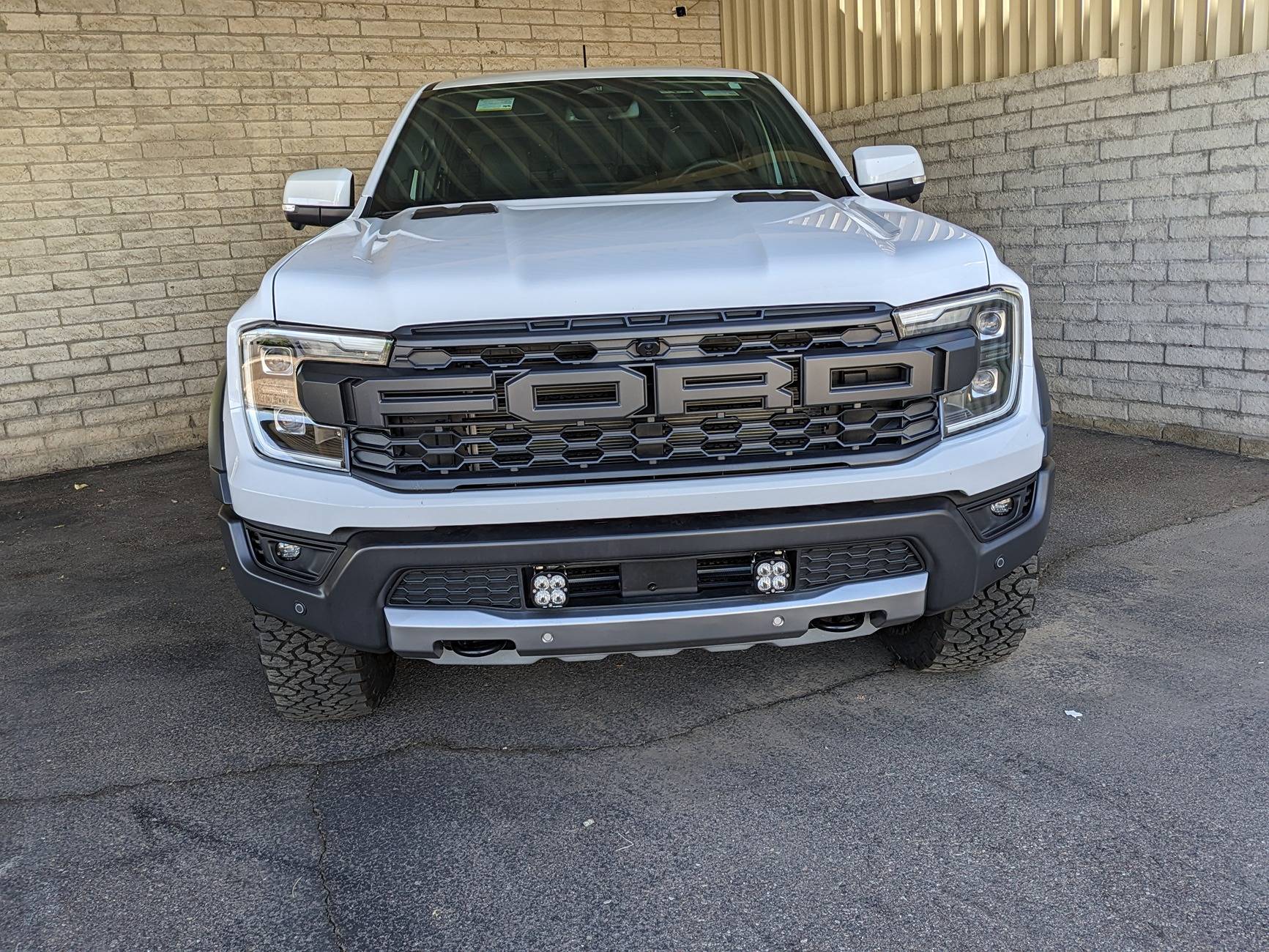

First post in this forum. Ranger Rapter owner all of 5 days....
Wanted simple wide throw lighting for trail driving.
Looked at Rigid and Baja Design.
Went with Baja Design due to being able to change pattern of light by simply changing lenses.
1. Popped out two plastic rivets where the lights are mounted
2. Drilled an extra hole in light bracket for desired horizontal spacing
3. Cut off what appears to be license plate mount above passenger side light to optain clearance for bolting on light bracket.
4. Mounted lights
5. Ran and attached wires to upfitter/aux/yellow wire above D in FORD
Let there be light....

I suggest verifying the dimensions of any pod light you are considering. The verticle space where these pod lights are monted is only 3.5 inches high. At the store, we removed one from the box and held it in place to verify the fit before completing the purchase. The pod lights on this Raptor are Baja Designs Squadron Pro, clear, wide. Lenses can be changed for different light patterns or a yellow cover can be pushed onto the front. Thanks for the feedback, its appreciated.

Looks like you could fit one more on each side.

Yes that is why I chose that location, but going to try just two lights for now. To add two more lights in-between these will require some custom bracket work. With temperatures up to 115 degrees in the desert here I did not wast to restrict intercooler air flow. There are two more plastic rivets closer to the centerline of the vehicle in this area. It would likely require a piece of flat steel with two holes in it. One hole to bolt into the plastic rivet holes a second hole to bolt onto the pod light bracket. Pretty easy with a vice and a drill.

The best part of this mount is there are two pushpins you can pop out and it is a perfect spot.

The wires I described for upfitter switch #6 had both power and ground wires
Per my previous post
" Ran and attached wires to upfitter/aux/yellow wire above D in FORD"

I had not even noticed re logo upside down - Thank you! No bumber removal just removed a couple of plastic clips.
