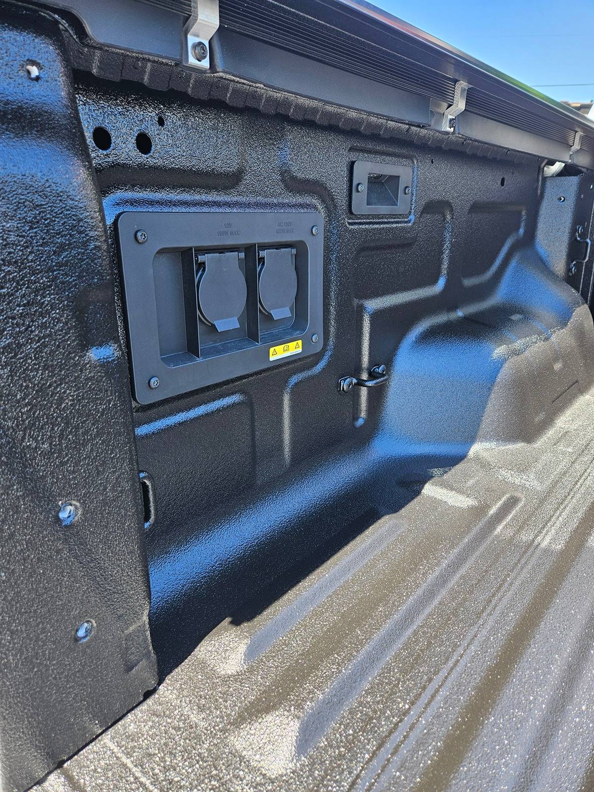

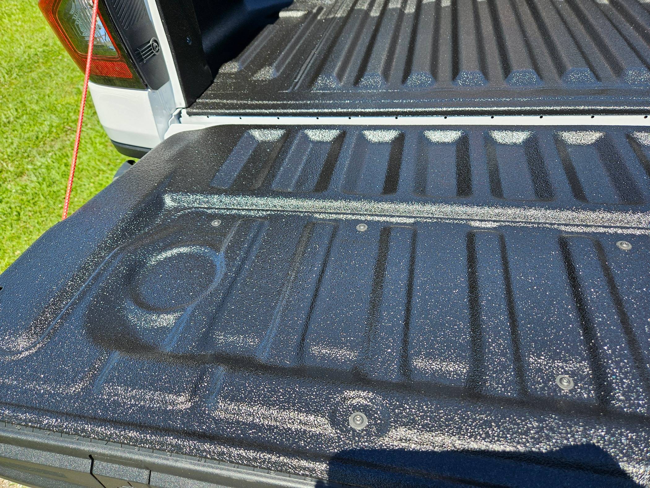

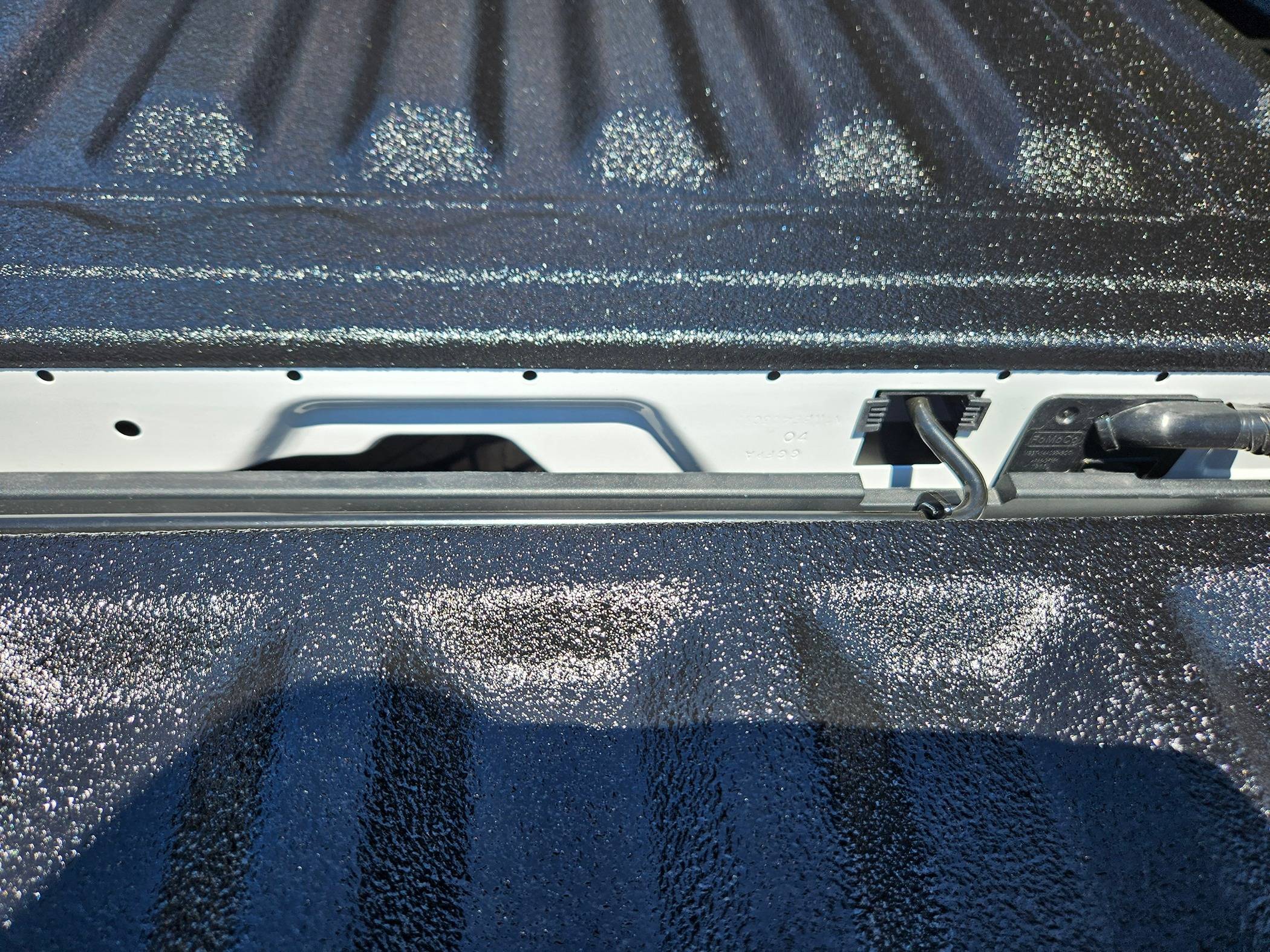

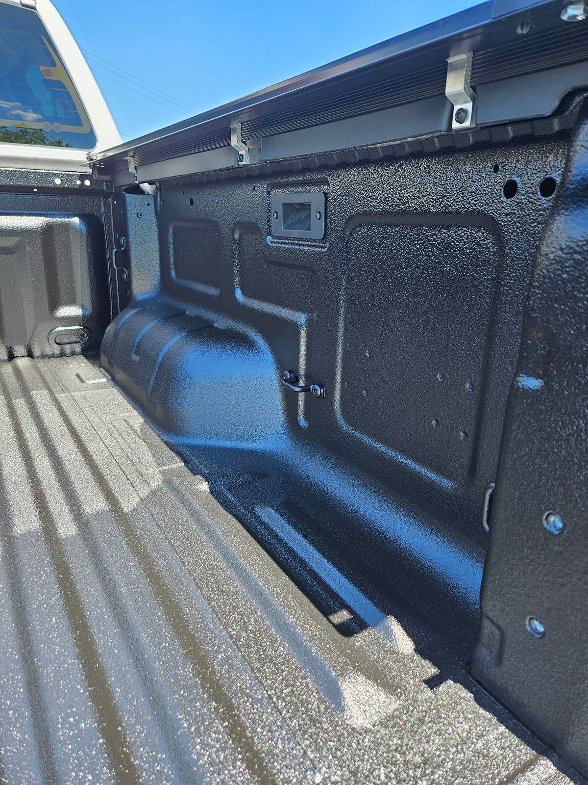

Finally got bed lined this morning. Took about 3 hrs total. It's the mid grade with the enhanced uv protection. It was... not cheap. But you pay for what you get. They sprayed up under the side rails and took the lights out, tonneau side rails out and plugged all the threaded holes. I did ask them to leave the front rubber rail for the tonneau which they did. They also removed the tail gate and the panel on the tailgate and sprayed everything separately. Excellent job by Huntsville Line-X.

I've had several Line-X liners in past trucks. Keep an eye on it. If it starts to fade then they did you like they did me the last time and charged me for the UV protection but didn't actually apply it. After almost a year I went back and had them do it.

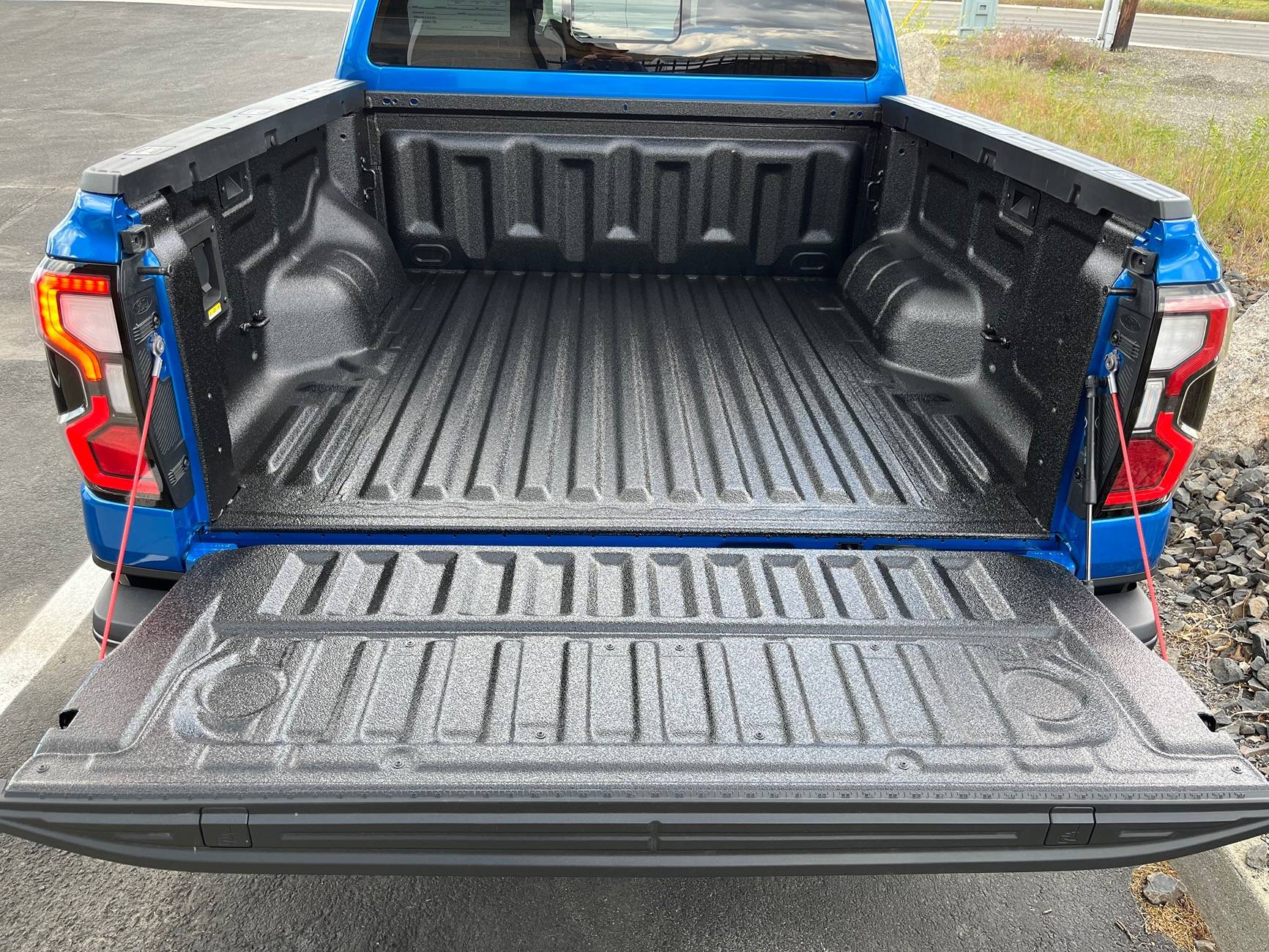

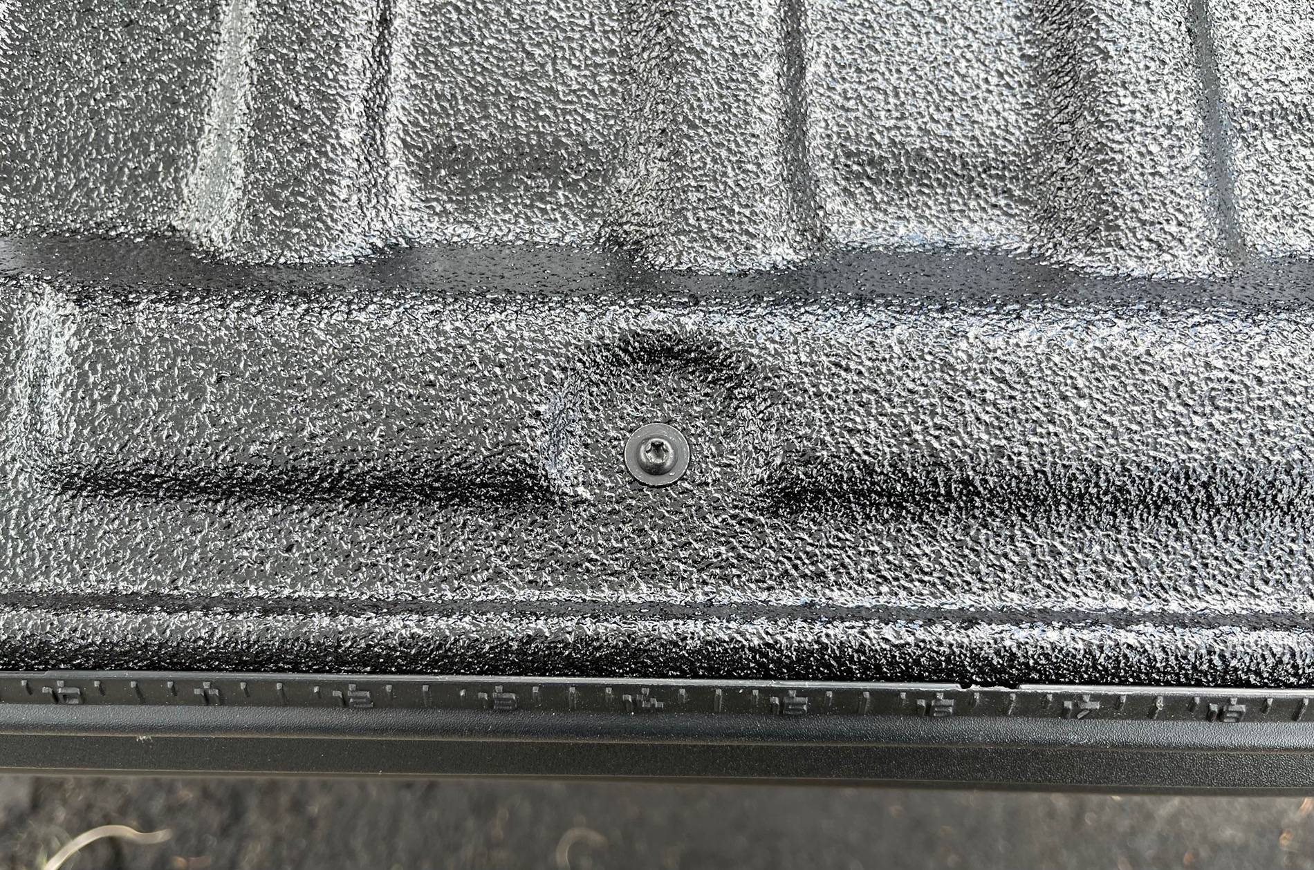

Just had mine done, Premium (mid level, shiny with UV protection) with no other work, $689 in Coeur d’Alene ID. I asked why did they spray OVER the tie downs? He said that Line-X Corporate called all dealers and told them to NOT remove the fittings - the bolts are heavily thread-locked and can snap off.
Has anyone else heard that story? I am OK with this, if correct….
FYI, I was going to have them also apply paint protection film to the door sills, until I discovered that they farm that work out to another shop. I declined, I do NOT want some unknown kid hooning around in my Raptor. I am dropping it off myself at a nearby PPF shop to get that work done today. I will post a thread about it when it is finished.

Had Line X done last week and my hold downs were removed
Line X of The Lehigh Valley
FYI the factory liner sprays over them also.
