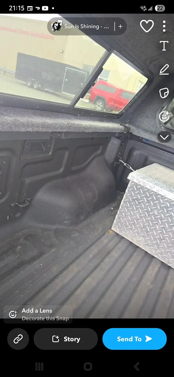

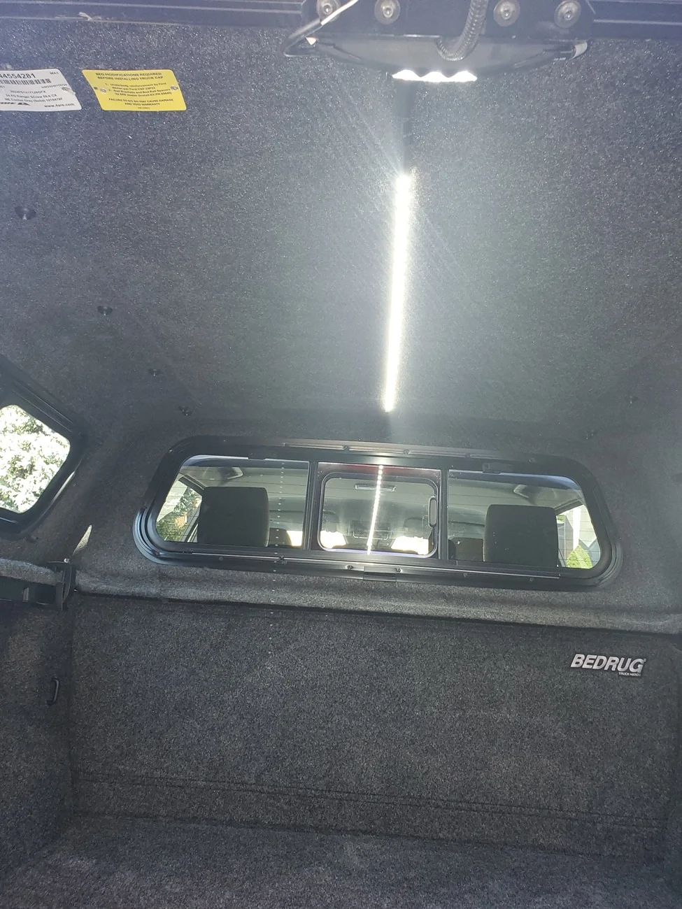

Did the bed rug with ARE topper; matches nicely (not exact) with headliner. I carry samples for work.
Has carried camp gear several times and cleans out very nice.

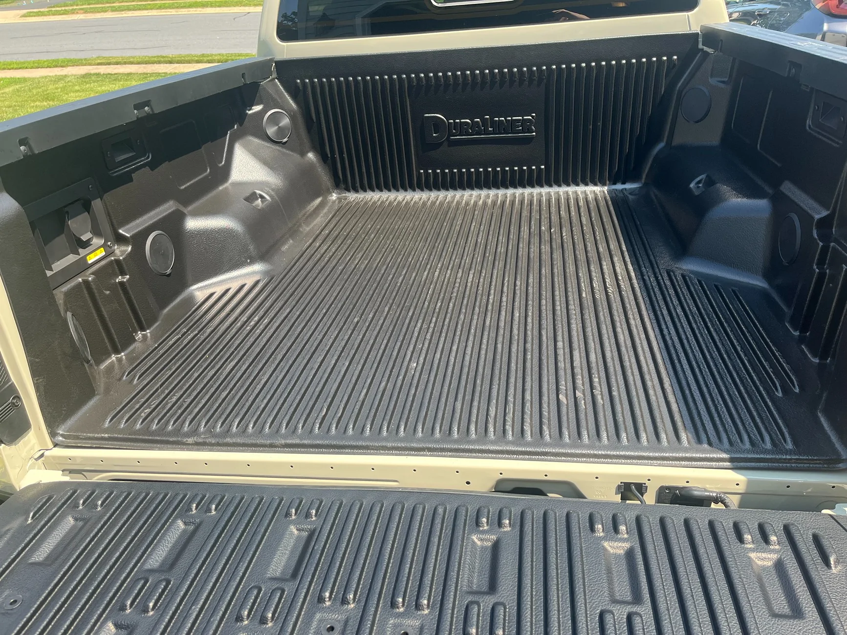

I was worried about the tie down bolts that needed to be removed for the factory bed liner. I've had many trucks over the year with both spray in and drop in bedliners. I went with DuraLiner over spray in for this truck as it's way easier to clean. I had the local DuraLiner dealer order it and shipping was free (under $300). I let them install it for a small fee. Like $350 all in with shipping and installation. For the install, they had to cut out the bed lights section (4 screws each light) and the power section (4 screws). The body facing side of the liner has a guide line so you know exactly where to cut, super easy. Then it just pops in and you put the bed lights and power section back in and you're done. The tail gate is about 8 screws with some depth inserts. After that, just pop in the rubber circle inserts over the tie down bolts. The great part is you do not need to touch those bolts, making the install just 10-15 minutes.
