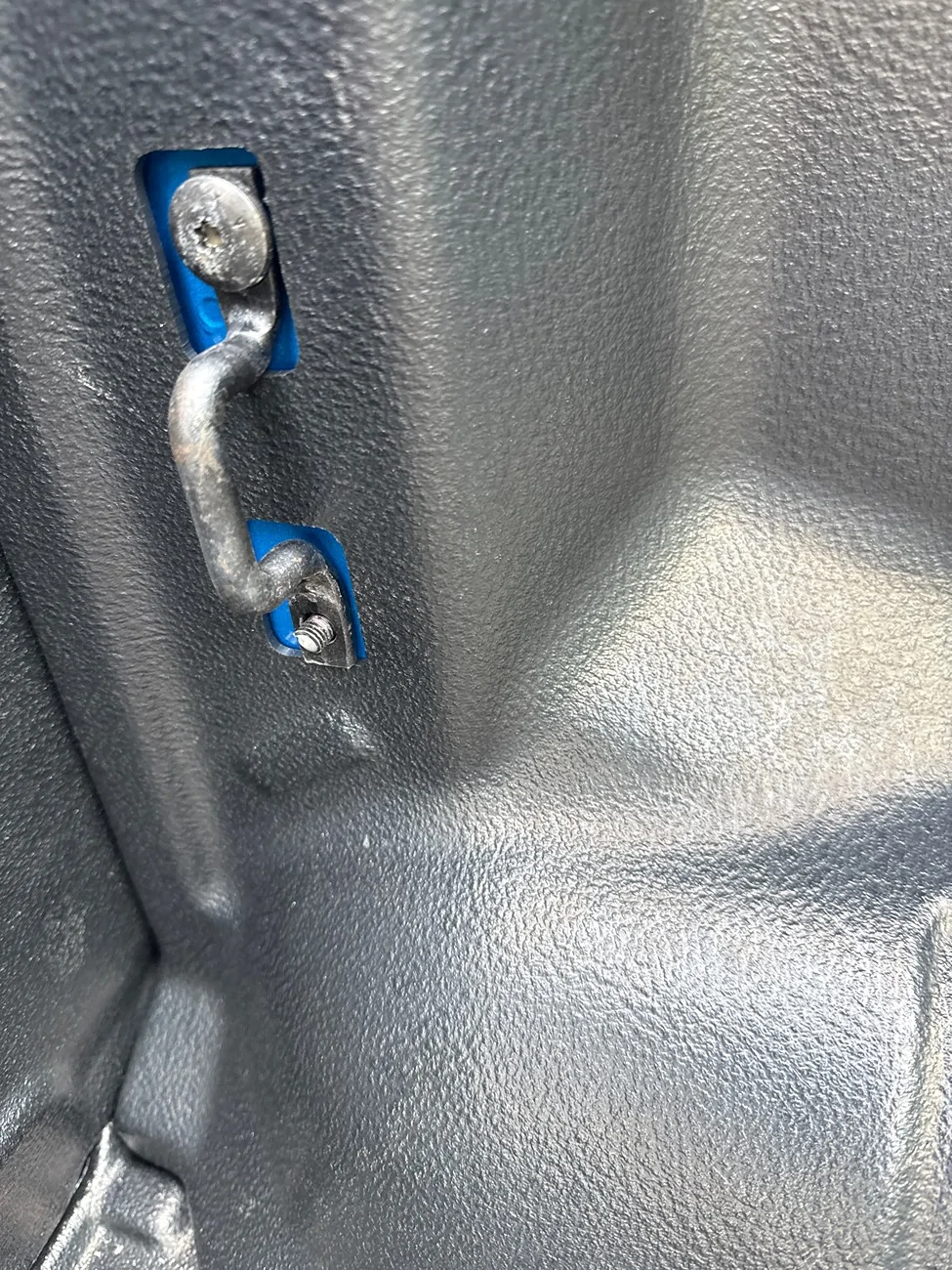

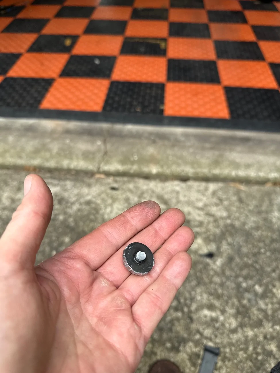

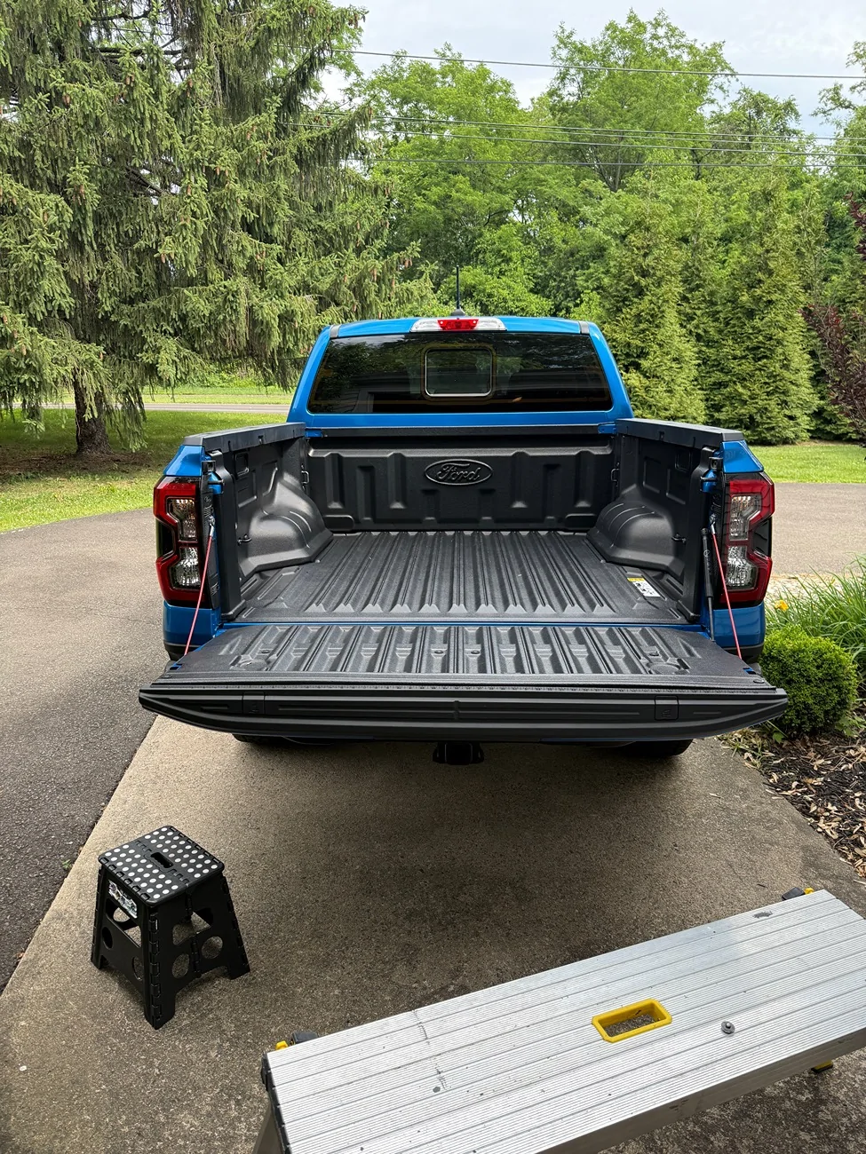

I know there are several threads on this already, but i wanted to make a suggestion if you decide to install a modular bed liner. As others have stated, the tie down handles are installed with about a gallon of RED loctite. They are a bitch to get off. I would suggest just making the two holes that are precut into one big hole and slide the cover over the tie down handles. With heat and patience, I still snapped one of the heads off a bolt. The cover is great and easy to install if you don't remove the handles.
