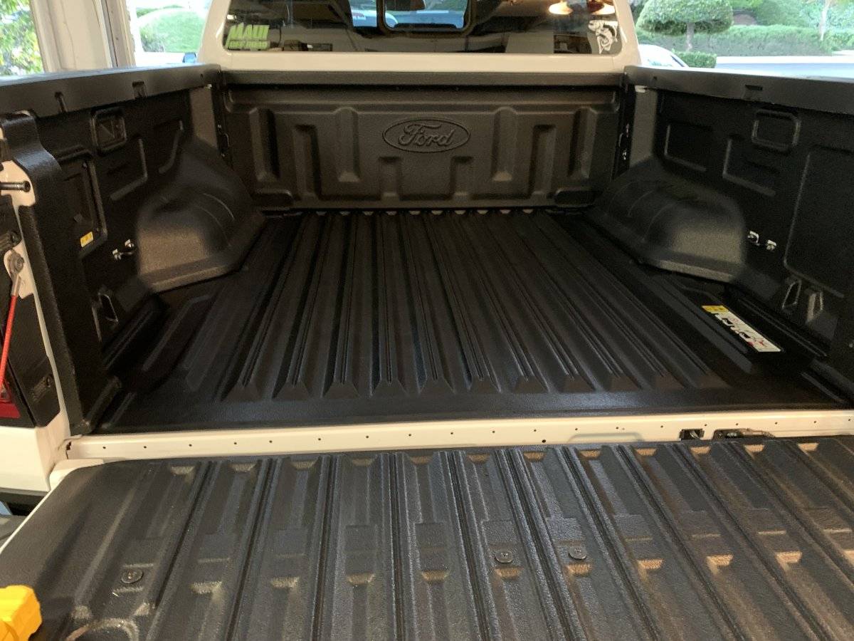

6. Take the front liner (the one w/ Ford on it), push it in at the front, it will sort of click... ish?
7. Tape the brackets to the bed (you can see the tape in the corner) Slide the bottom liner (the big one!) underneath the front liner and above the bracket.

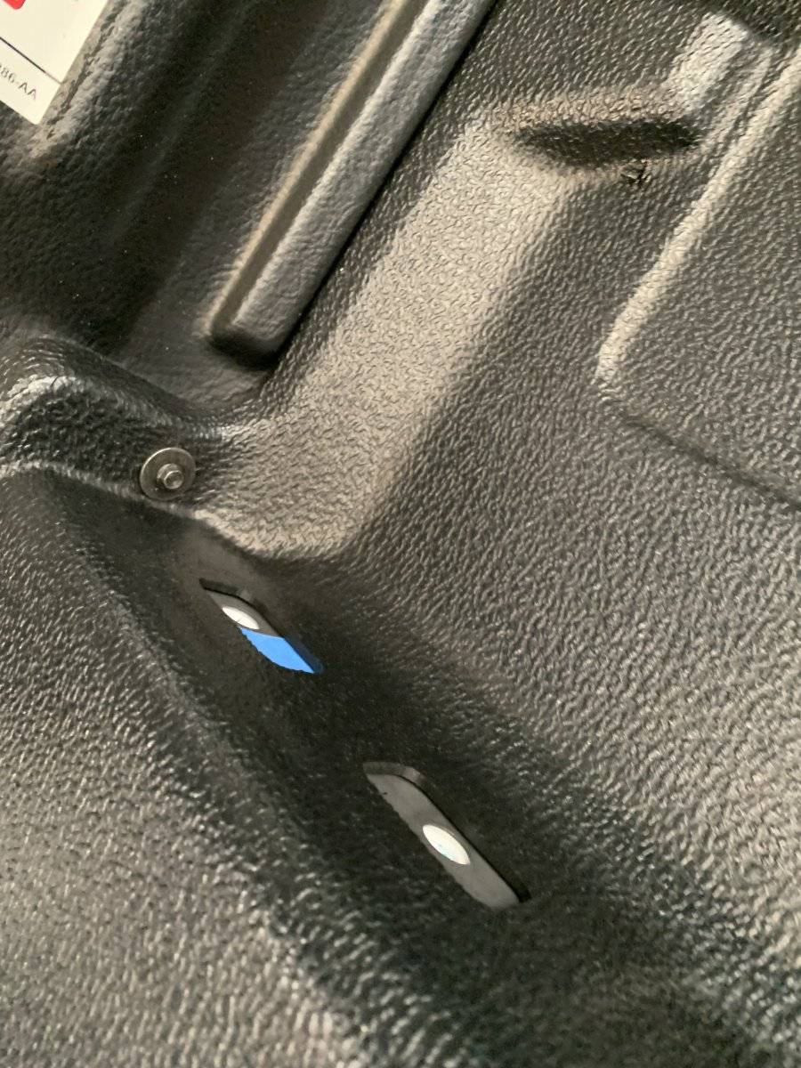

9. Push these pieces into place, first push forward, then bend the edges under the rail, and the end (bump tab?) on the rear corners, bend udner the molding. Make sure the holes line up w/ the pushpin holes & tie downs

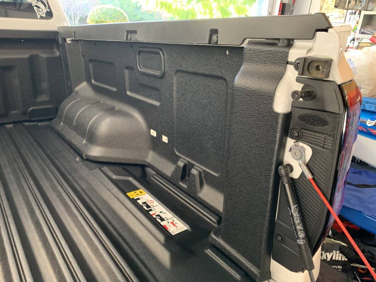

10. Use the pushpins and there should be 3 on each side, 4 on the front.
11. Install the 7mm bolt on the rear corner brackets.

13. Look at the work you did!
Ford Ranger Installing Ford Modular Bedliner - DIY how-to instructions & photos img_3139-jpe
