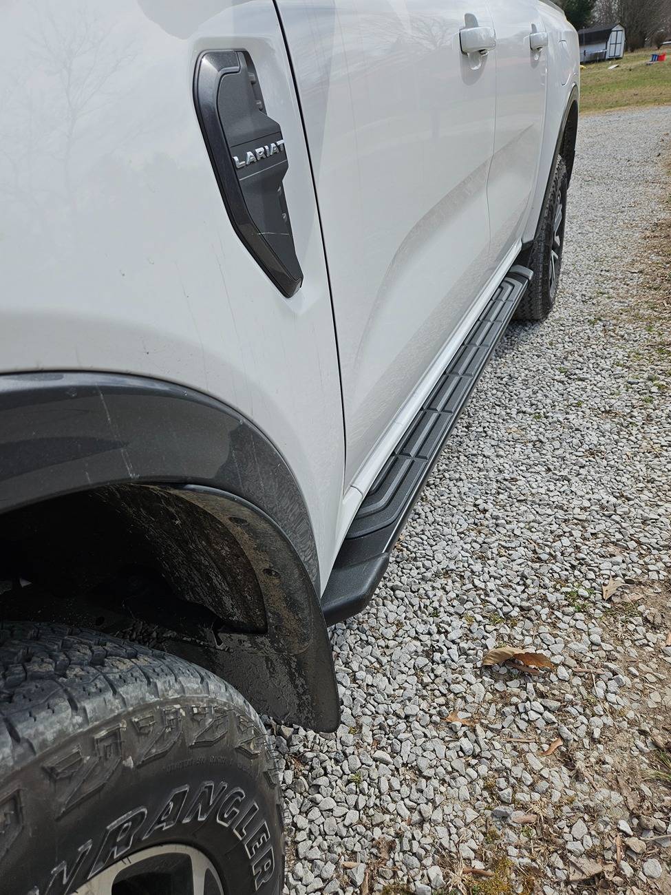

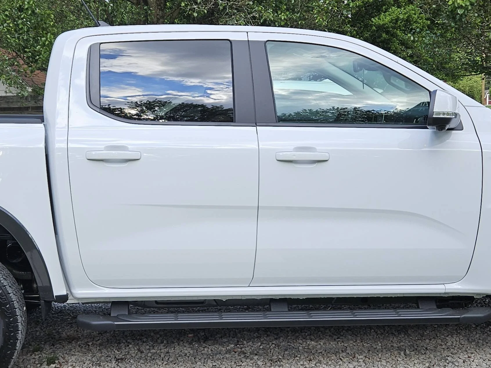

I have the factory running boards on my Lariat but didn't like how low they hung down. I had a friend cut out 2" from the mounts and weld them back together. I think they look much better. They now tuck up tighter to the bottom of the body. Everything bolted back together with no misalignment. I also included a picture without the boards installed.

The gapped space is to allow flexing of the running boards along with if you hit something it should allow the board to bend without hurting the car since these arent rock rails. If you didnt leave space between the body and the rail it self, its going to trap moisture over time and will be come a rust point.
[/QUO
Ford Ranger Raised Factory Running Boards: Cut 2" From Mounts 20250304_131401
TE]
As you can see by the pictures there is still room for them to flex if needed. I did not want them tight against the body.
Living on a gravel driveway tends to kick up quite a bit of rocks and they still provide the coverage to the lower portions of the doors.
Since raising them up they don't stick out as far as well but are still usable as a step.
