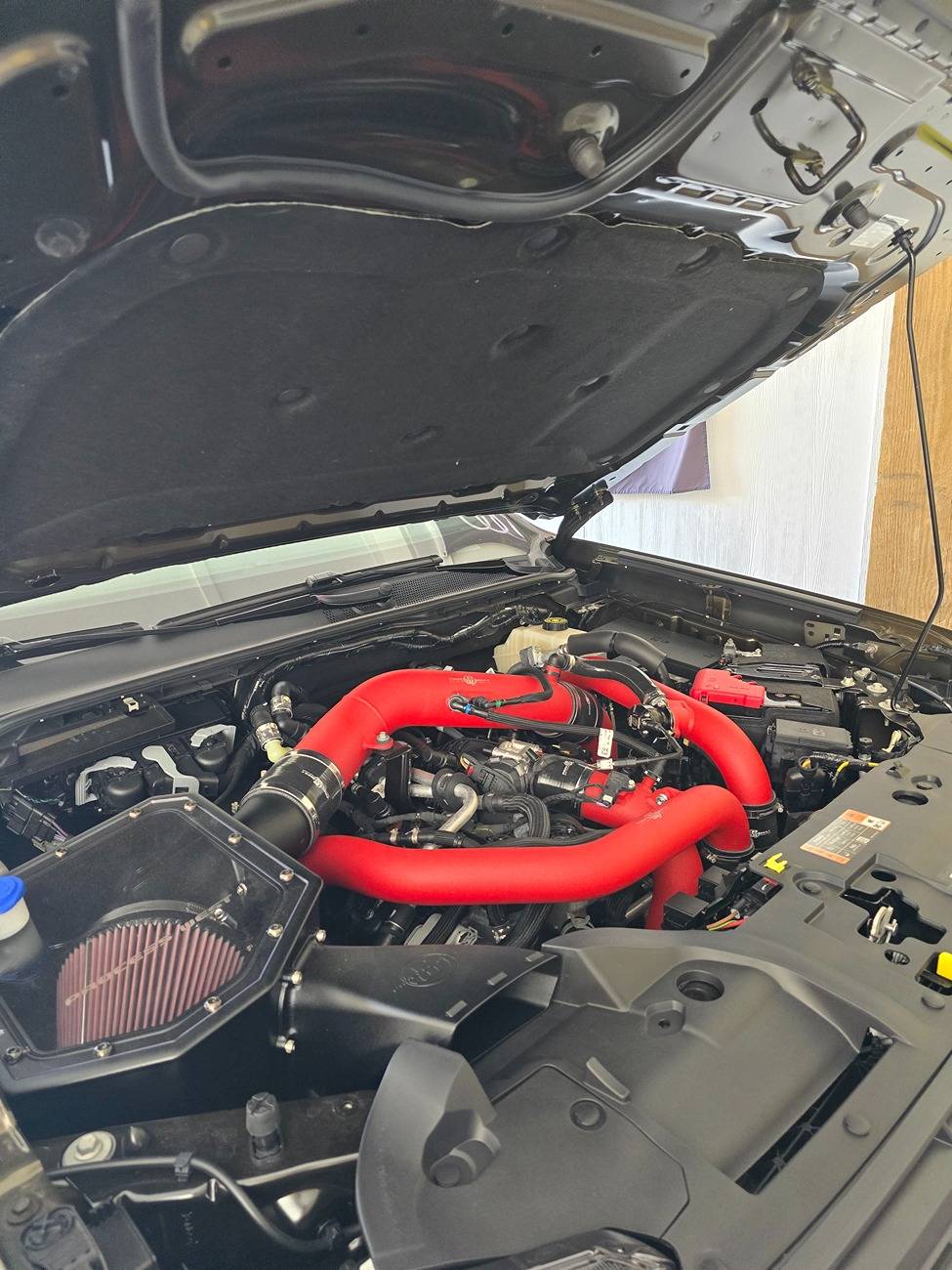

I purchased the truck a few weeks ago and natuarlly I had to start tinkering. I sold my 2021 Audi RS5 to get back into a truck and I couldn't be happier with the Ranger Raptor.
Parts Installed:
- Process West Stage II FMIC with the Stage II hot & cold side piping

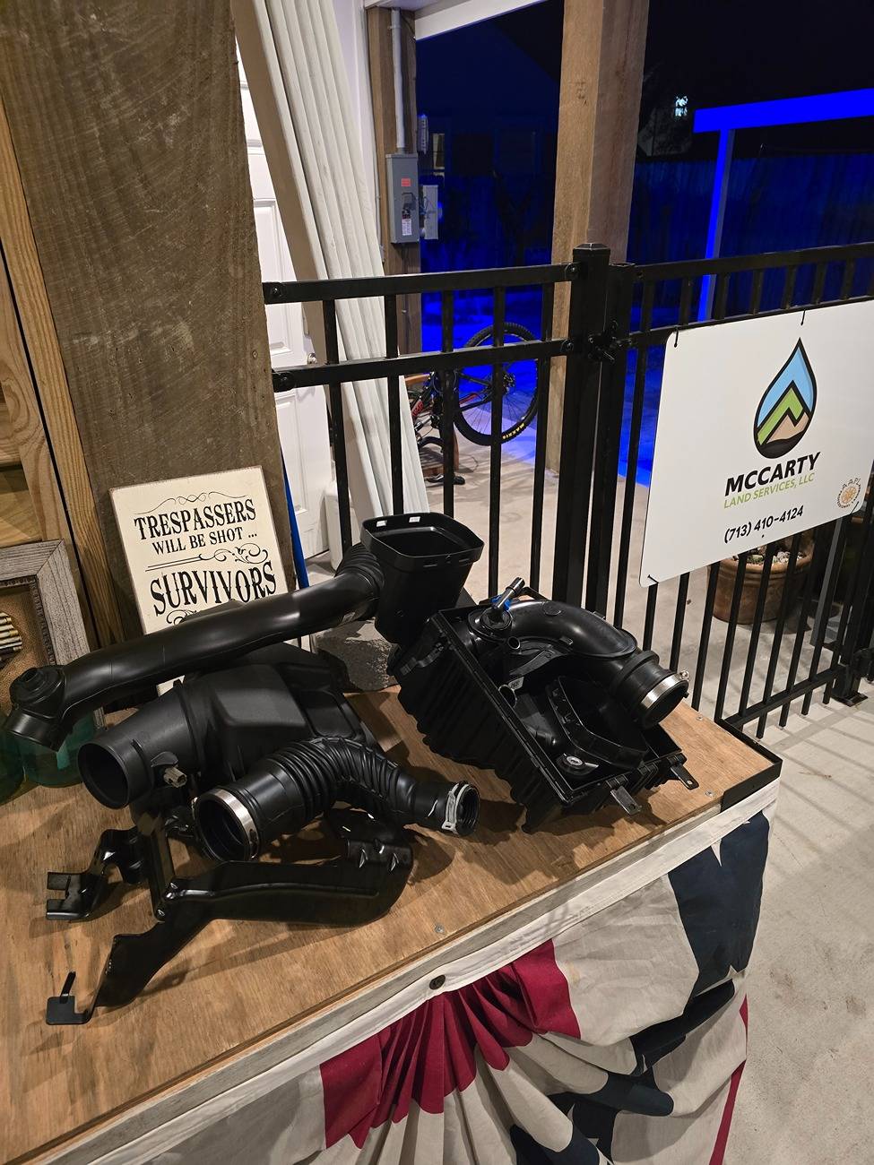

- Process West Intake & Crossover
- Turbosmart BOV

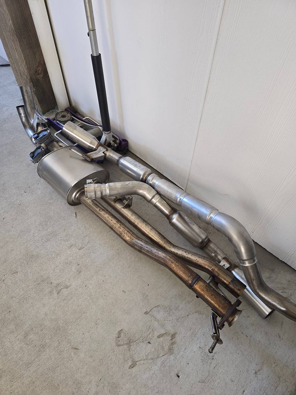

- Miltek cat-back exhaust
- Ford Perfromance Tuner
- Addictive Desert Designs front bumper with Baja Designs lights

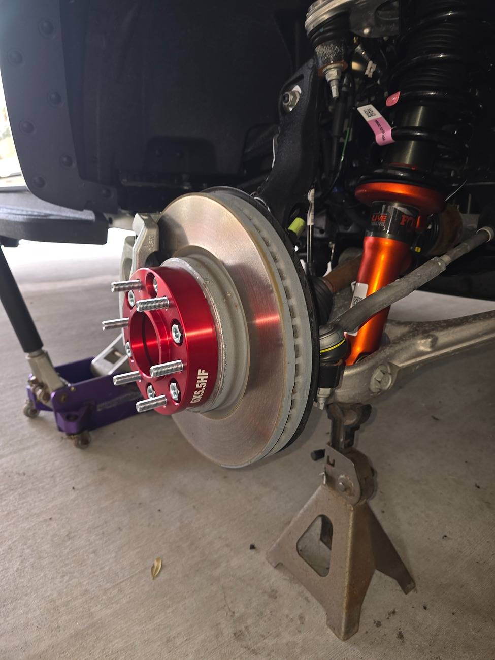

- Synergy 1.5" wheel spacers
Future Upgrades:
- FMI 2.5" front suspension collars
- FMI suspension sensor guards
- ADD rear bumper
- paint matched fender flares and decal delete
- rim & tire upgrade afrer I wear the stocks out
- SPD downpipes
The install process could have been a bit easier with two people, but a floor jack and some creativity can get the job done solo. I figured if I'm replacing the front bumper I might as well throw a Stage II FMIC in there... this is how I validate my actions. The quality of the PW parts is top notch. One thing to note is that the American Rangers have shutters on the intercooler and radiator, whereas the Australian models do not have shutters on the radiator. I had to take a few extra steps to remove the radiator shutters so the FMIC would fit. I'm super happy with the results, the truck sounds awesome and the power has definitely increased. I plan on checking gas mileage after the tuner has had some time to learn the truck and my driving habbits. From what I understand the tune adapts over time for optimum power, shift points, etc.
