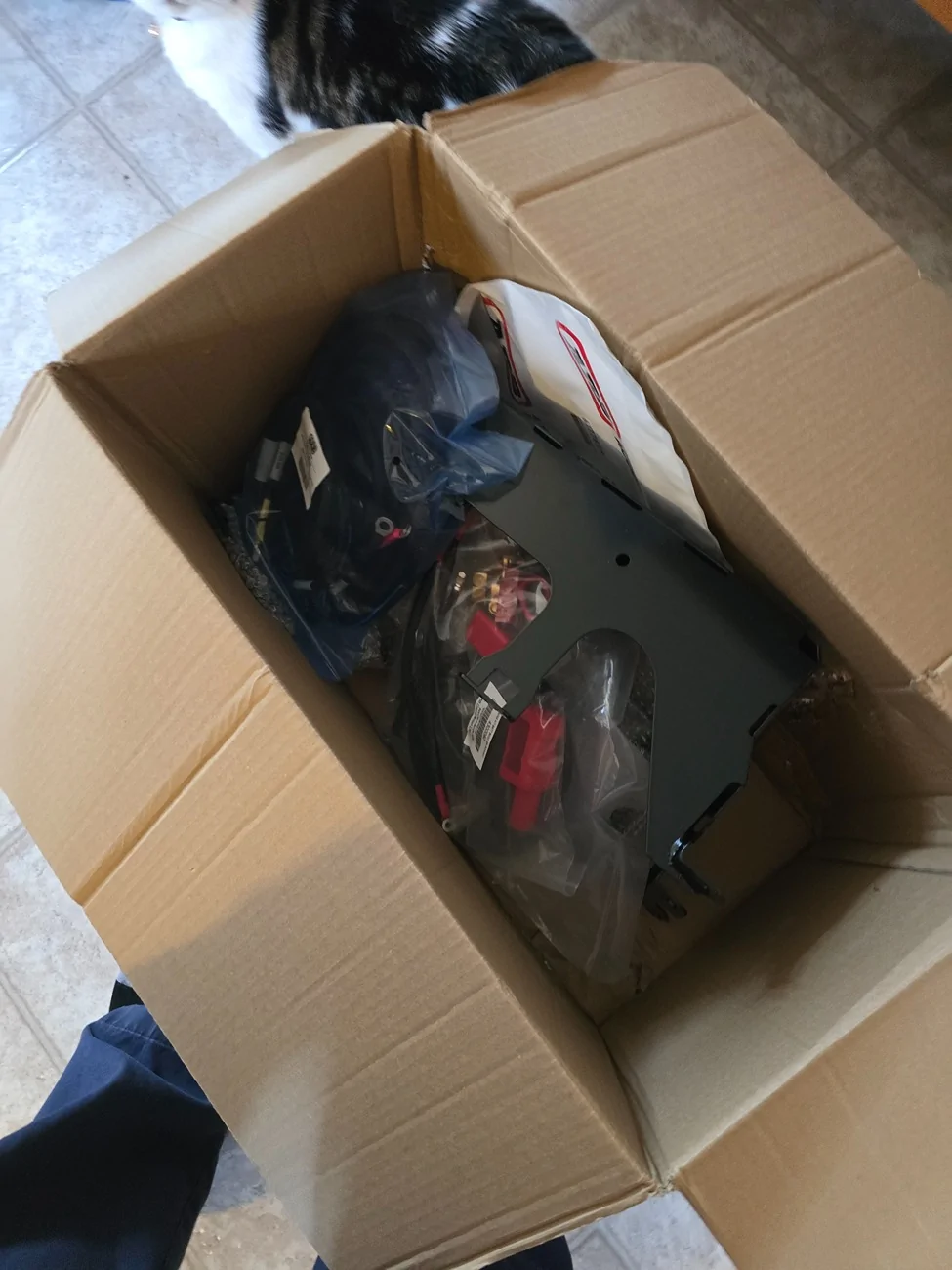

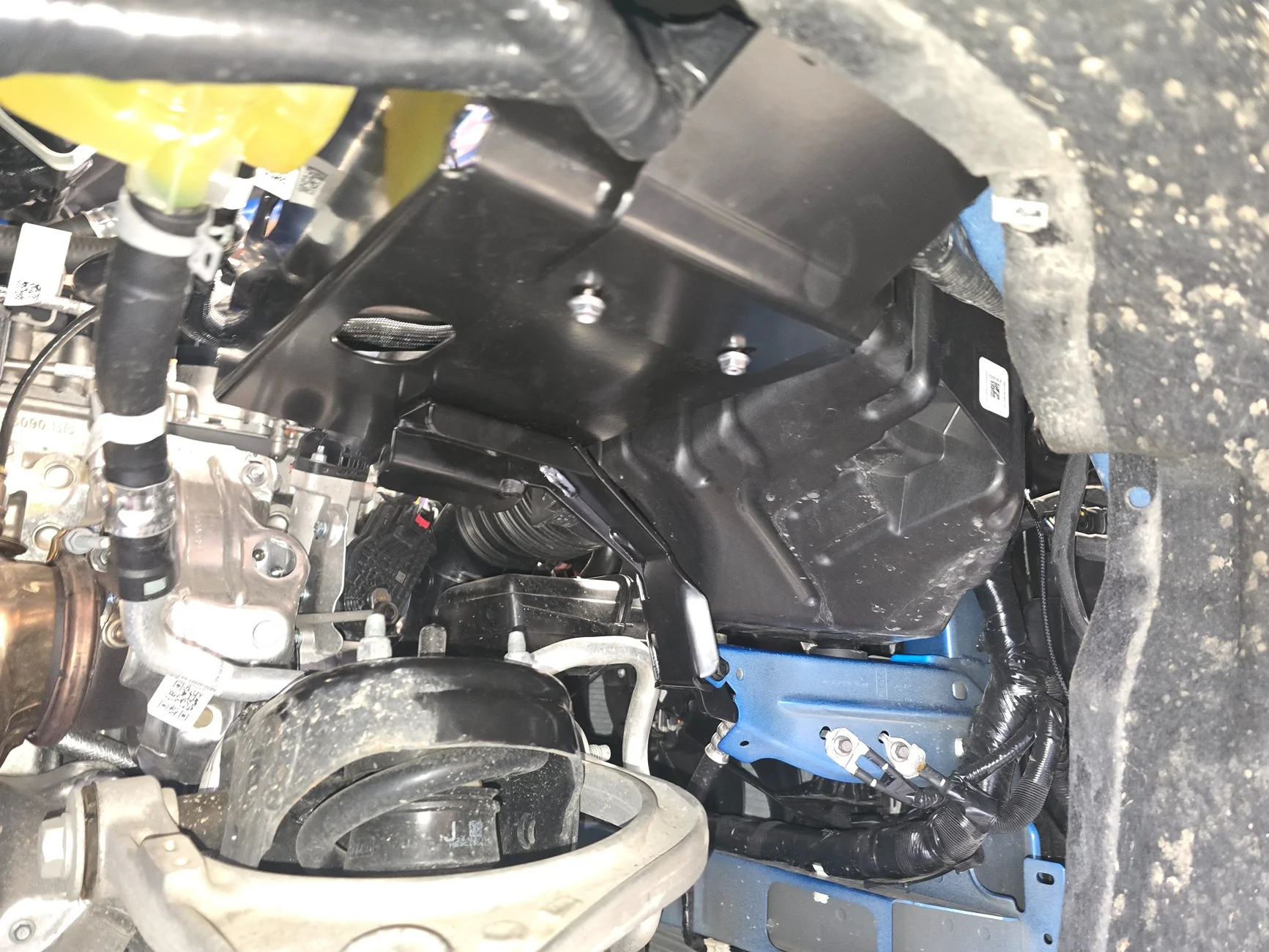

@ShadowDragon24 was that REDARC mount part of the dual battery kit? That's a super slick mount for it otherwise

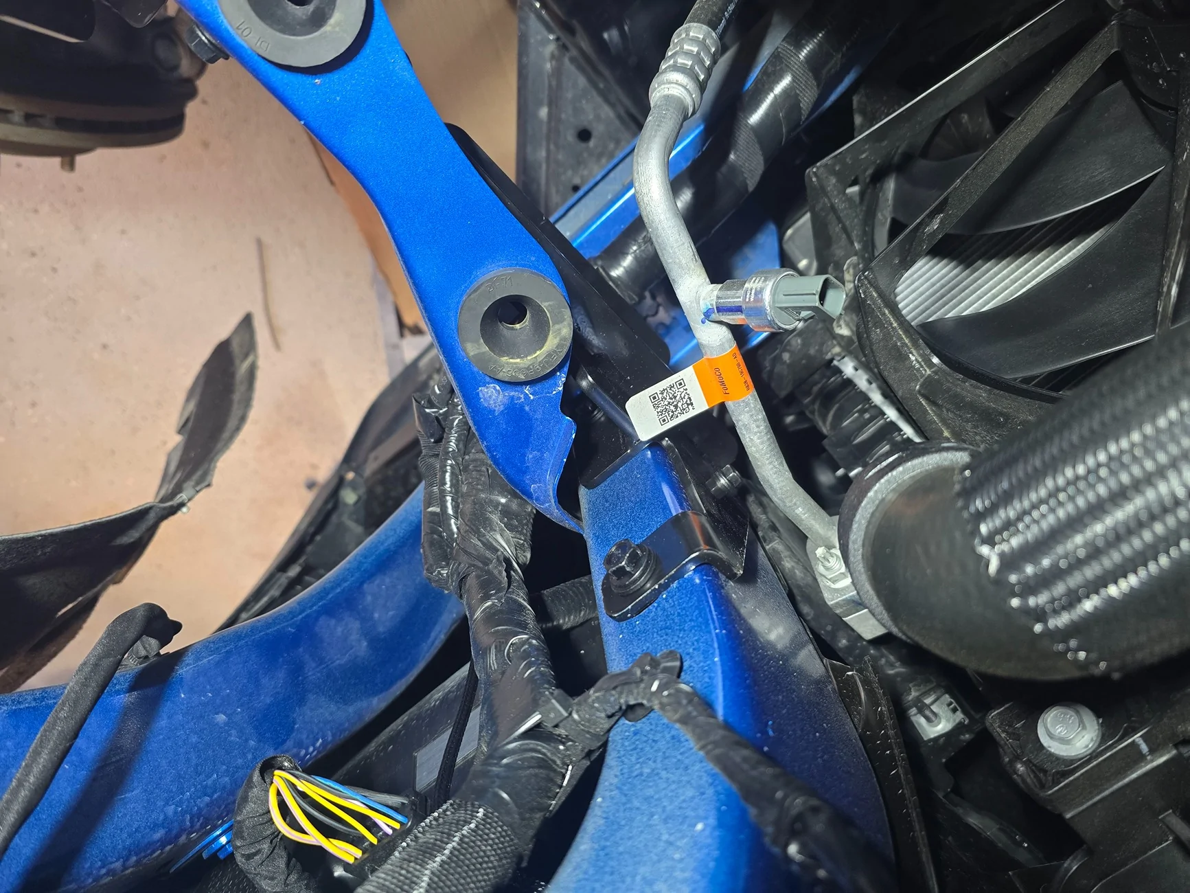

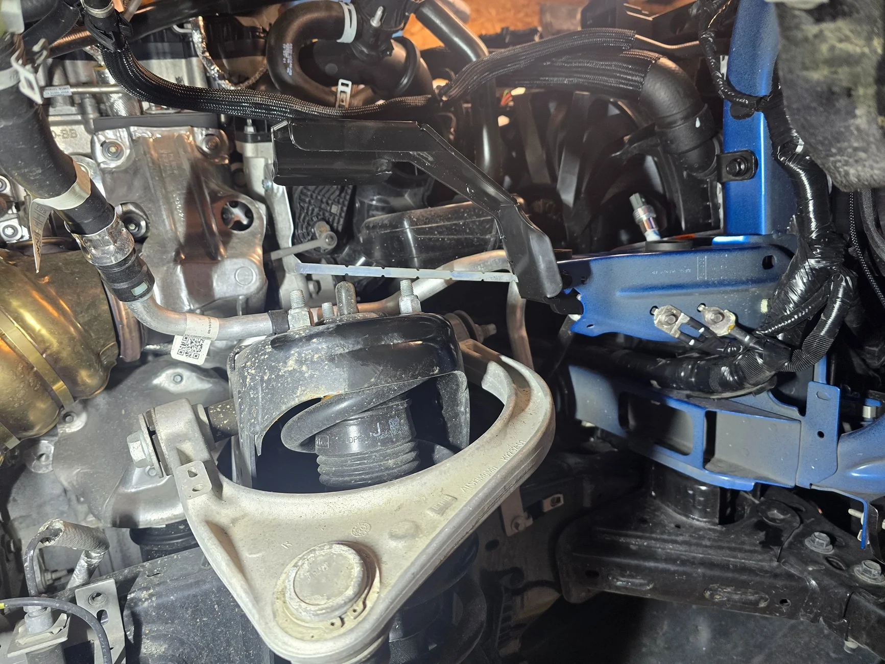

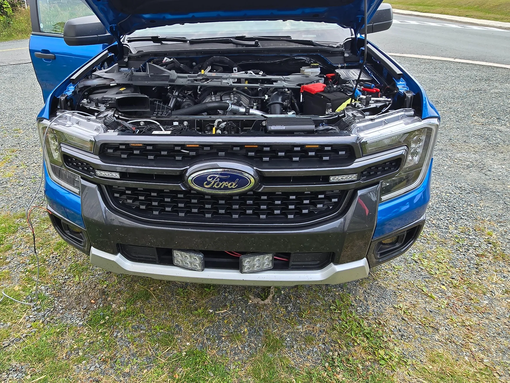

the ARB mount is yupp. also is the REDARC battery charger, as ARB owns them or the parent company of the 2 owns them. lol the only thing it dont come with is a battery. the charger is a 25amp charger, snd has a LiPO4 profile. along with regular batteries. 3 or 4 different profiles. all wiring, hardware, installation instructions, etc is included. even sacrificial bolt and nut for the rivnuts that go in the fender frame by the washer bottle.
the charger even has a solar hook up. I dont have it installed right now, and I am extending it and relocating it to the bunper opening area for when Im camping, and running off the second battery, I dont have to leave my hood open. and I do not have a unregulated solar panel(charger has a regulator built in)
