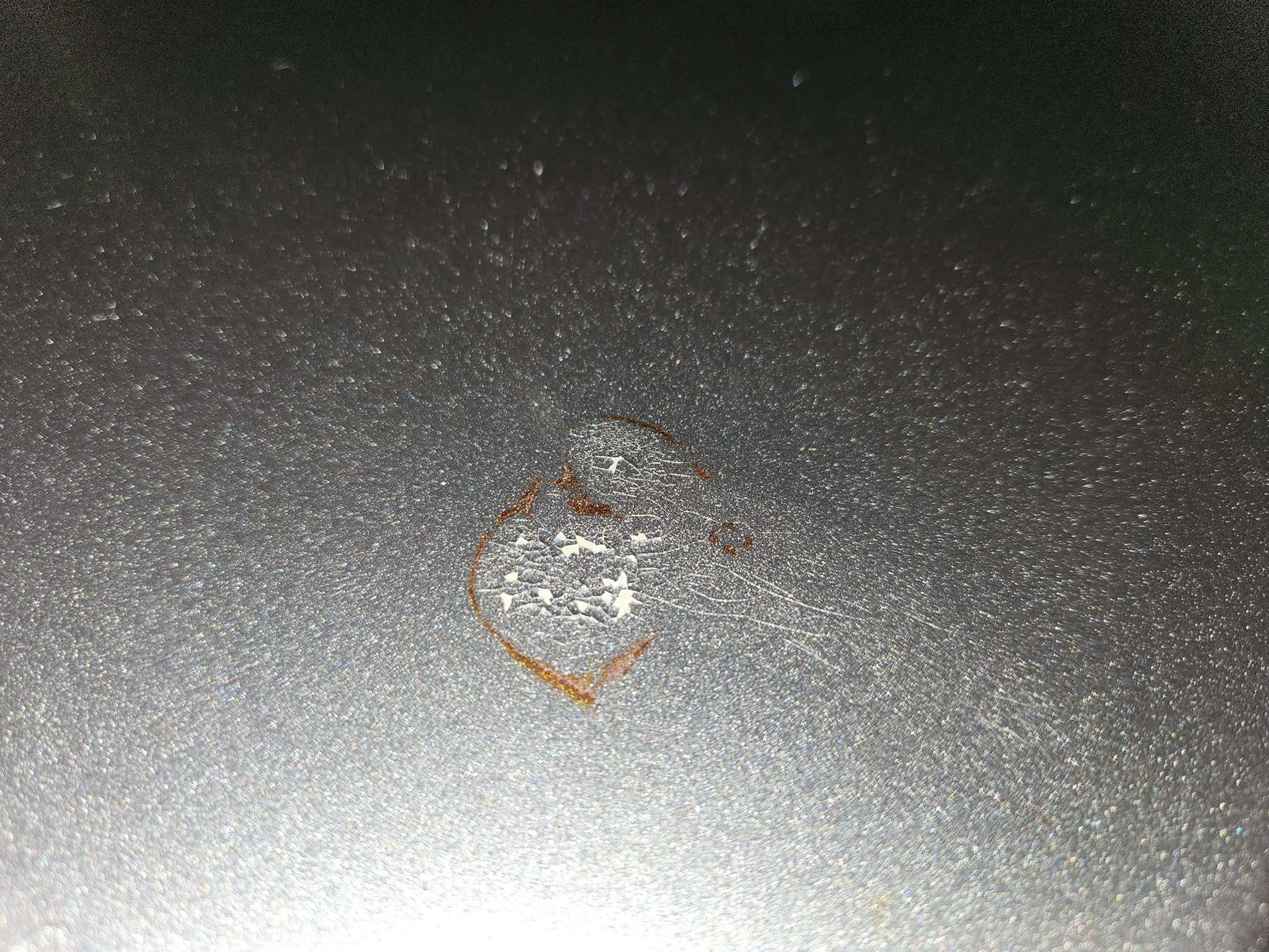

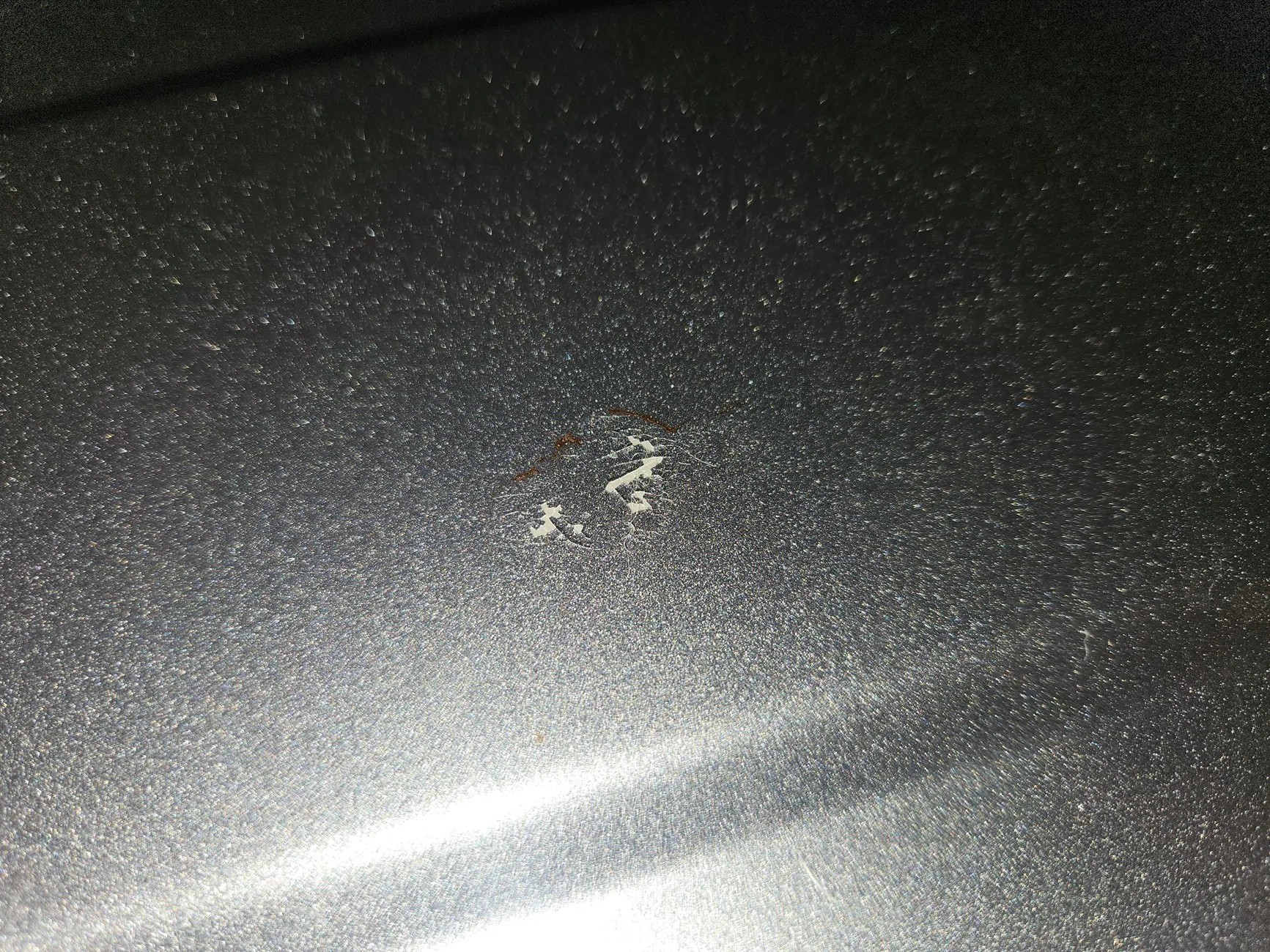

I was washing my truck and found these two spots on the roof. Looks like the paint is cracking. I parked under a tree that dripped sap on the roof but I don't know how that would crack the paint.
Is this covered under warranty? If not, how should I take care of it?

I doubt they will cover this. To many variables as the cause, and they will likely blame you for the damage. Sap and bird doo doo can cause a lot of damage.
Almost any decent body man at a shop can identify that damage as bird droppings or sap damage, no warranty not even with the extended policies they sell in most cases. Today's automotive paints from the factory are many times not solvent based (which last longer in the elements, provide better protection) but actually water based paints,(thank you epa) Sap will actually adhere to the clear and if not removed can damage paint fast. Bird droppings turn acidic fast and bingo damage. I think yours more resembles bird dropping damage than sap from my work in body shops (but water based paints are relatively new from a factory stand point ) and I'm not an expert. Man I'd Find a good body shop and get that fixed, it will get worse with exposure to the elements. Right now it can probably be touched up and blended. The longer you wait the more it will cost. That totally is a major bummer!
