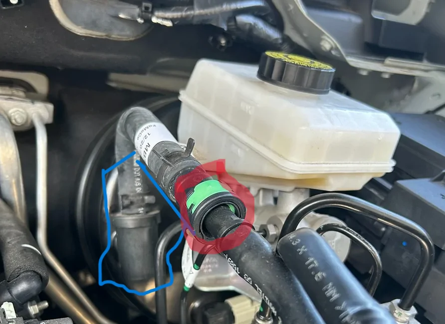

Not sure what type of system this is
That is the typical brake booster system. If that is what you have, testing for vacuum applies. I marked in blue your vacuum supply line and in red where it can be taken apart to see if vacuum is present.The clip connection would be the easiest and it's sealed with a o-ring usually.

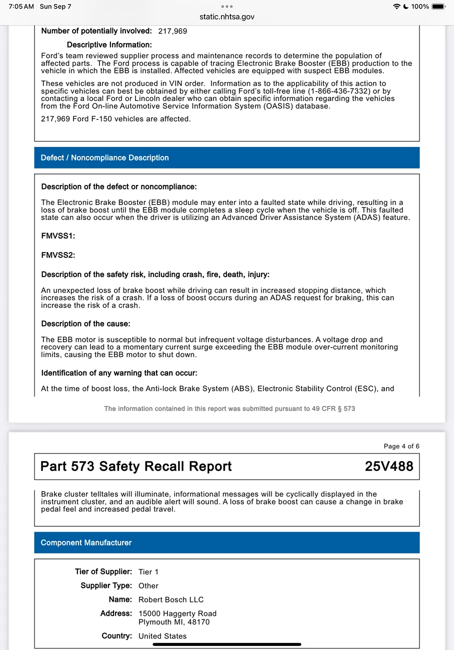

If you have the Driver assist braking system, if I read the innards of the recall correctly, turn it off and see if it affects your braking because if so, you can inform the dealership that it did and therefore might fall into the recall. If dealership doesn't listen tell Ford, if they don't listen tell NHTSA administration to get their attention. The ordeal is called downplaying or normalizing the issue in order to not have to spend time to try and troubleshoot and find the problem.
Great thought! I'll check that today. Haven't hardly driven it because of the issues. Thank you!
