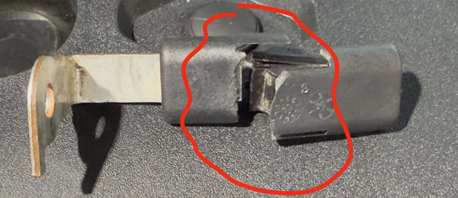

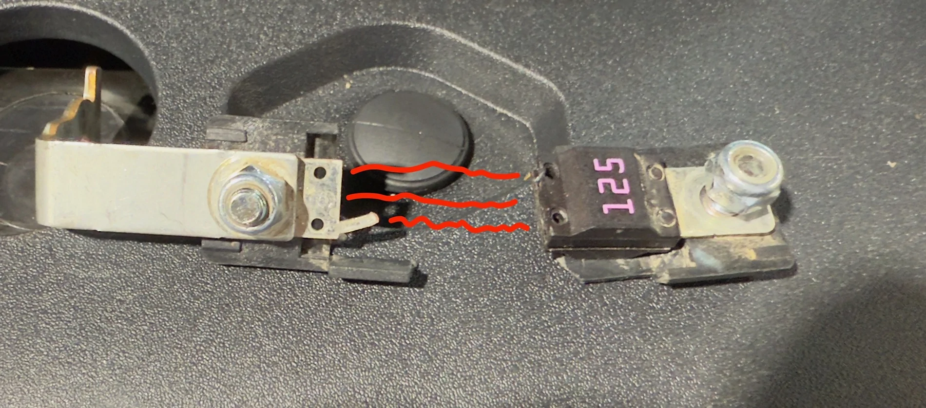

Hey folks, my 2024 Ranger Raptor broke down in the middle of nowhere. All sensors started firing off, the windows stopped working and stayed open, and the seats and mirrors went into dumb mode. The parking brakes locked up too — I had to remove them just to get home and take the truck to the dealership.
When I checked under the hood later, I found the plastic harness and the 125A fuse (connecting the engine compartment accessory fuse box to the battery positive terminal) were cracked. The dealership says this isn’t covered under warranty and wants to charge me an outrageous amount for repairs.
Do we have any Ford reps here who can confirm if this should be covered under warranty?

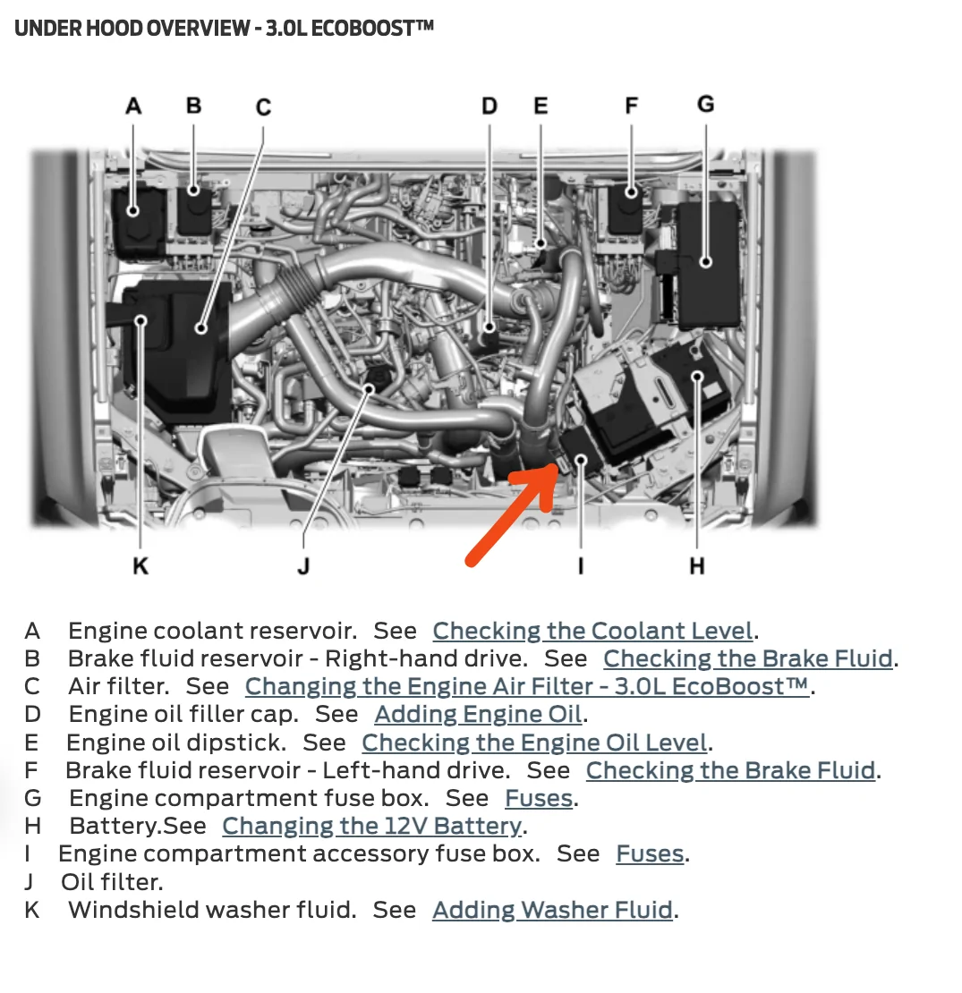

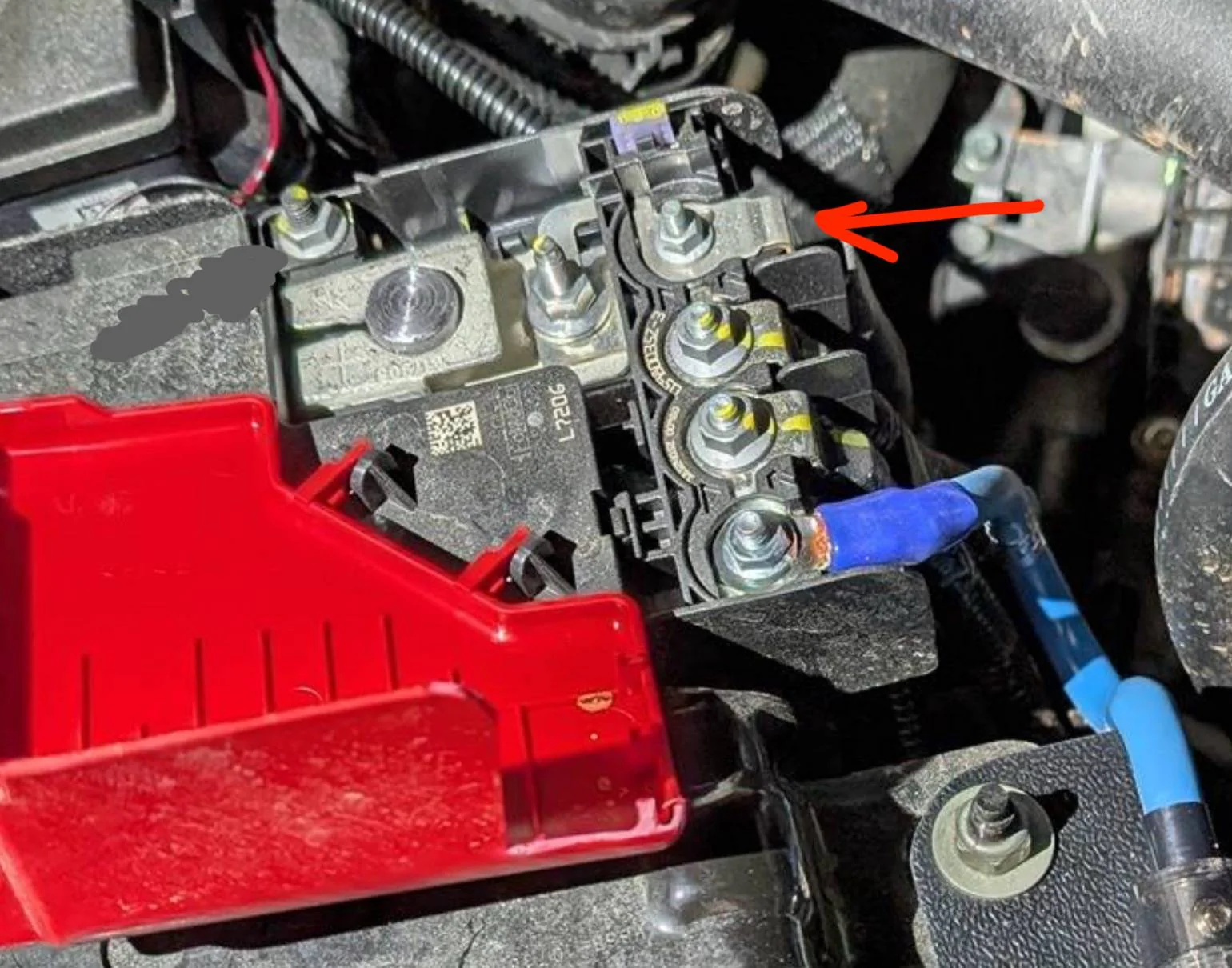

Not a Ford rep myself by any means, but I Had something similar happening to me, my mechanic accidentally broke that exact same piece and the fuse with it while juggling things around the engine bay. He replaced it at no cost to me though.
on another similar note, the cover of my accessory fuse box (item “I” on the diagram above, as pointed by the red arrow) has flown out while driving and when I asked the dealership they wanted to charge for the whole fuse box… cover the thing with plastic bubble wrap and secured it with plastic strap for now, until I manage to find the right cover. Have ordered a few so far but they’re all either too small or too big… can’t seem to find the right part number.

great job and write up. I'm still shocked the said it was not under warranty. So that piece that cracked caused all the issues to the truck? Can you elaborate why all the sensors went crazy if a fuse blew?
MAMAI
MAMAI
Sep 23, 2024
North York, ON
RR@2024
Thanks, waffleso_0, appreciate it.
Short answer: yes, that failed fuse / fuse-holder assembly was the trigger, and modern trucks really don’t tolerate unstable power.
Longer explanation:
That fuse isn’t just protecting one accessory. It’s part of the primary power distribution path feeding multiple modules. When the fusible link failed and the holder cracked, it caused intermittent voltage drops, not a clean on/off failure.
Modern vehicles don’t see that as “a fuse blew.” They see:
  • voltage out of range
  • modules dropping offline
  • CAN messages timing out
So each module starts protecting itself:
  • parking brake locks as a safety default
  • charging system throws faults
  • multiple sensors report nonsense because their reference voltage isn’t stable
  • the truck essentially says “something is very wrong” and goes into limp / immobilized mode
That’s why it looks like everything failed at once, even though the root cause was electrical.
The arbitrator actually called this out: a fusible link is designed to fail under fault conditions, and there was no evidence anything I did caused the crack or failure afterward. Once power integrity was compromised, the cascade was expected behavior.
That’s also why guessing “it must be the battery” or “owner caused damage” doesn’t hold up when you look at how these systems are designed.
Hope that helps
