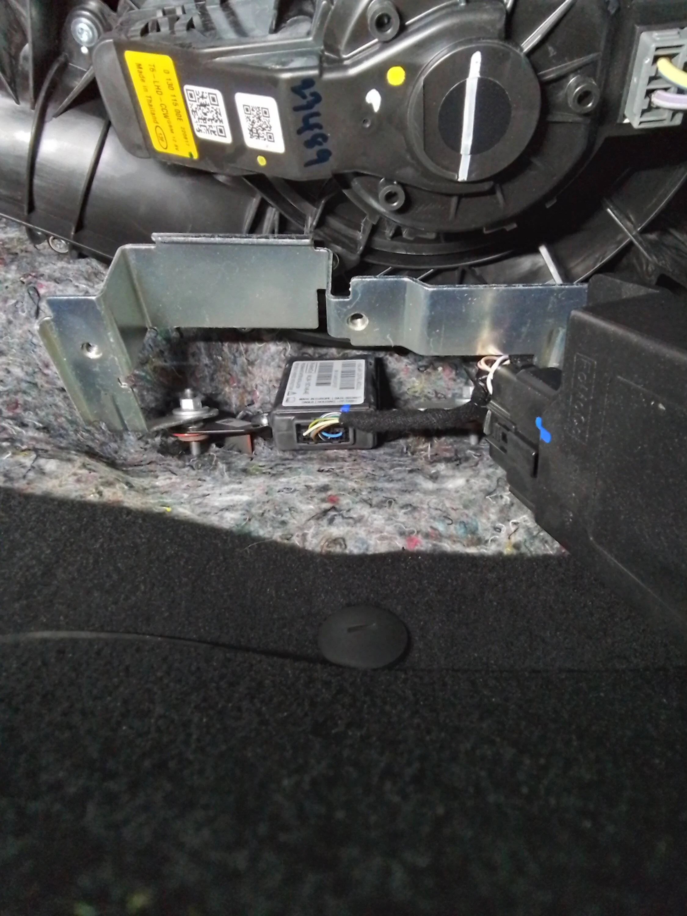

Exciting update on my Ranger Raptor – the Adaptive Light issue has been successfully addressed! The HCM B15A7 module, specifically the Actuator Controller for the Left Matrix, was replaced. Additionally, the B115E Camera Module, which controls the Headlamp, received an upgrade.
Now, the performance is noticeably improved. The lights are way more responsive compared to before. Previously, even when they were working, there was a lag compared to other vehicles I own with similar adaptive light systems. The lights now swiftly respond to incoming traffic and effectively illuminate dark spots on the road.
These images below are of the HCM module.

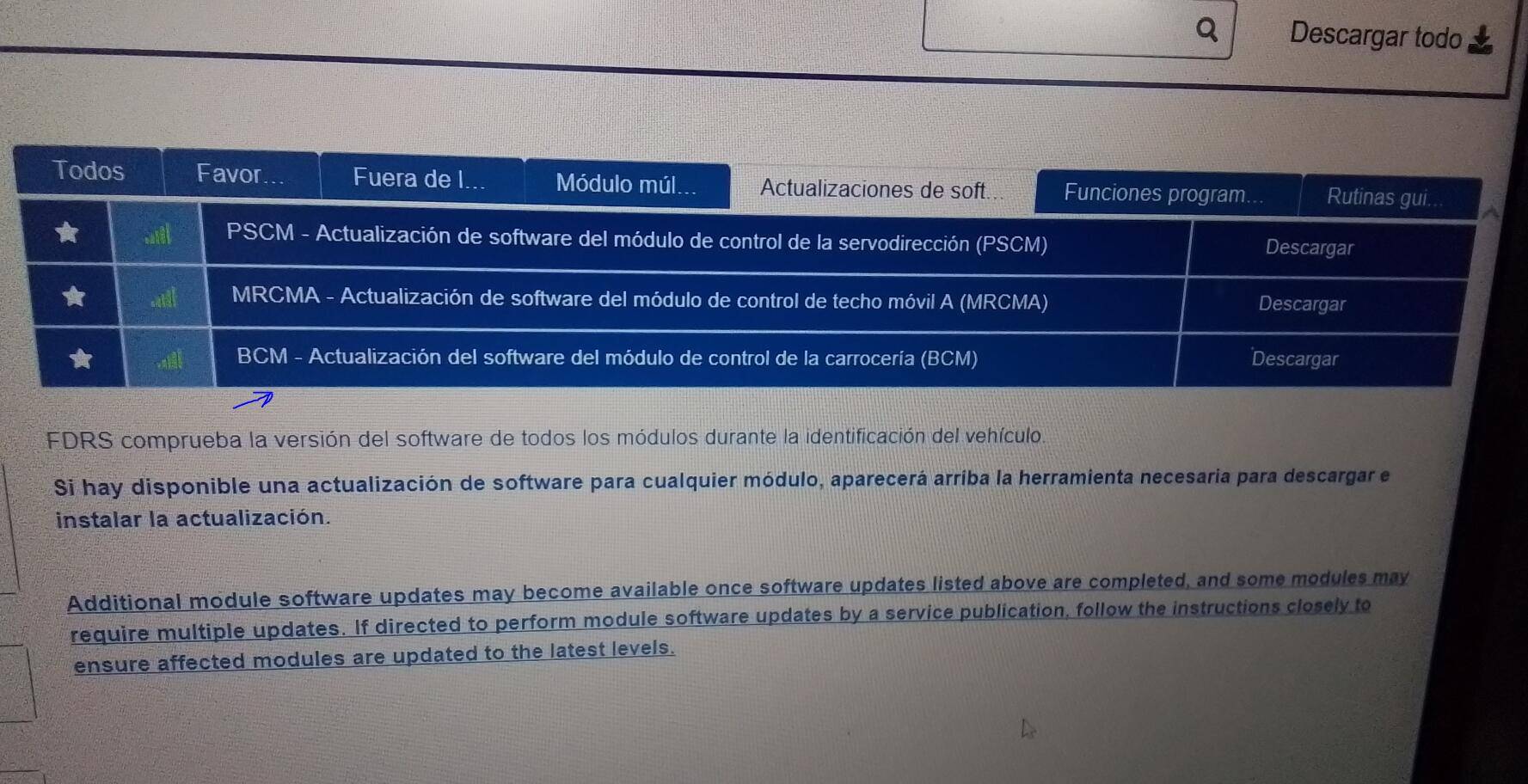

They also applied a Firmware update to the BCM module.

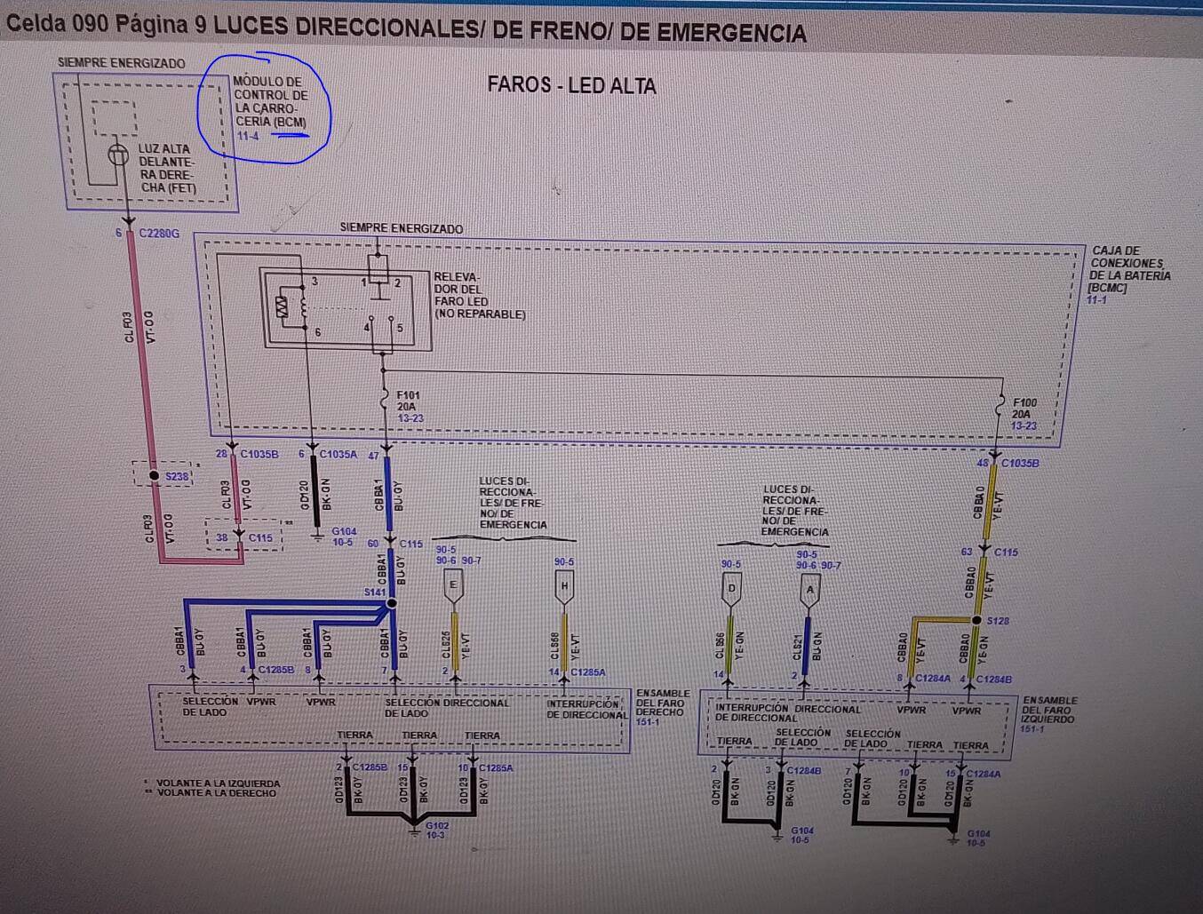

It seems the BCM also affects the behaviour of the Adpative Light module. This is a diagram of the Lights.
