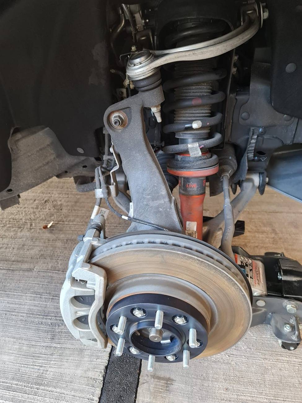

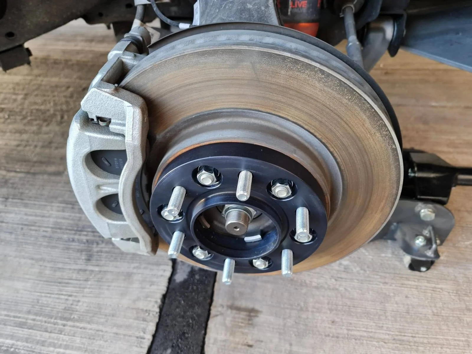

hi, there are a few chip options available in europe for the ranger. you can try one of these. In europe you can check racecip or P-tronic they are both piggy back style chips, not ECU reflash. In NA im using JB4 and it works great on my raptor.
For spacers you can do ir of course, I would just suggest to het goo brand spacers like eibach or H&R and not go crazy, maybe 20-25mm max, and you should be more than fine.
I have a set of 20mm eibach spacers waiting to be intalled for my RR.
