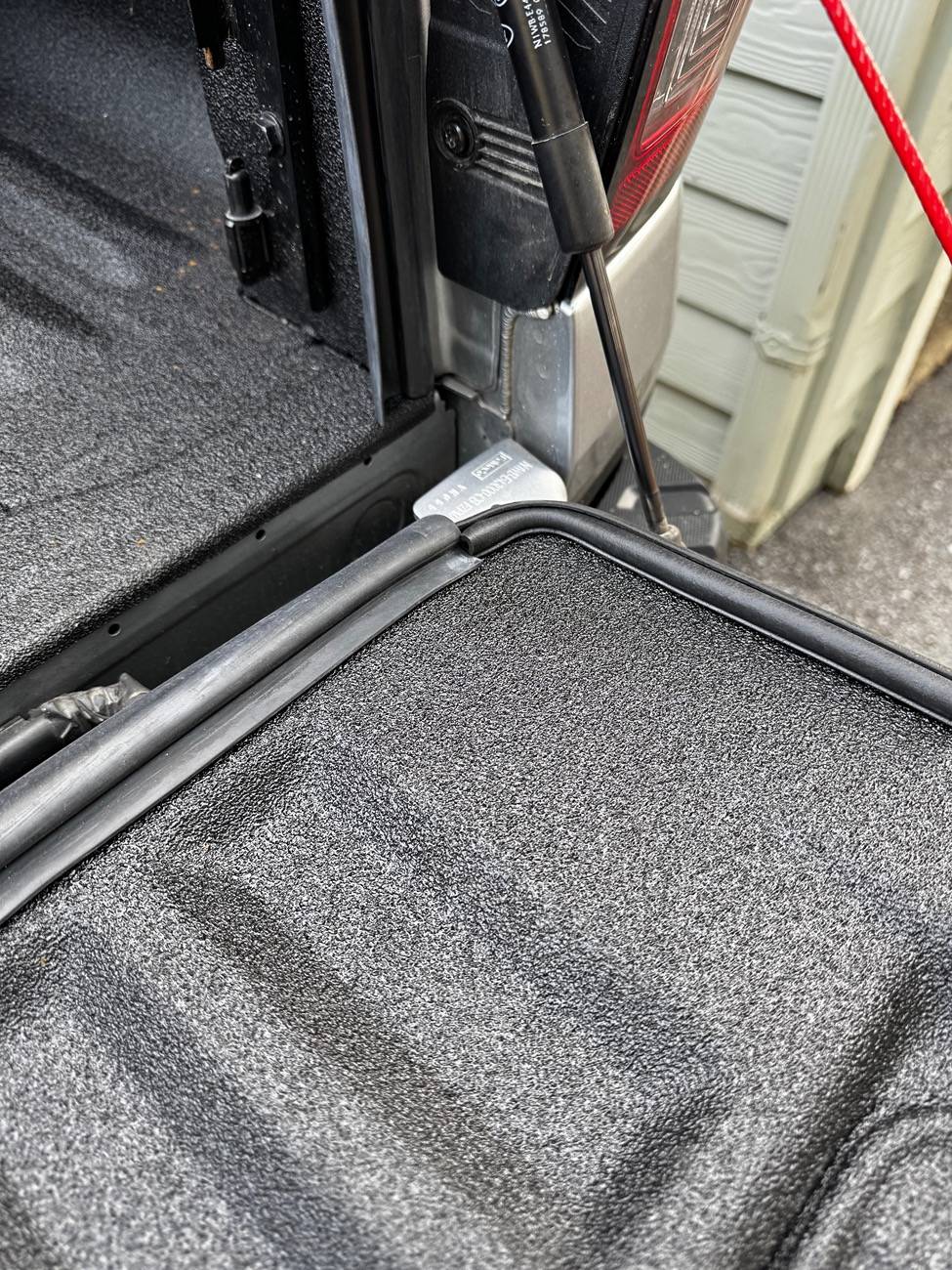

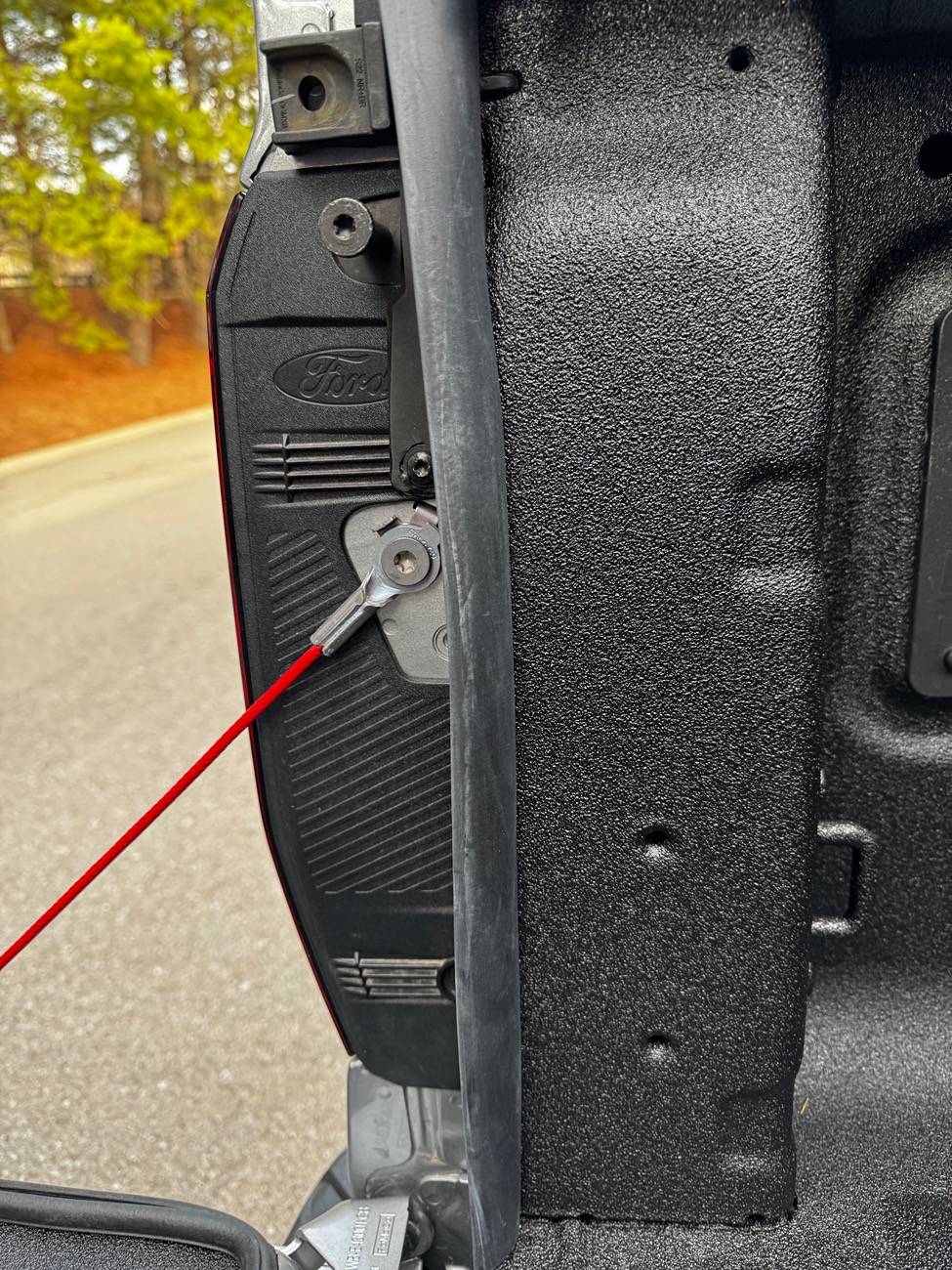

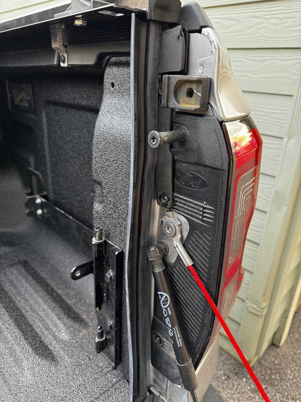

I installed the Keko last weekend. Seals up tight. Well made. Downside is the seal is on the gate vs the bed, which could be pulled up accessing gear in and out. Mindful and not a problem.
Includes a bolt on bracket to complete the bedside seal for 1/3 the price of the Ausie model. I would love that one, but didn’t want to spend that much.
What size is that torx bolt? Mine has 1 torx and 1 regular bolt for the bracket.
