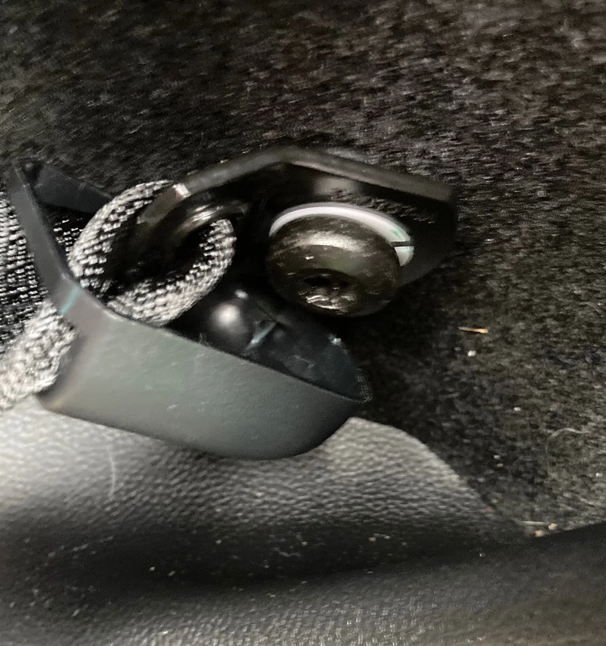

Found it! Backseat drivers side seatbelt connection to the seat,popped plastic cover off, it was rattling against the bolt that comes out of seat to connect the belt. Covered in foam, popped cover back on so far so good. Thanks for all the suggestions👍👍
