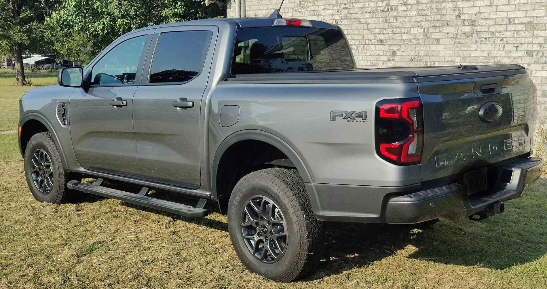

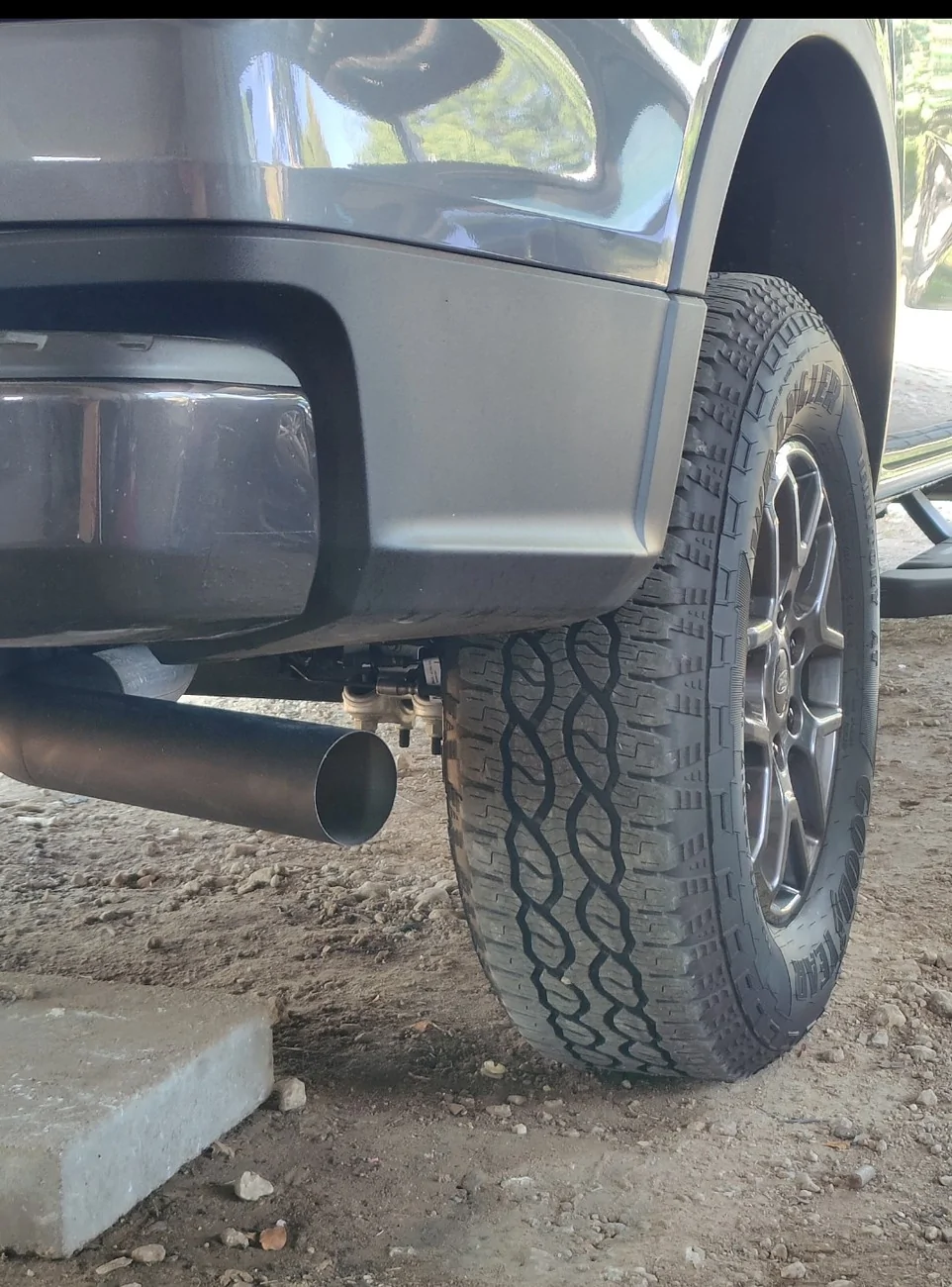

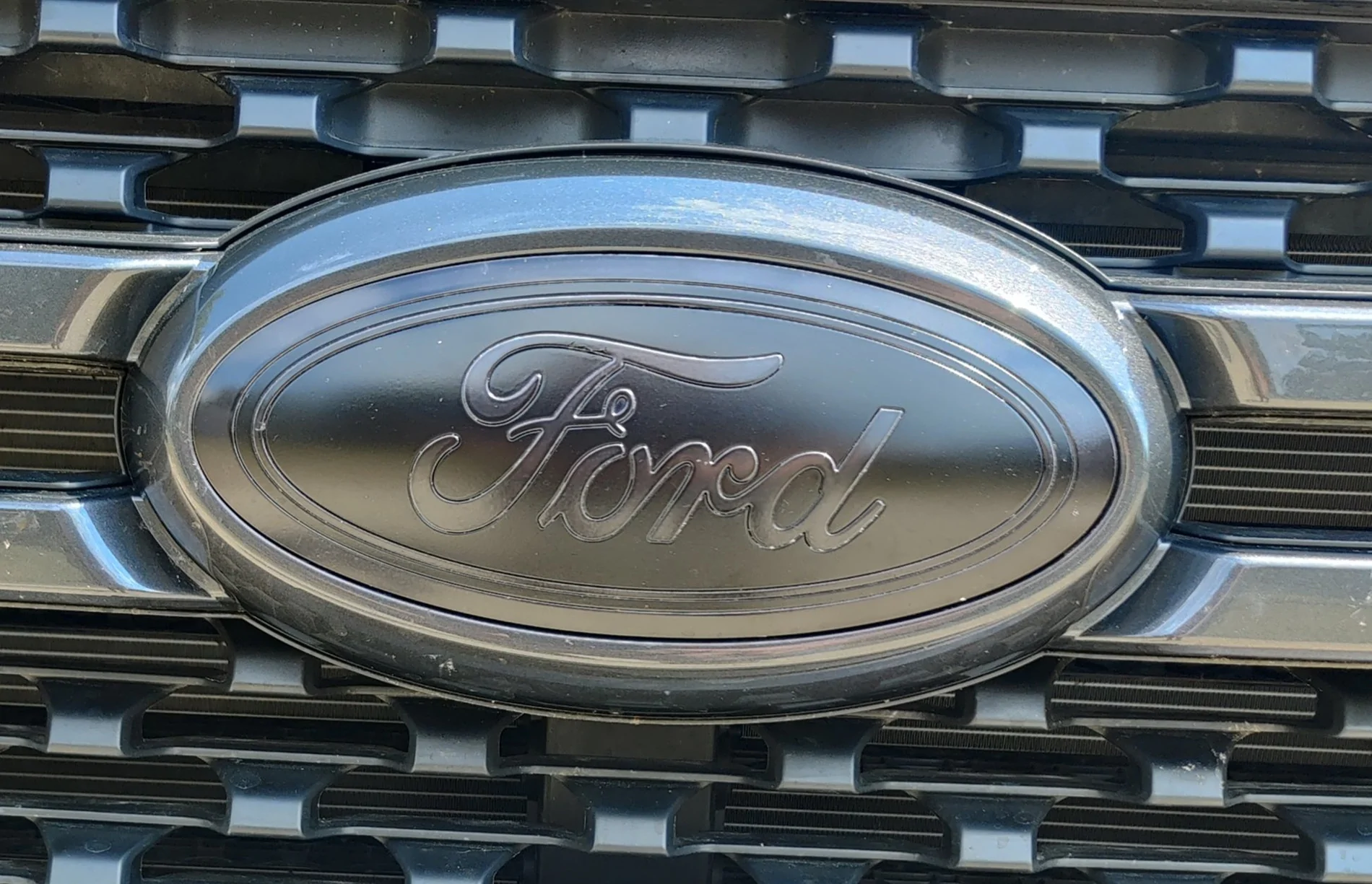

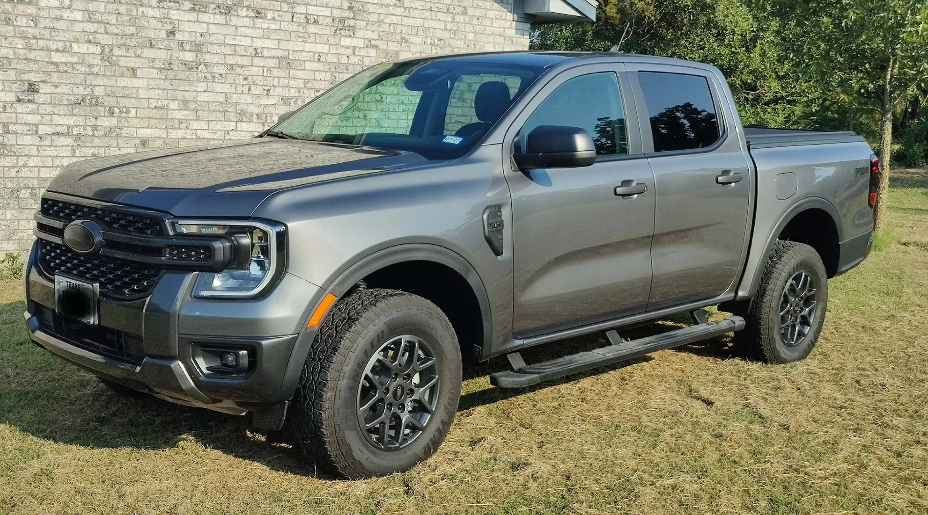

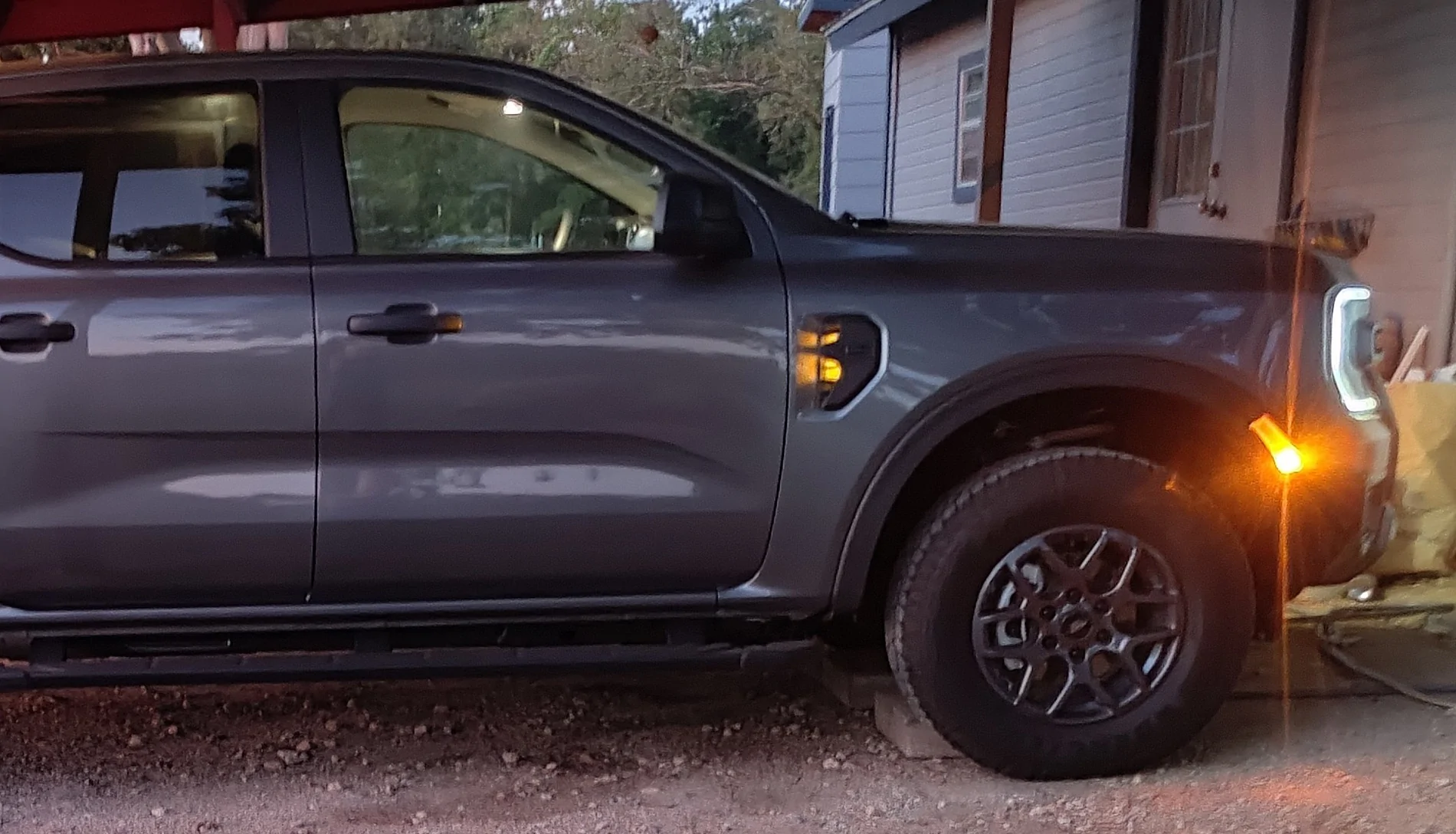

My added touches to finish out Fords blackout the way I think it should be done, at least on mine, but I'm old school! I also added side marker yellow LED's in the vented fender pieces. In bright sun can still see blackish chrome/blue in oval.
