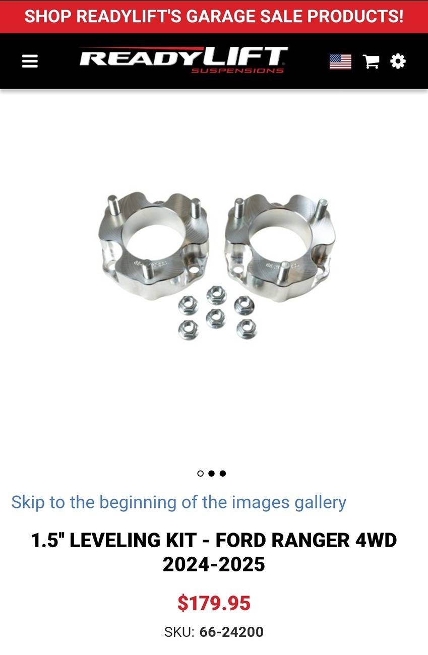

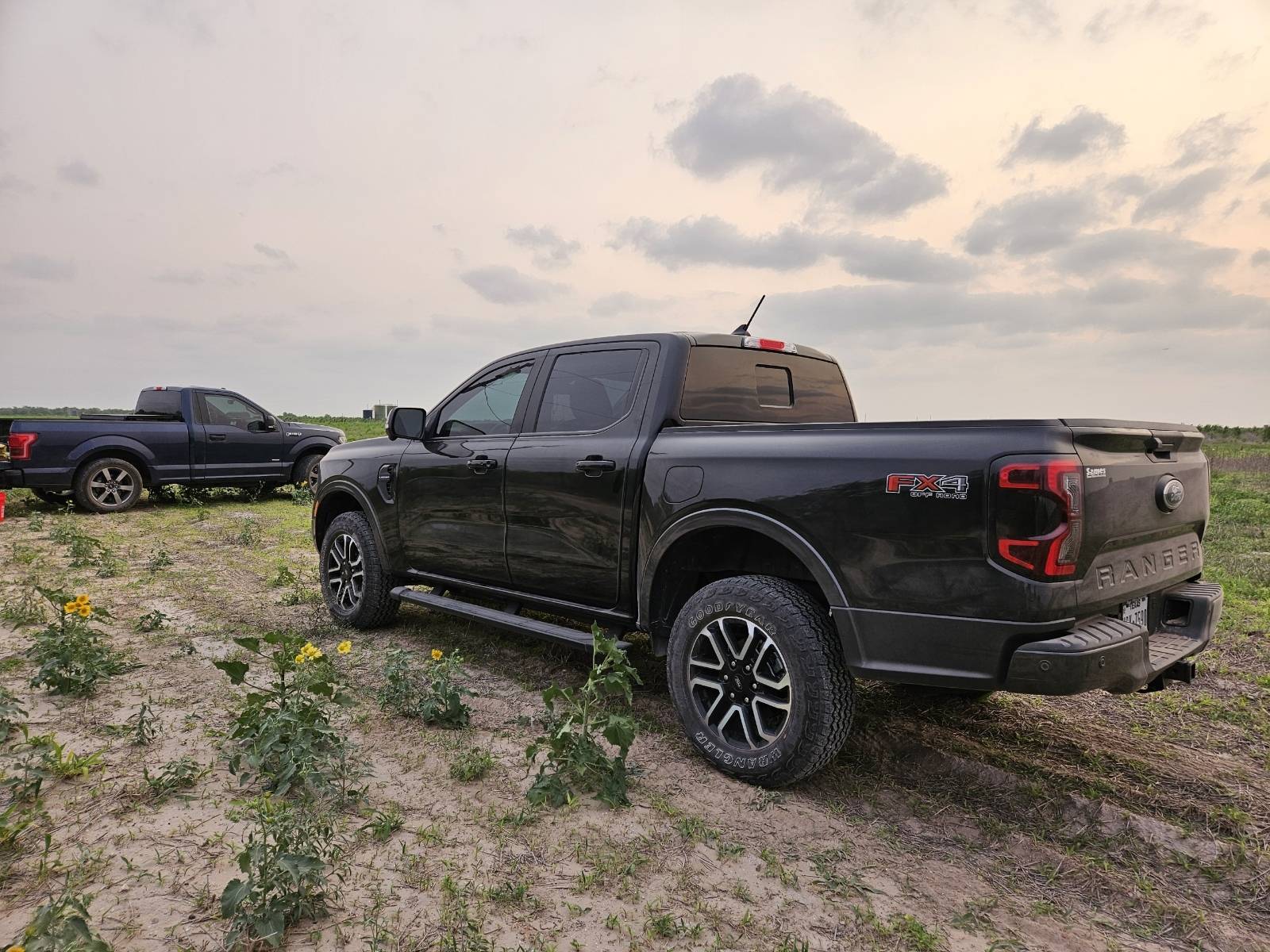

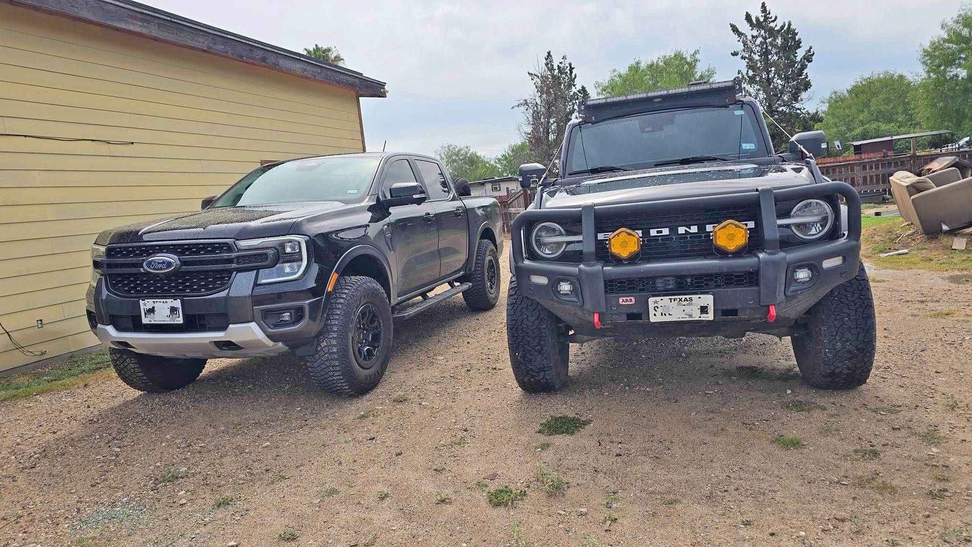

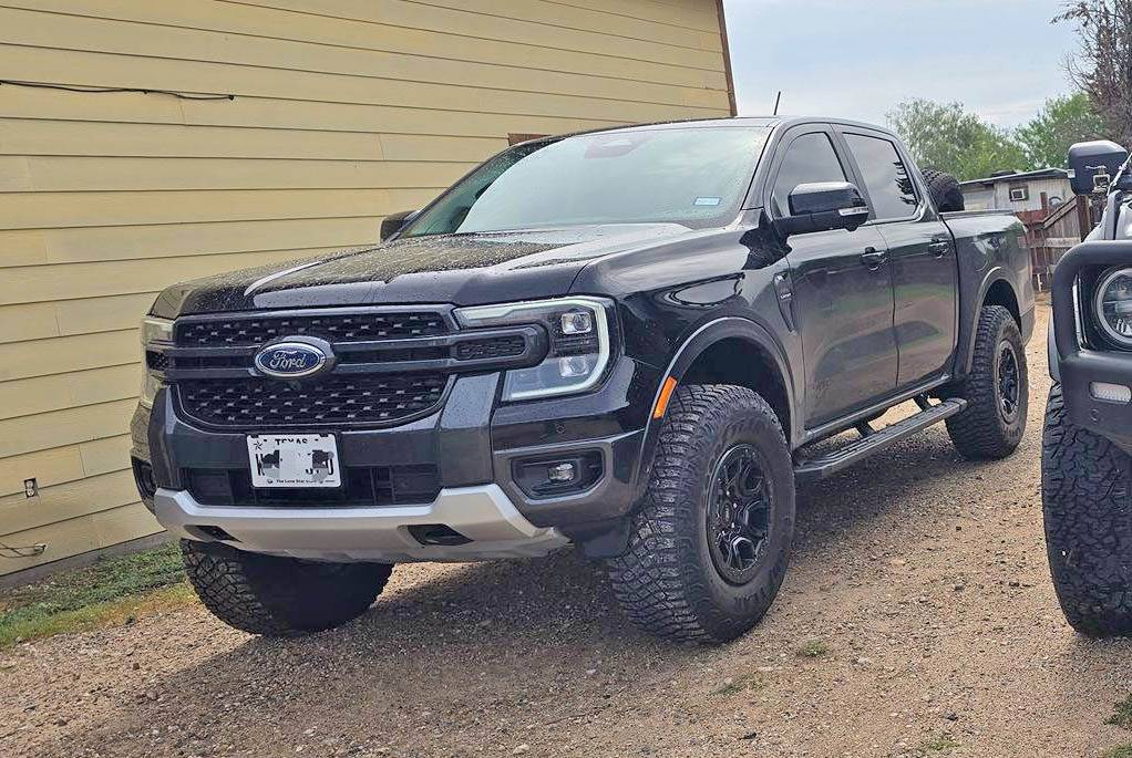

Was a doubtful set up but at the end of the day was able to install 315's on a 2024 Lariat FX4. Of course I had to trim some of the inner liner and installed the Ready lift 1.5 inch leveling kit. Took it in to our local tire shop and had them align it. So let's see how the little 2.3L should do, I don't have a doubr it'll do good due to the bronco doing the same.

I’m honestly surprised you could tuck them in with just the 1.5” leveling kit. Pretty cool. And they definitely look good. Keep us posted how it goes.

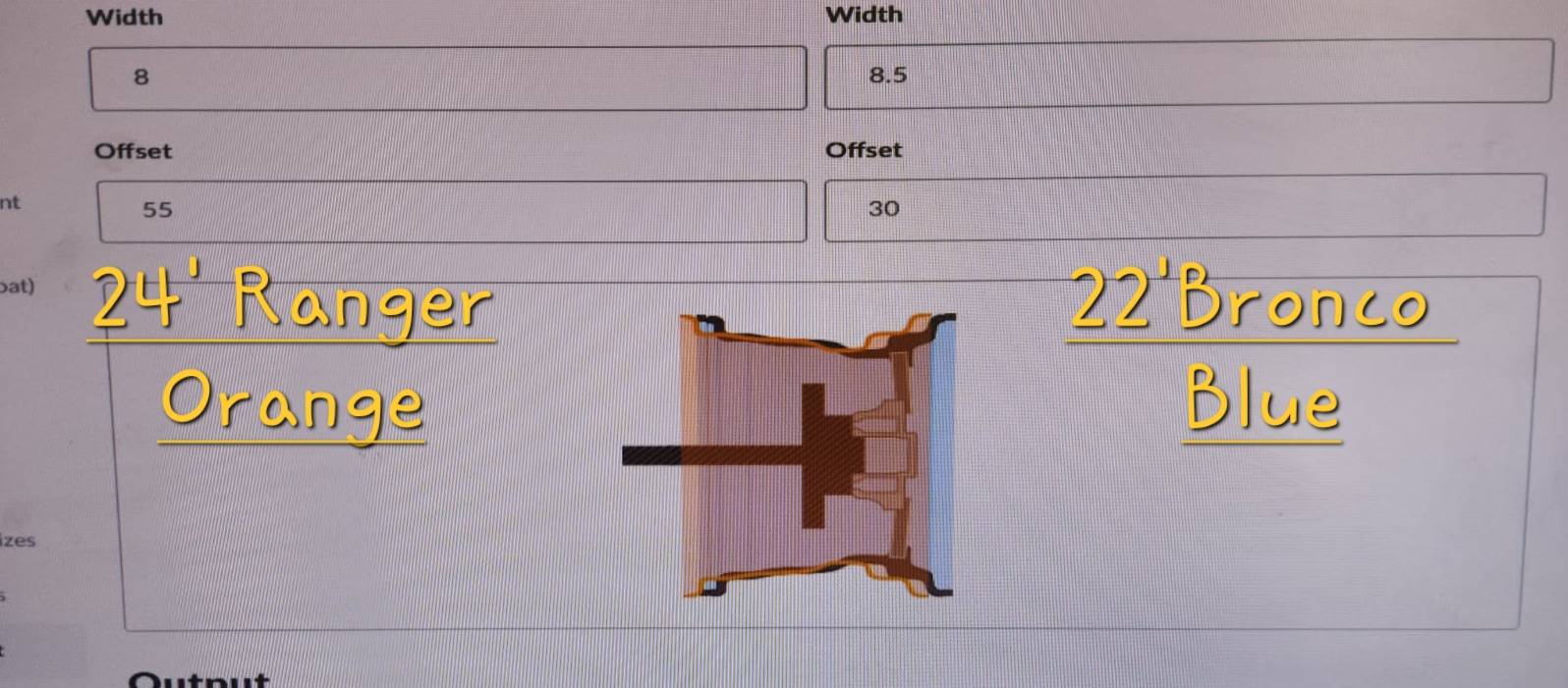

Can you give us more detailed specs on the wheel (size and offset) and tire (size)? Do you still have crash bars? Pretty shocking that these would fit.

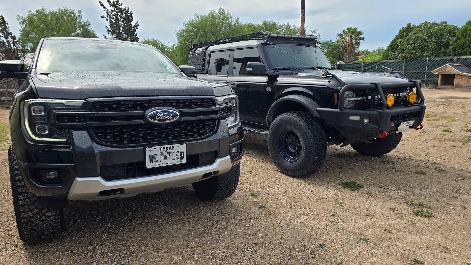

With the original 315s from 22' Wildtrak Bronco

I like that there is still a little rake.
