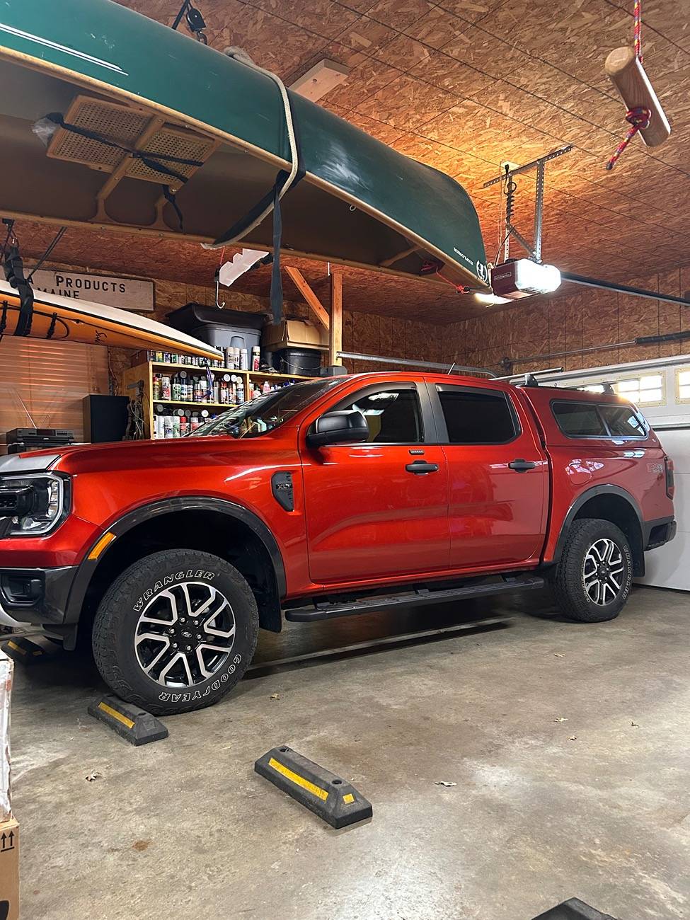

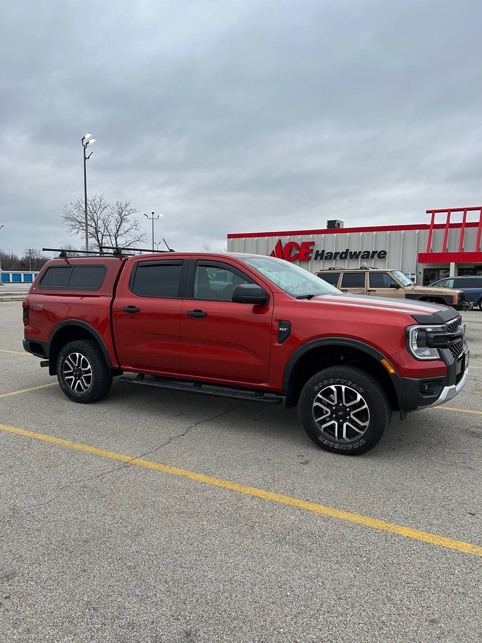

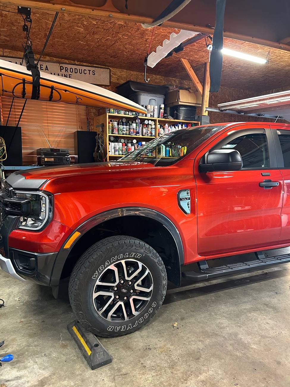

I purchased a 2024 XLT FX4 with 18 inch stock tires and wheels back in June. It has the max towing package on it with the OEM trailer brake. I had it undercoated within a month after purchasing it as I live in Illinois where road salt is a killer of anything rolling down the highway. After a lot of difficulty, I had a Ford/Leer topper installed by the local Ford dealer, then had a Rough Country 2.5 inch leveling kit added to it. Shortly after having the leveling kit installed, I noticed a rotation/rub sound coming from the front of the truck. You can hear it with the windows up between 0 and about 15 mph. Took the truck to my local dealer, and they said I had a bad drive shaft and they replaced it. It didn’t fix the problem. They then said that the boots that cover the front two drive axels had undercoating on them and that was what was making the noise. I took the truck to another Ford dealer in a small town an they said that the leveling kit has raised the truck to a point that it is putting too much stress on the axels thus making the noise. They want me to remove the leveling kit to see if the noise goes away.
So question for you all is…..has anyone had an issue with installing a Rough Country leveling kit on a 2024. Any issues with undercoating a truck……and does anyone think that the topper is adding too much weight on the back and pushing the nose of the truck up? Any thoughts you may have would be great!!!

Many thx! Any thoughts on weather the weight of the Leer/Ford topper could push it up too high?

Makes sense Alaska Steve. That is kind of what I'm thinking is going on. The weight of the topper may have pushed it over the edge. I've made an appointment at the shop where I had the spacers installed removed in early January. I'll jump back on the thread once I find out if the rotational noise goes away. I had a Rough Country coil over leveling kit on an F150 that I owned for a short time and they worked great.
