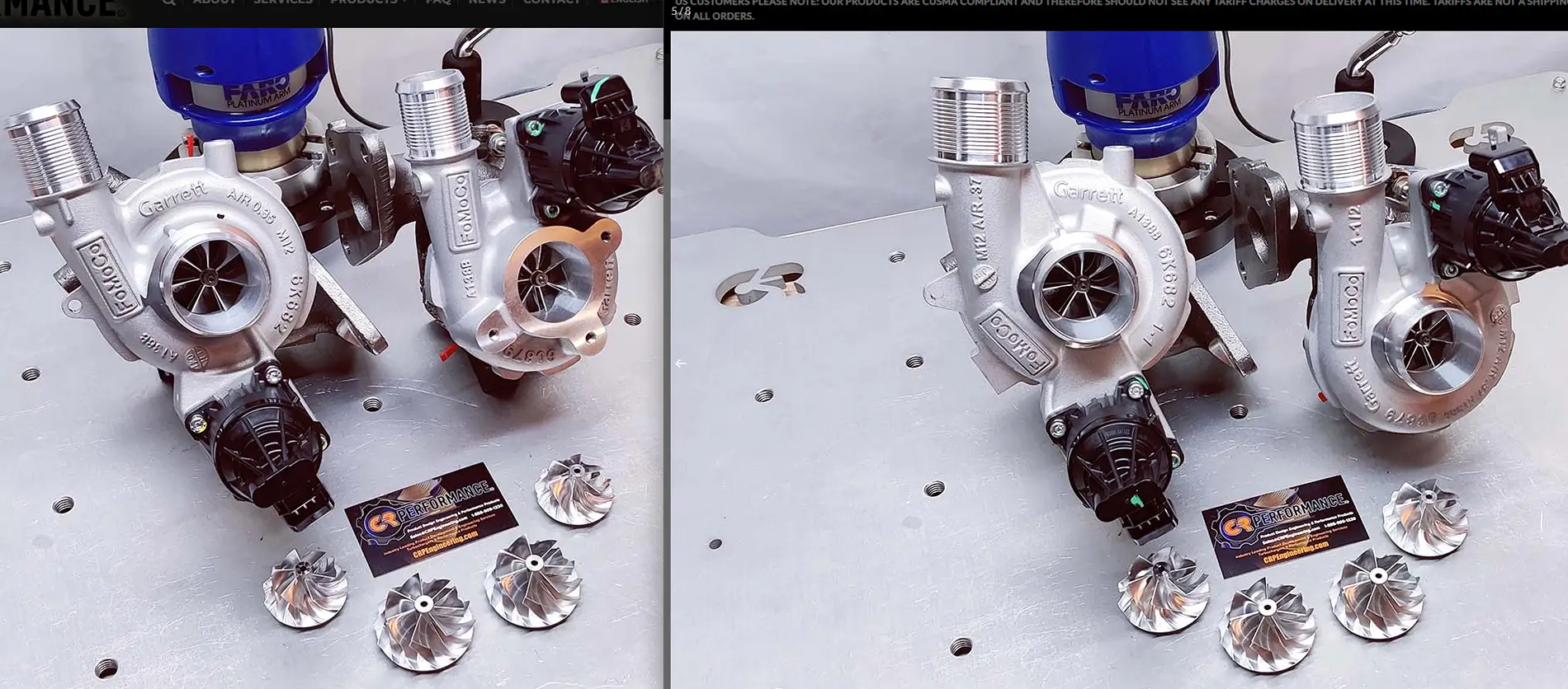

Stock Turbos modified by CRP. L 2.7, R 3.0

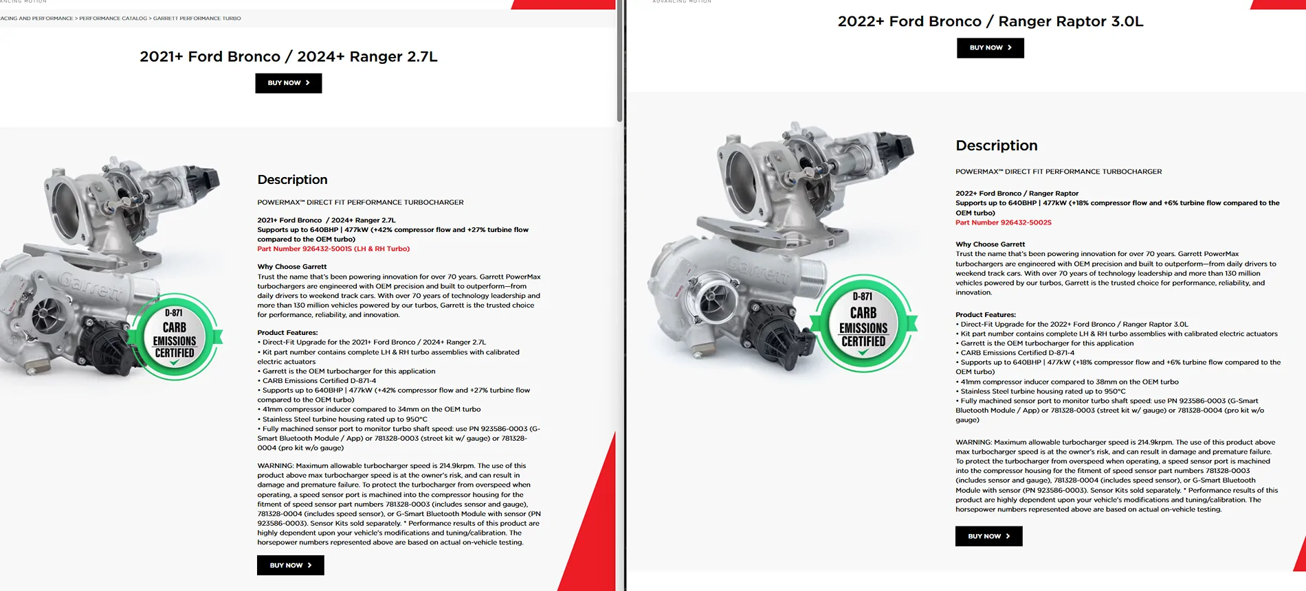

Garrett Powermax Turbos L 2.7, R 3.0

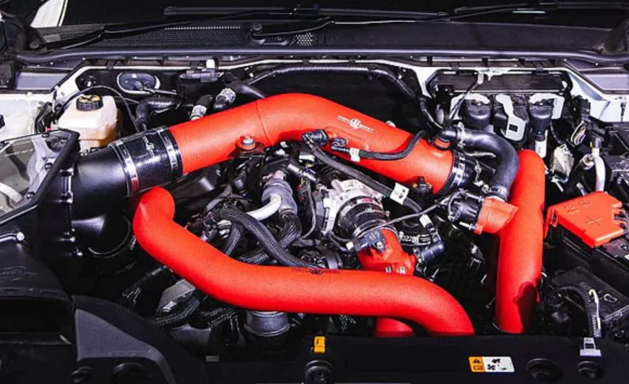

Project West Large Pipe intake and charge pipes

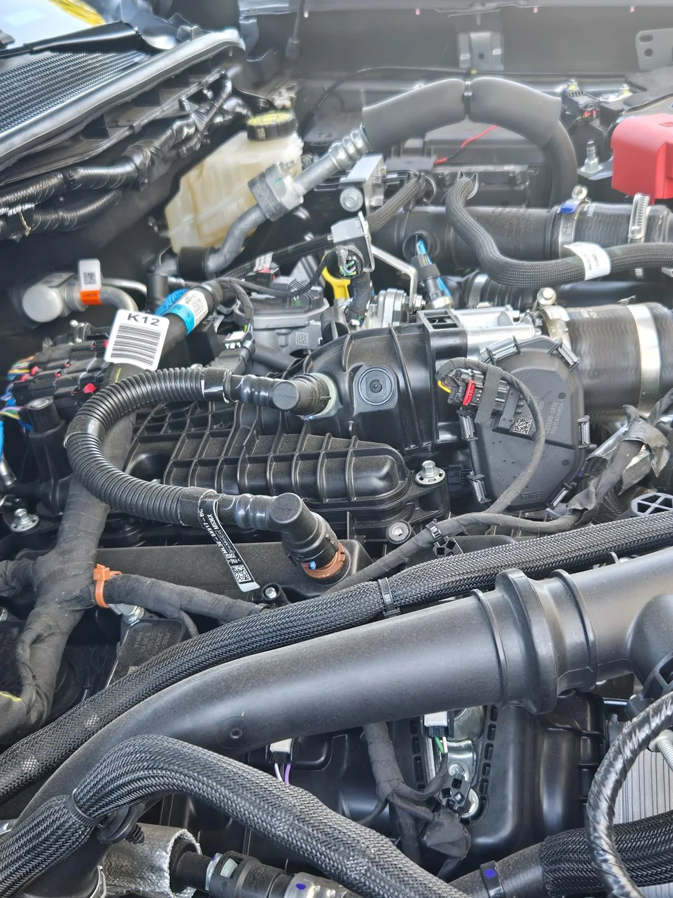

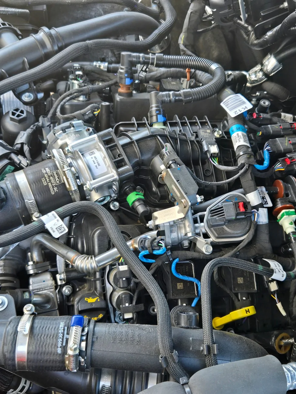

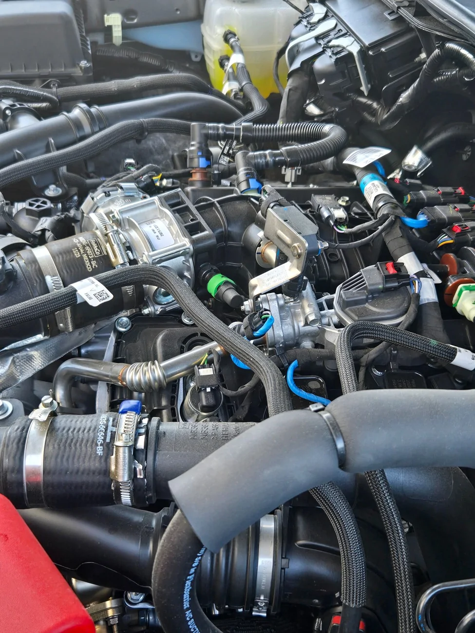

UPDATE: This is most likely not feasable or not worth the investment. After getting all the measurements needed to verify everything would fit with only slight modifications to some cable connections, tubings, etc. Everything was falling into place and everything would fit but this single solitary problem..... A most liekly unnecessary EGR system, probably added to the 2.7s in their early life to appease CA regulations. After all the 2.7 and 3.0 are basically the same damn engine with the 2.7 having slightly lower displacement, smaller turbos, and dual injection. It makes Zero sense that it requires an EGR while the 3.0 doesnt. There should be a kit to remove the damn thing but with previous EPA administration's crack down on any tampering or disabling of EGR systems I understand why there isnt.
Ford Ranger 2.7 High Power Build Theory and Plan: Big Turbo Dreaming 20251004_091331
Ford Ranger 2.7 High Power Build Theory and Plan: Big Turbo Dreaming 20251004_091334
Ford Ranger 2.7 High Power Build Theory and Plan: Big Turbo Dreaming 20251004_091349

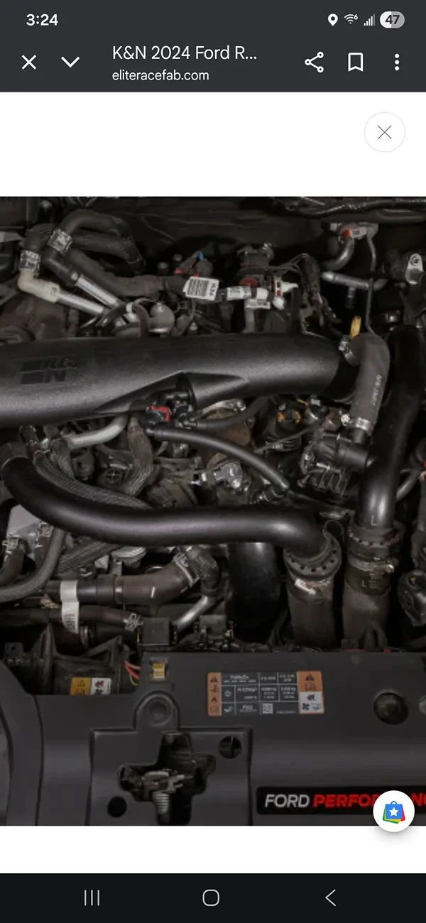

The EGR system sits directly in the path of any and every 3.0 intake crossover. I could probably make this work but messing with the EGR system isn't worth the squeeze with cost and possible engine/legal problems, and no tuner would tune out the EGR as that could result in huge consequences from the EPA. The closest I came was ordering the K&N Raptor intake as its the only one that could possibly squeeze through with some slight modification to that EGR bracket and lowe system, but then the whole tube would be severely close to the EGR system and in danger of melting.
