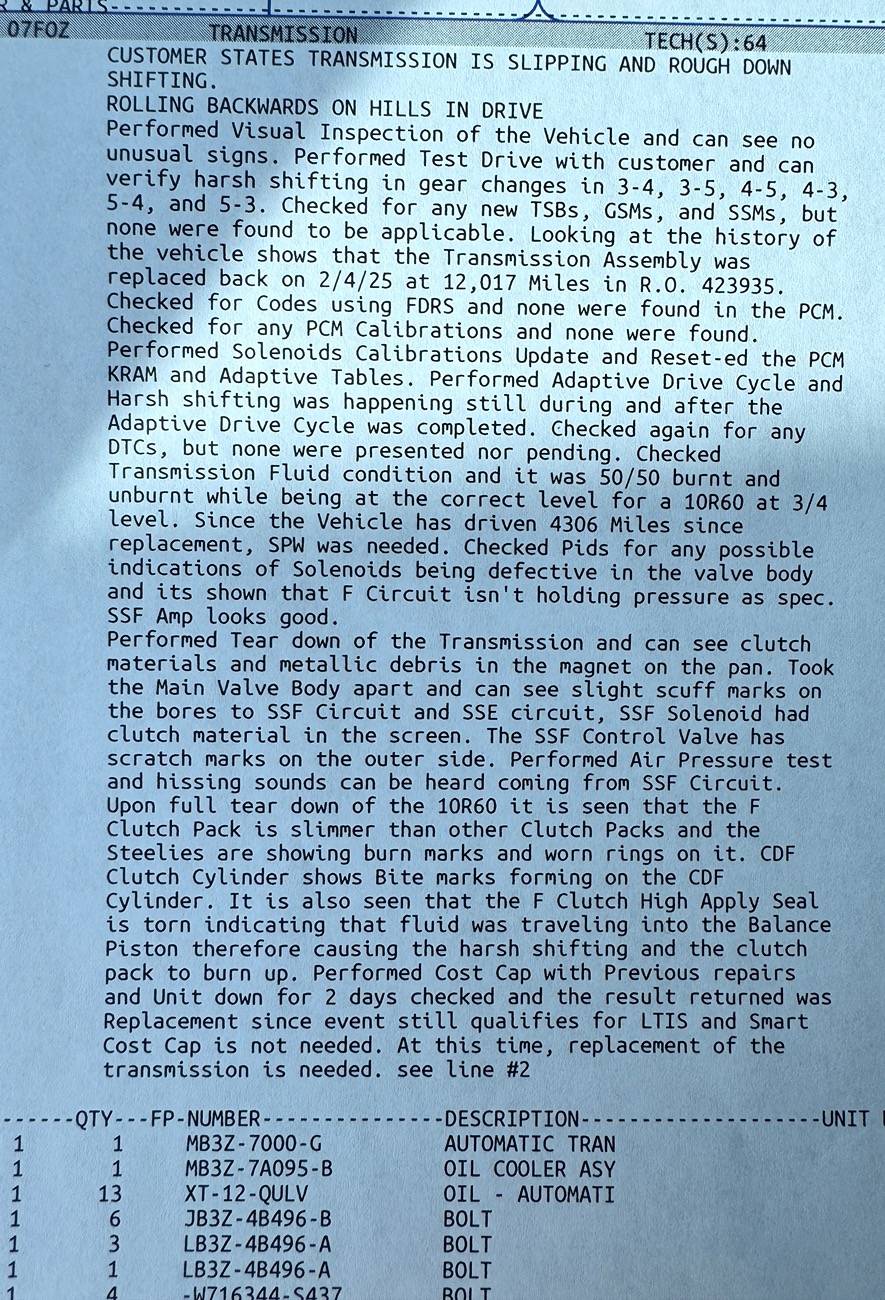

24 XLT 2nd transmission 12K, 3rd transmission 18k issue breakdown for reference

Have to say as frustrating, and disapointing as this is in a brand new truck my local Ford dealer service department has been awesome with troubleshooting and then replacing both transmissions and returning my truck on the 3 rd day...
Ford Ranger 24 XLT 2nd transmission 12K, 3rd transmission 18k issue breakdown for reference IMG_4898

Posting more for information if others are having transmission issues than to bitch about it... Happy with the truck otherwise....
