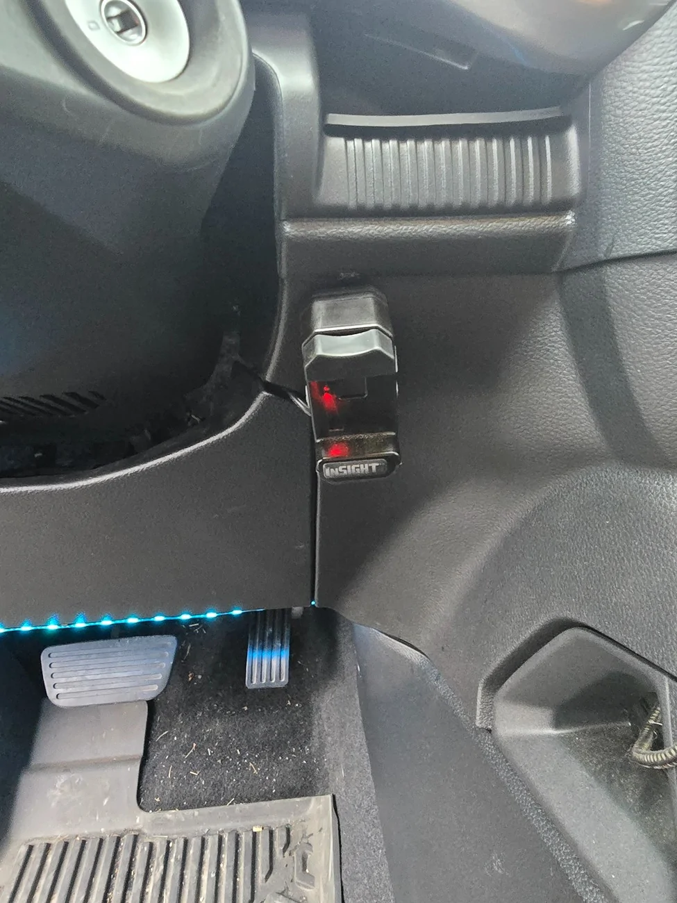

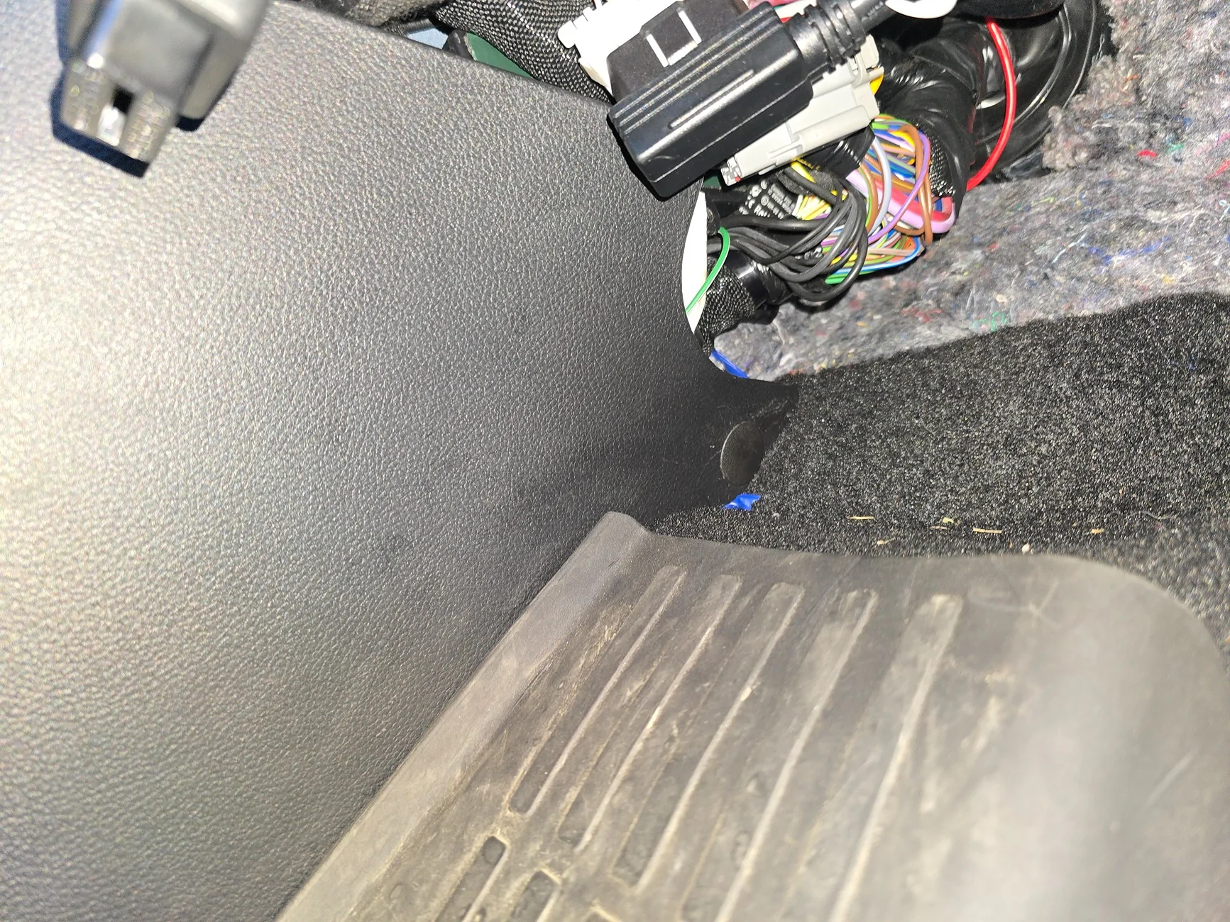

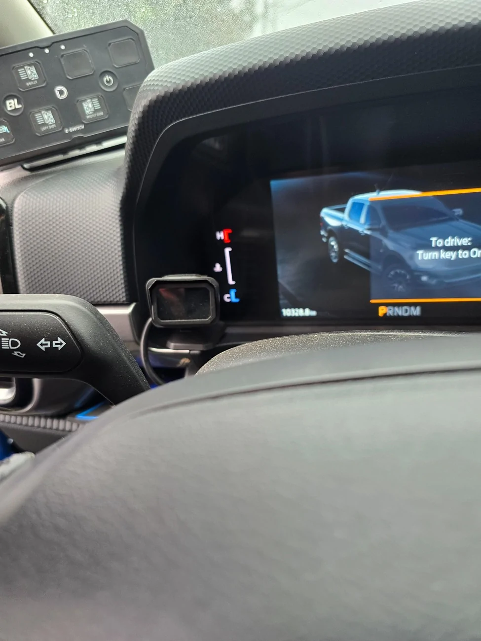

The display is on the dash next to cluster. double sided tape. same with the gain/spike. nd the brain box of the tbc is behind the kick panel near the plug, you have to mount it in a specific orientation as it is also an inertia controller. if the truck suddenly starts decelerating, it will start applying the trailer brakes lightly so the brake lights come on. it is also compatible with the forward collision emergency braking.
