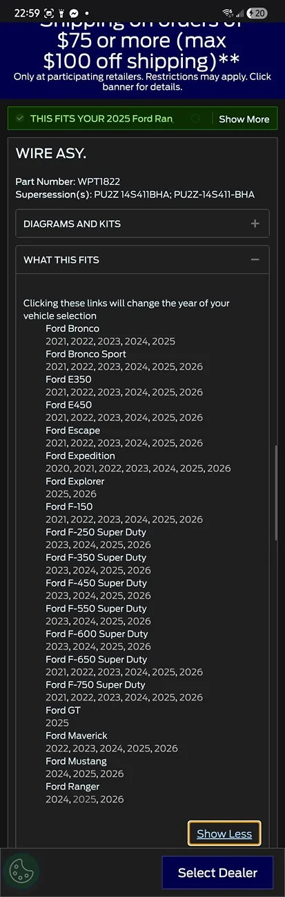

the plug end is WPT-1822 and it is STUPID expensive. the newest ford in my local parts u pick to walk in myself is a 2019. they had a 22 a month ago, and thr day I went in, the day it went to crusher ffs. they cleared out that row. thats what I was gunna do, get junkyard switch and switch plug. so just waiting. the other junk yards around me, you cant go in and get your own parts.
Do you know any of the details of the WPT-1822 plug? it's not shown in that ridiculously expensive Ford part. I found a connector company that might sell only the connector that we could wire ourselves. If I had a picture of the connector face I could see if they could get it.

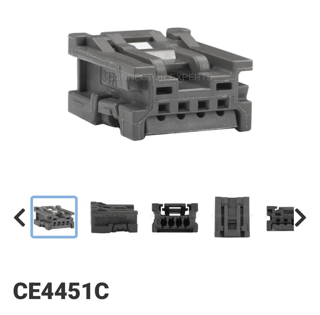

Okay I think this is the connector, but even from the company I found it from it’s still $88! I hate that 8” of wire on a connector costs as much as a circuit board backlit dash switch. https://connectorexperts.com/i-31648336-ce4451c.html
and yupp. its like 280USD or 360CAD from.ford online. and thats why my plan atm is to wait till a rig with the tbc switch gets put into my local upick, so I can grab switch, and cut the plug off. and then wire it in to test, if it works, then buy a new switch and the dash trim piece for the truck, and run the custom harness.

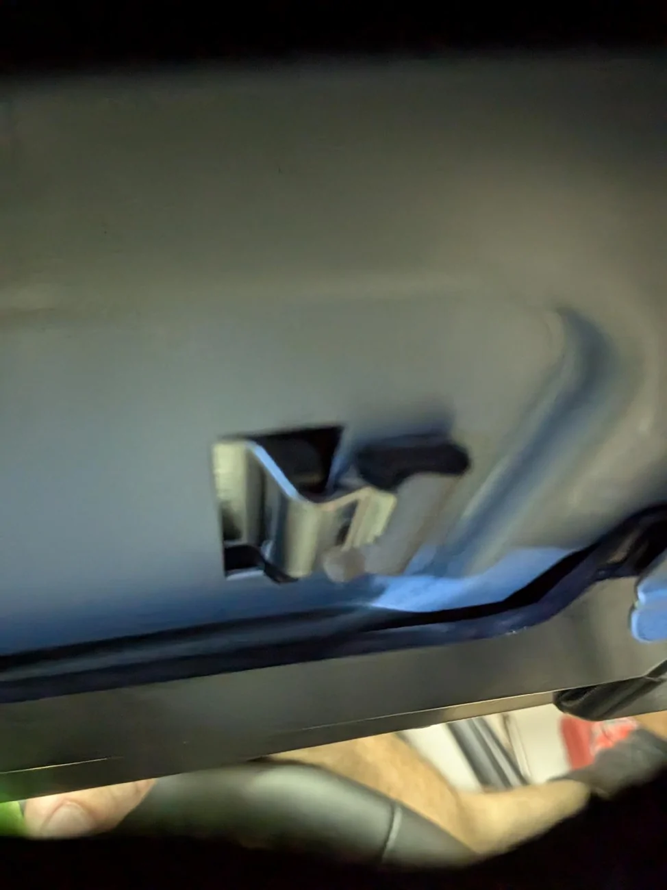

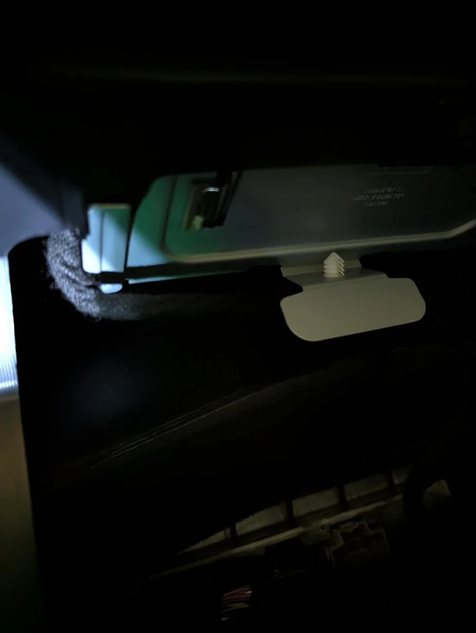

also the plug is in these rigs in different places
