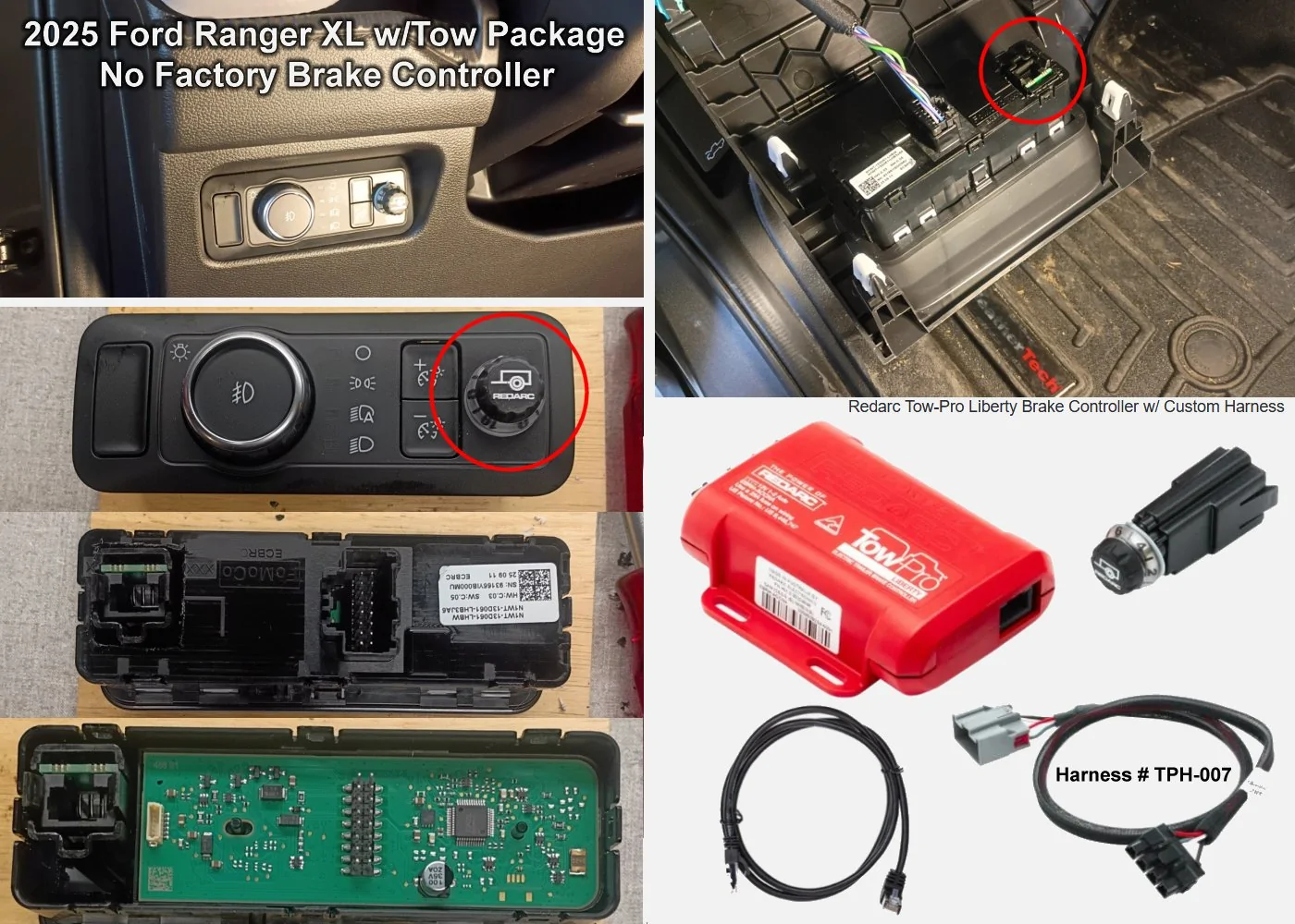

Optional location for the Redarc control on my '25 ranger.
