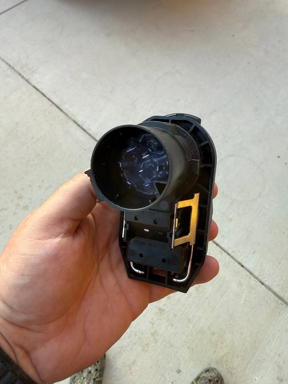

Picked up my combo 7 and 4-pin - Trailer Tow Harness Connector Lamp Socket MU5Z14489C
and Instrument Panel Molding N1WZ26046A63LA this weekend and I learned the connector socket is powered/controlled by a single USCAR socket and obviously splits off/passes-through to the 4-pin.
So I hopped on amazon and ordered one
https://www.amazon.com/dp/B0B1ZF56Y2
It's very affordable compared to Fords OEM component for repair (splicing required - So not plug and play).
Trailer Tow Side Connector Wire
SKU: WPT1659 (3U2Z14S411JXC)
Not wanting to splice, crimp or solder (I can, I just want too, and avoid it if I can), I began looking for a connector that I can splice, crimp or solder on to the pigtail I ordered and avoid cutting into the factory wire harness... The idea being it can be unplugged and returned to Factory Condition.

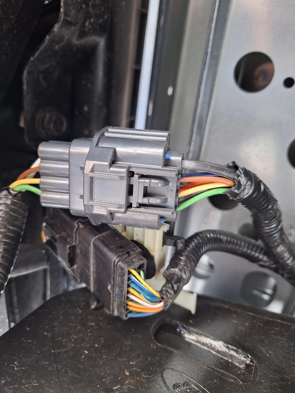

This is what I have under the bumper. O don't have any tow package, but it looks like all the wires are there. It's the gray connector. Right side is from main bumper harness, left side is to 4 pin connector.
That's promising! Thanks for that tid-bit about the connector; I'll have to take a closer look next time I get under there!
