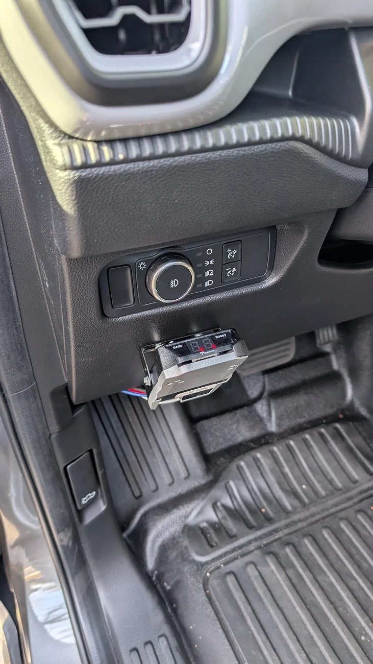

I just installed the TBC setup above. Installation was super easy. Everything seems to check out. When connected to my travel trailer, the trailer light check is good. And when I press the brakes the TBC shows power output.

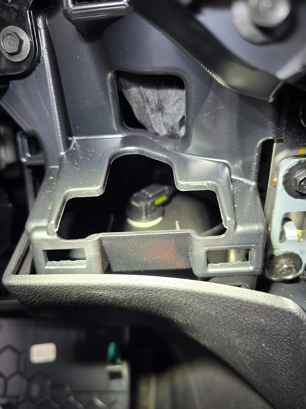

So did you hit a dead end with Ford on this?

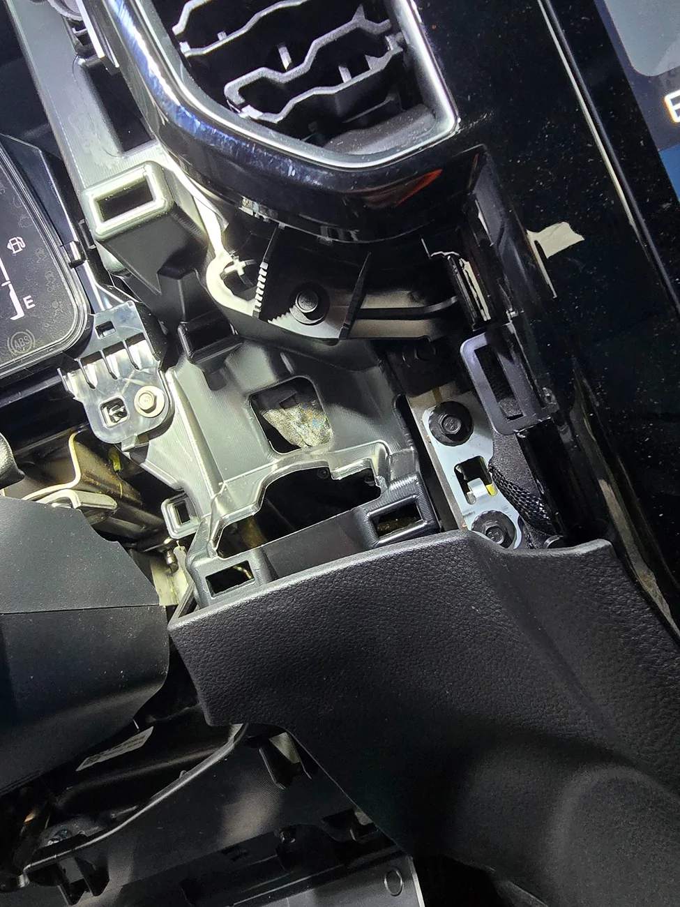

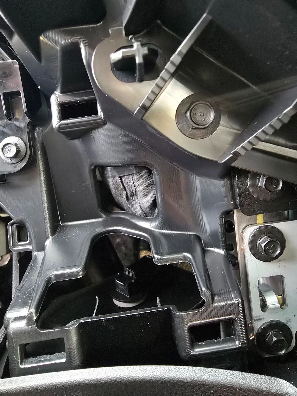

My STX did not have it zip by the firewall. It was placed behind the plastic kick panel. This plug needs the trailer brake module to plug into. Then there is a wire that plugs into the module that is fed to the gain module that is installed beside the steering wheel in a corresponding bezel.
I'm planning on going to my dealership today because when I ordered my STX, there was no option to purchase the trailer brake controller. Now, when I go to the ford.ca website, I can order a STX with a trailer brake if you order it with a tow package. So I'm going to get them to order the parts needed. This should include a module with mount bracket, hardware for bracket, wire to gain controller, and gain controller with bezel.
Pretty much...they are just saying that's the way Ford is slowing you to order now. I tried to order the bronco kit which is basically a redarc elite kit with the pigtail but that kit is now obsolete from Ford. I will end up just ordering the REDARC kit from Amazon with the pigtail.

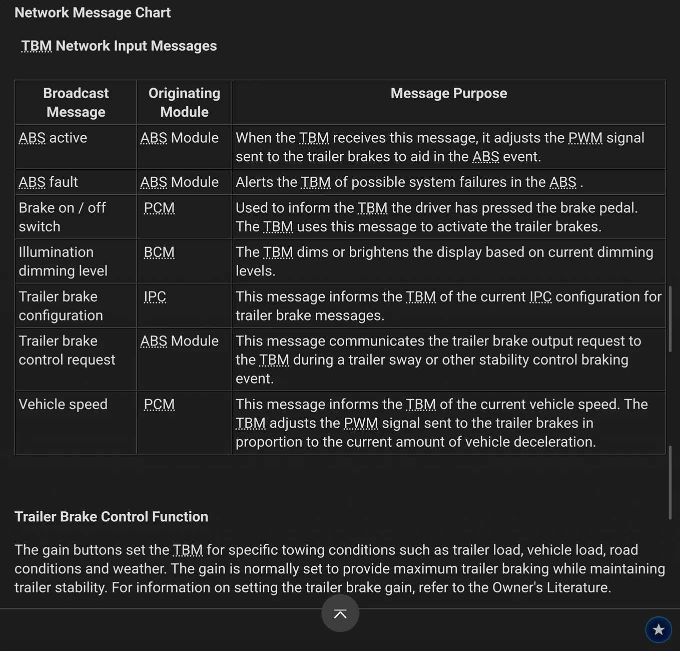

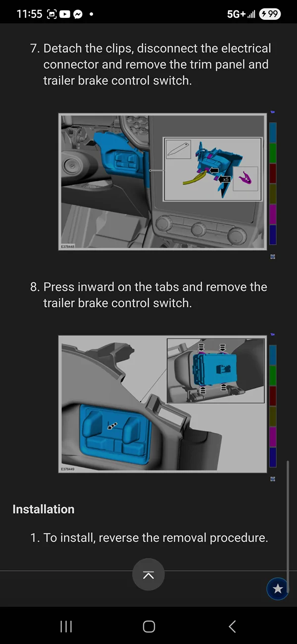

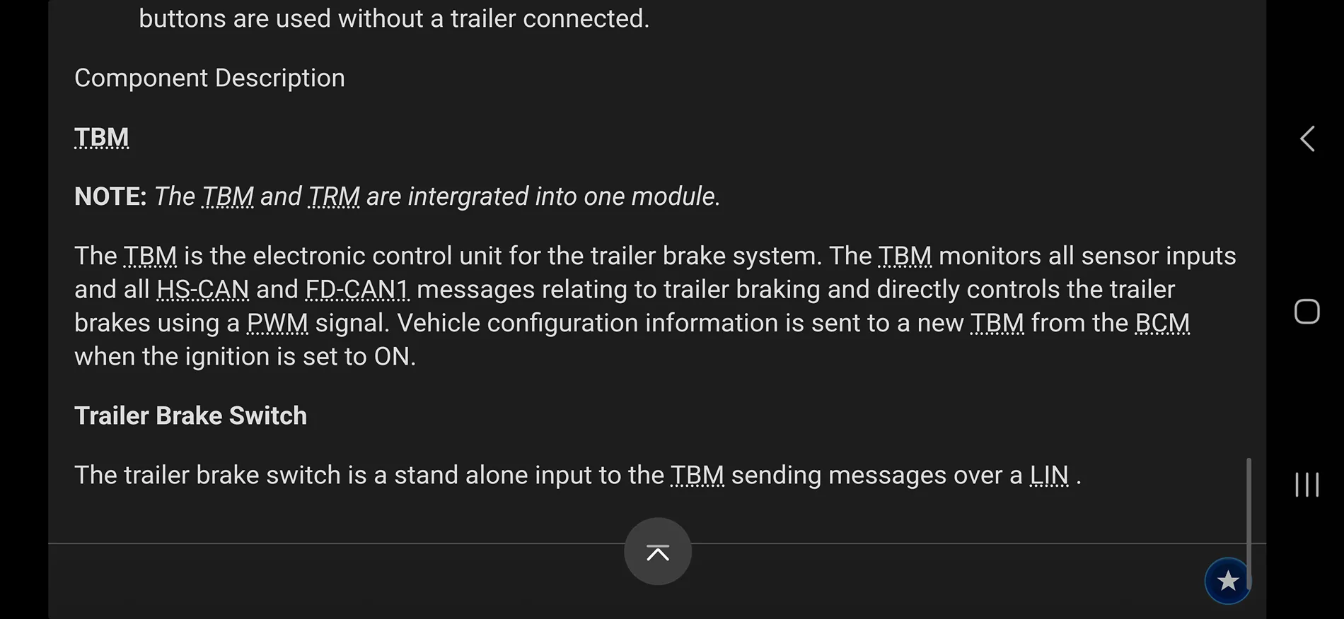

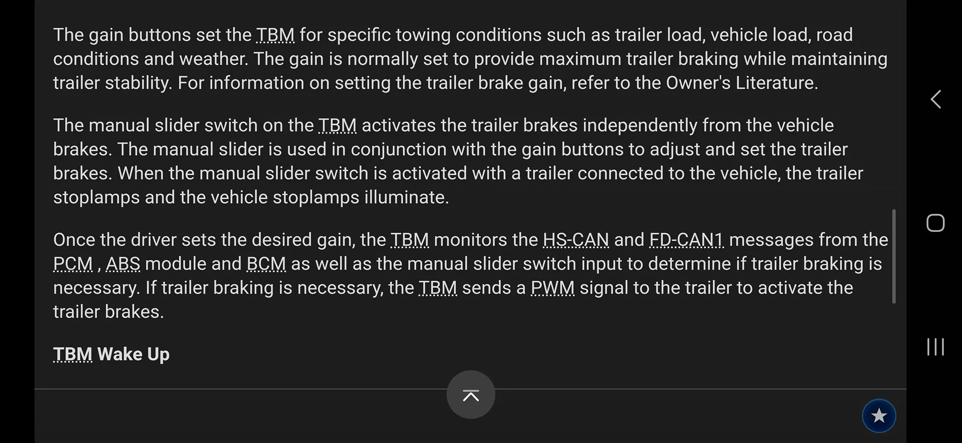

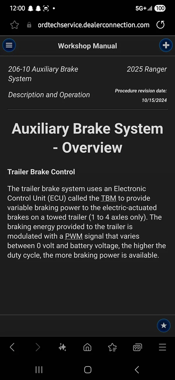

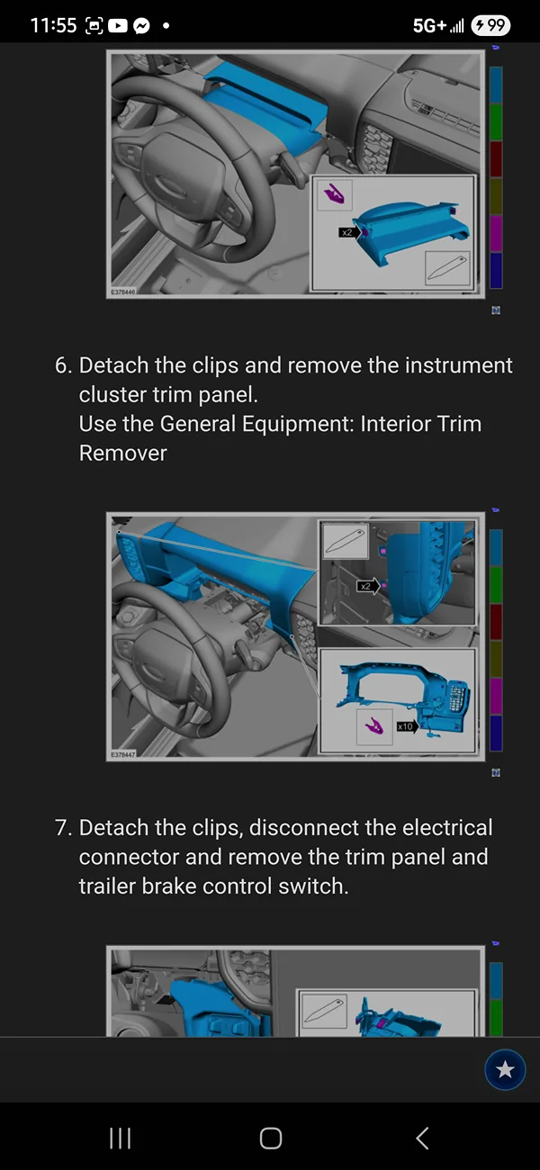

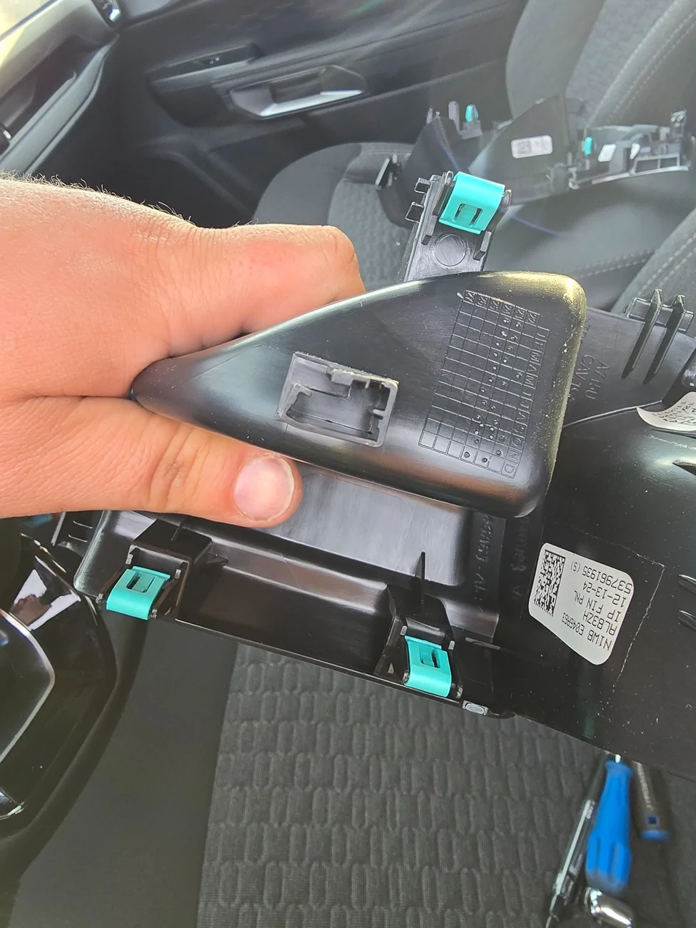

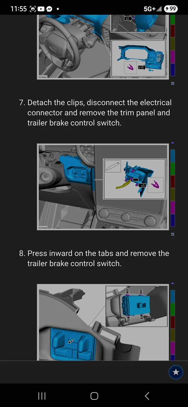

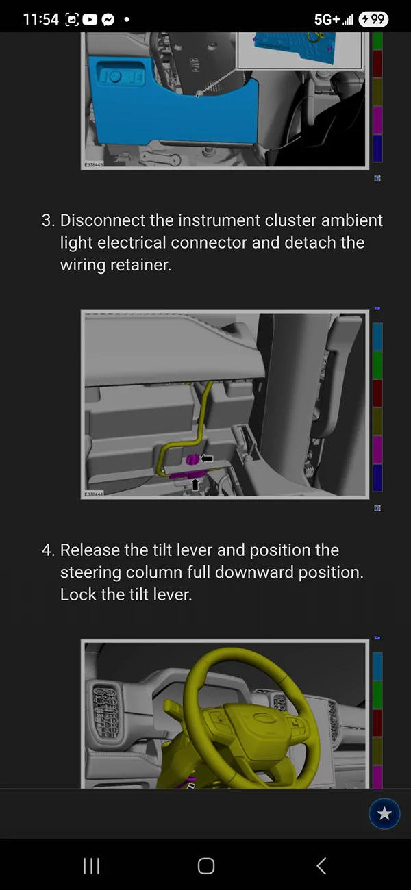

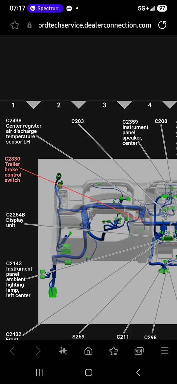

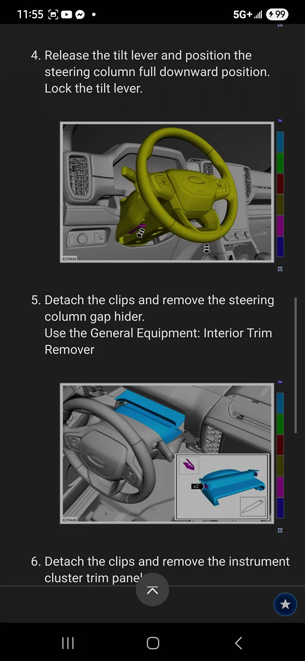

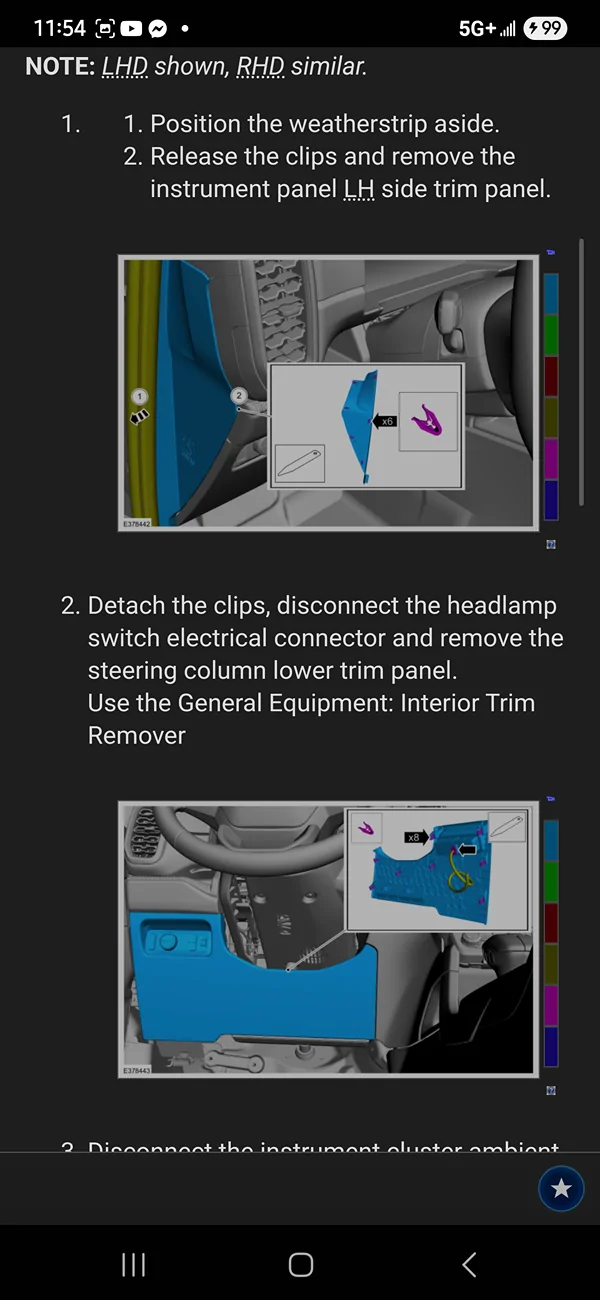

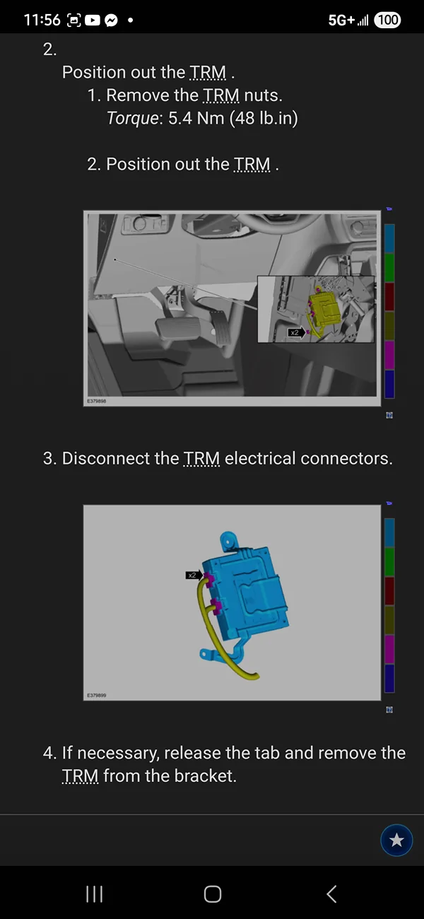

Thats what I was told too. but when I bought the 72hr access to the ford service manuals and stuff. and Entered my vin for the stuff related to my truck, the wiring diagrams show the connector should be on the harness. I was also told my truck was not wired for heated mirrors/mirror turn signals/the puddle lights... yet my truck is prewired to the mirror plug for all. I circled the heated mirror wire. so Im hoping its in the dash. I did have the dash apart, but theres no room to get at the harness to see if its tapped to the main harness. when I get time, I want to haul the radio out to get better access.
The TRM and the TBM are the one unit, per the ford service manuals. so if we got the ITBC plug, we can enable the options to activate it

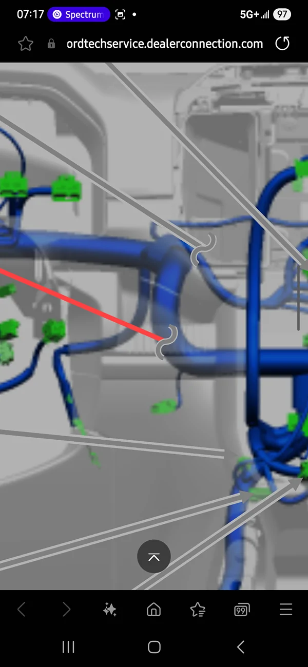

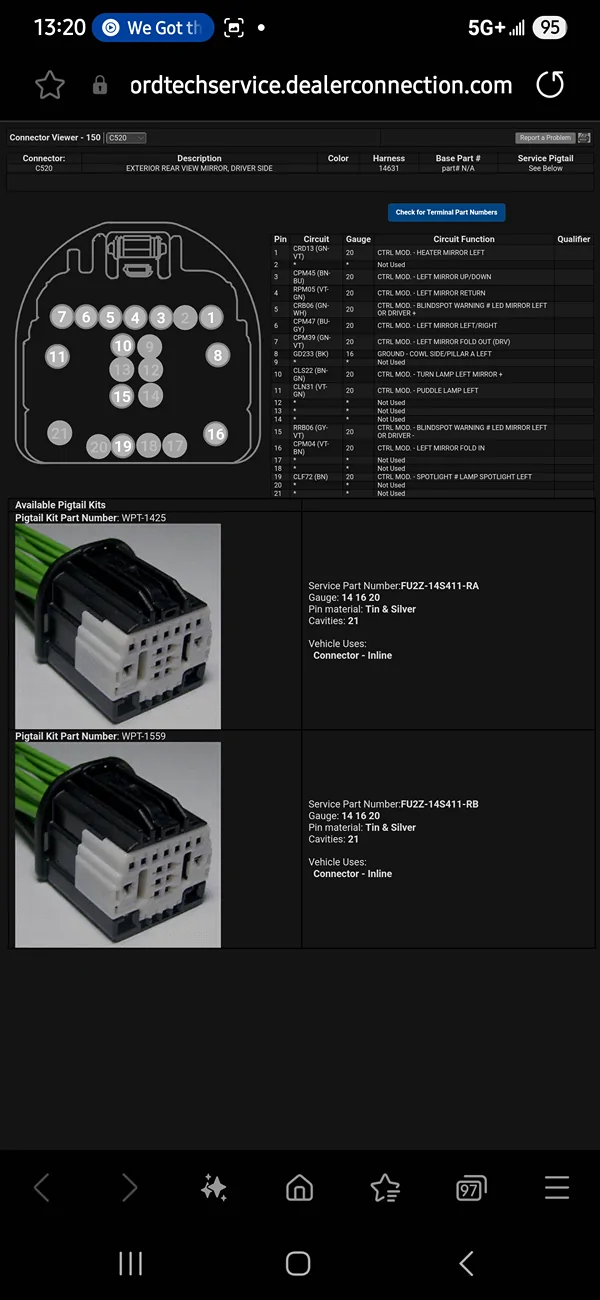

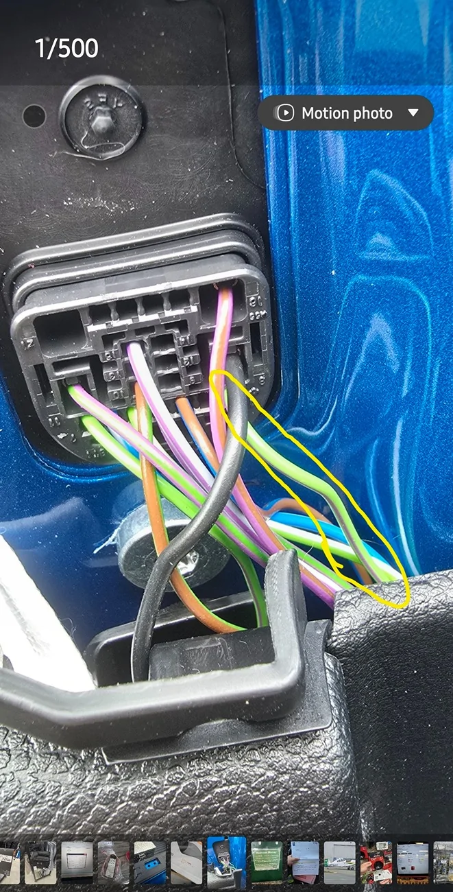

If it's taped in that bundle, it might be as easy as the f-150s. My dealership told me the same thing that the wires should be there. When I reached behind the dash, I couldn't feel the connector in the bundle of taped wires.
When looking up by VIN it should show what harness should be installed on the truck. Ford has been always known to do weird things when building vehicles. Keep us posted. Maybe I missed it too.
ShadowDragon24
Apr 20, 2025
665
621
2025 Ranger XLT Fx4
Heavy Equipment Operator
Thats the hope. in the meantime Im using a hopkins tbc, and works flawlessly. but I rather the ITBC, and thrn have the hopkins as a back up. the main "brain box" is behind driver side kick panel next to the trm, and the gain display and the gain/spike are remote mounts
