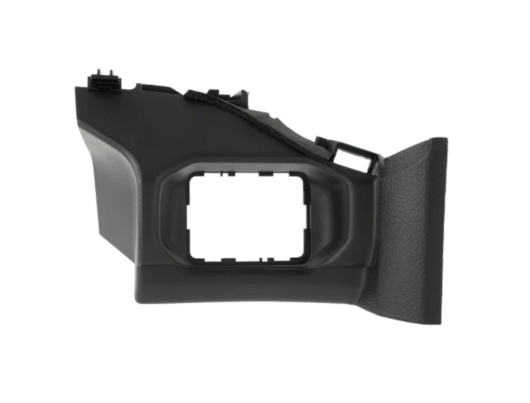

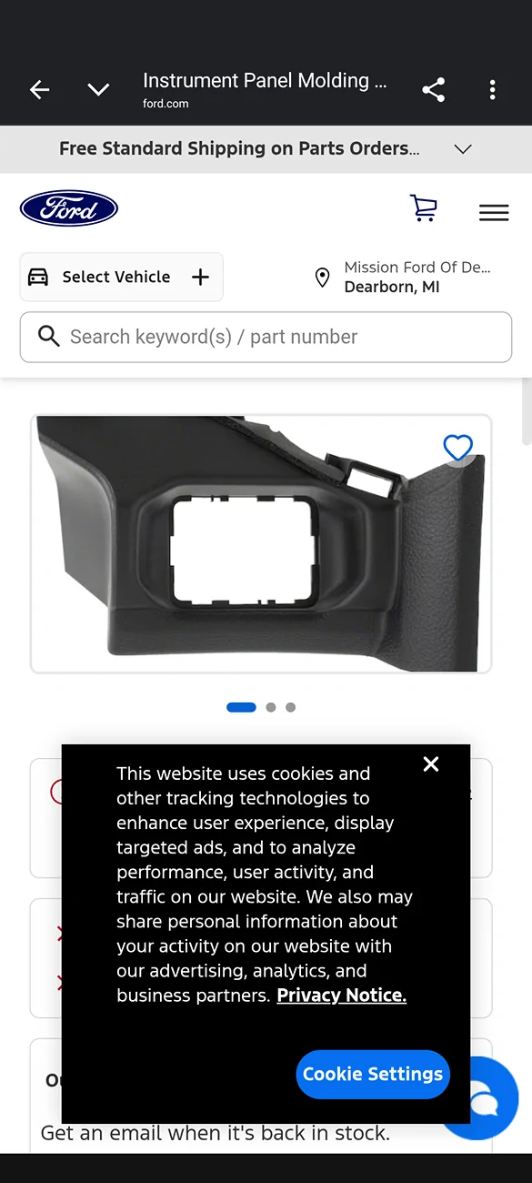

My OCD is racking my brain but this solution might be the ticket. I might use the factory bezel where the factory tbc would go and order the plug from the super duty ranger. That way it is an easy access to do a redarc knob repair or service in the future.

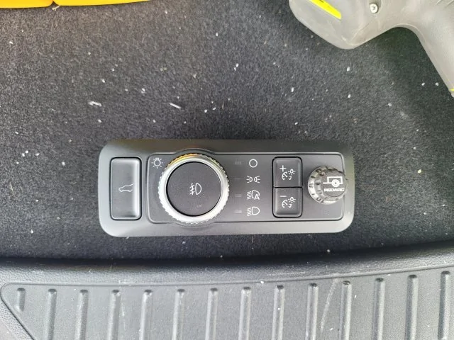

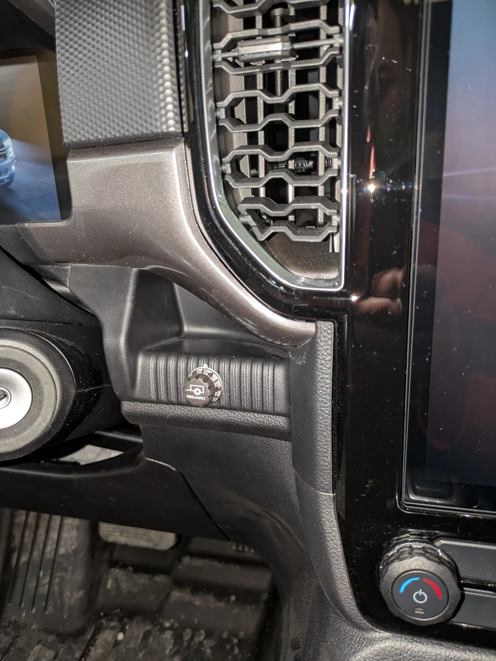

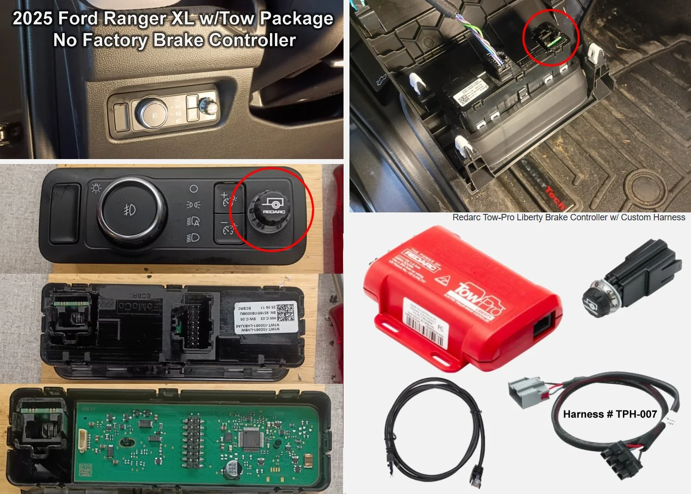

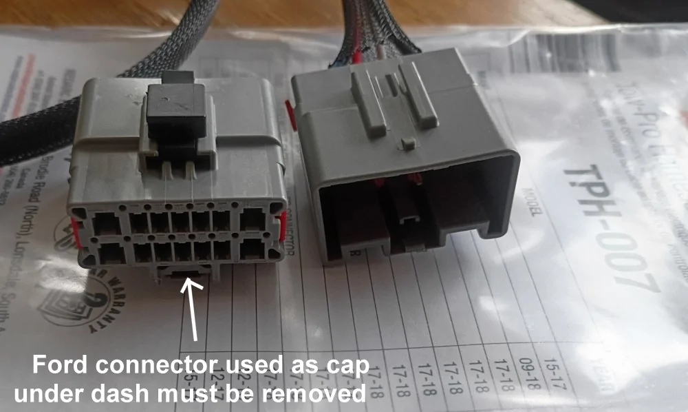

Not sure what your problem is.
The 2025 4x4 XL/STX has a plug in connection for the brake controller. I installed a Redarc myself. Plugged right in. Couldn't be easier. I even mounted the control knob next to the headlight controls but you can just stick it through the kick panel also.
Ford Ranger Trailer brake controller installation ideas. Brake-Controller-Installation
Ford Ranger Trailer brake controller installation ideas. Brack Controller Connector ca
