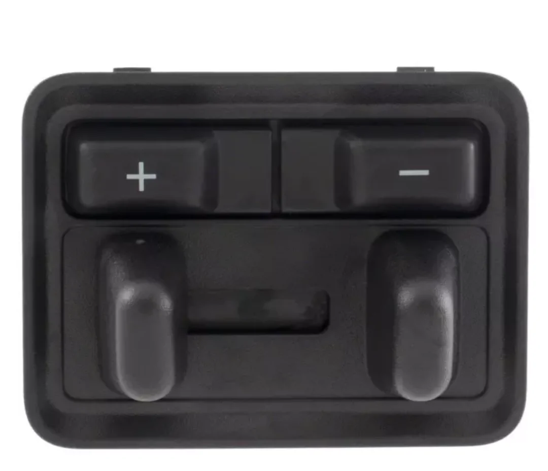

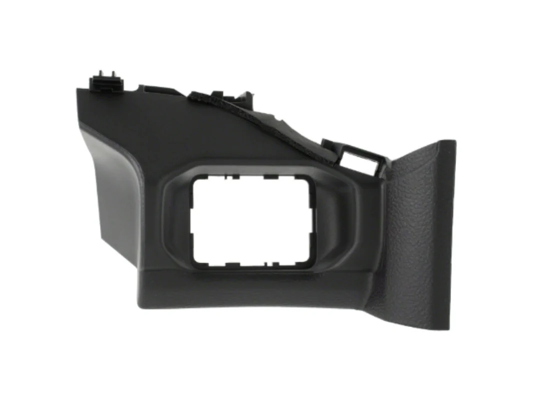

I have found these parts that are available. They are the cheapest. Unfortunately, the dash wire harness has 2 different part numbers along with different trailer brake modules with or without TBC. I wish ford would have just used one harness with the wires ready behind the bezel. With the trailer brake factory order now, t's only an extra $350 if you order a 2025 ranger with tow package.
DesertSand Would you still have those part numbers written down some where?
