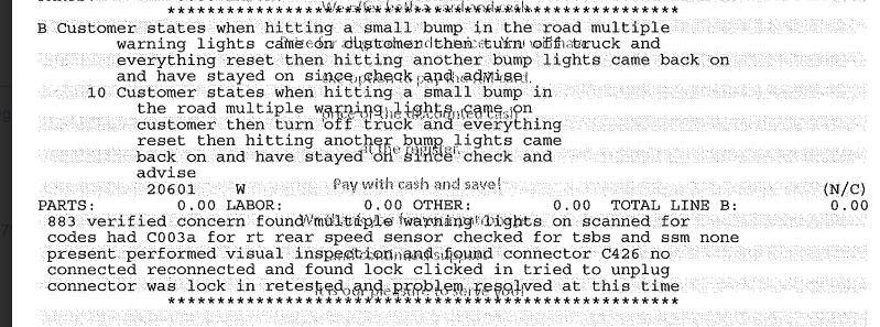

Update, Raptor is back in action. The issue was some kind of traction sensor near the rear end was not fully latched from the factory and it came loose. The tech said he pushed it back in and it snapped back into place. Crisis averted.

From the work order:
Ford Ranger 25 Ranger Raptor all sensors failing at once 1751563381594-ff
