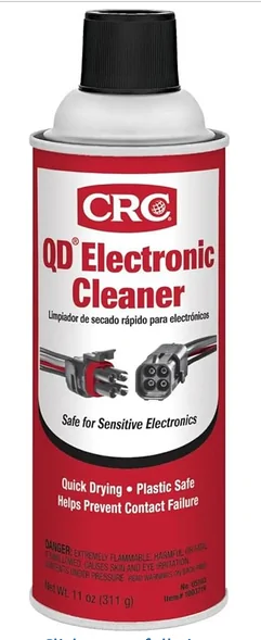

Give this a try. I have fixed many electrical issues on these newer vehicles like you state the dealers are lost on. Not just Fords. I don't know what their thinking but I have seen so much over use of "dielectric grease" I've been around that stuff for many years. It's great if used correctly but today they slather that crap all over inside a connections and cause problems. It is Not suppose to come in contact with the metal pin connecting surface (No matter what they say). It is to seal the connector at the sealing joint, plug in. Read the first three letters of Dielectric over and over! That's what it does. When it gets on the pin connectors it can cause resistance issues in the signal of the connection. Get some special electrical connection cleaner. Clean the connector and what it plugs into thoroughly give it time to dry and see if helps. It solved my trailer connection issues . There are many out there but I have used this one on auto ECU's and computers and has never let me down for cleaning connections! Hope it helps! :like:
Ford Ranger Parking sensors malfunctioning CRC
