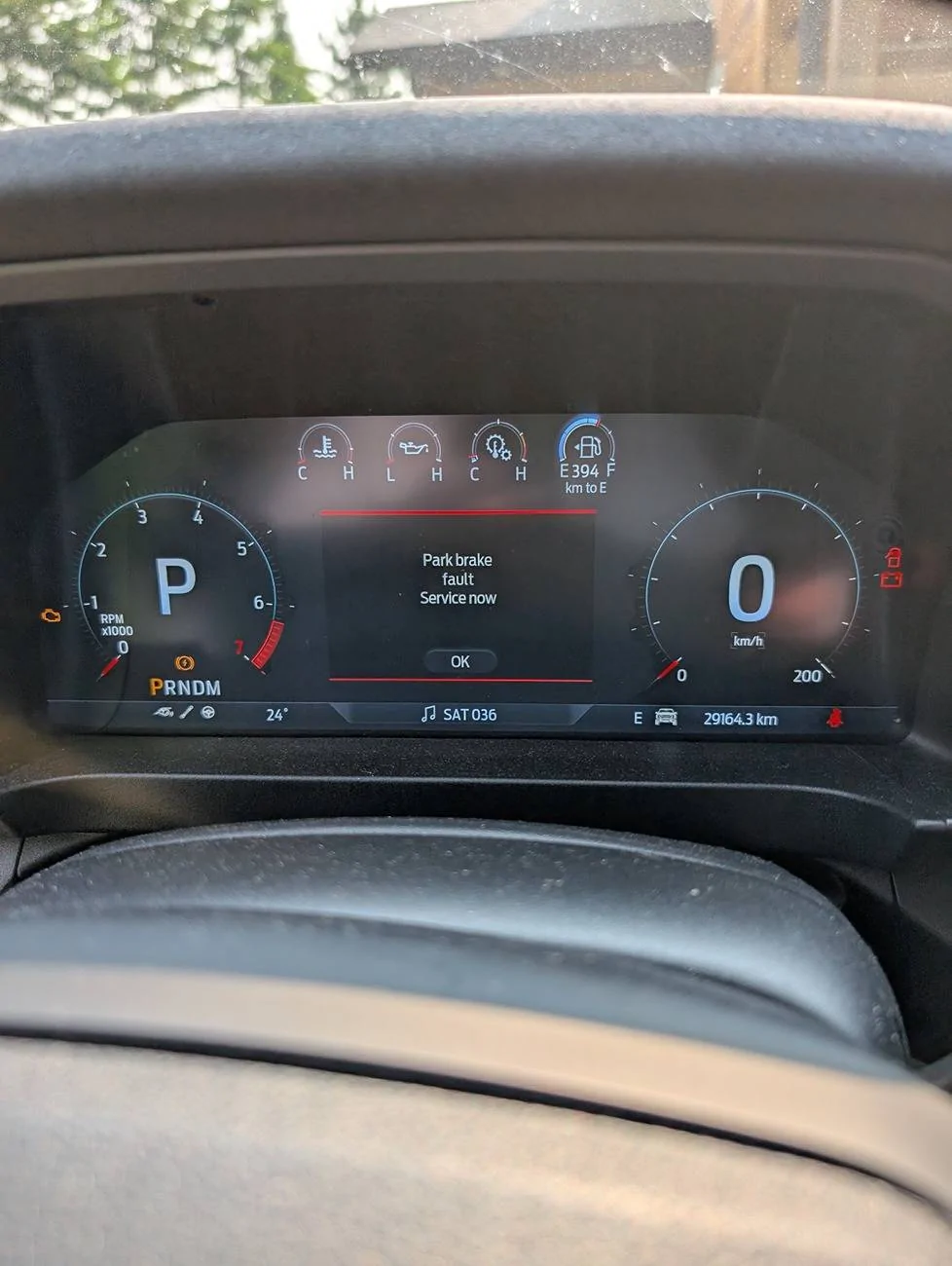

The interesting thing is that the warning goes away when you pull the E brake after you put it in park.
mine doesn’t. I engaged/disengaged it never shut up. Even getting out and letting it sit, as soon as I opened the door without even getting in the truck, it was going off.

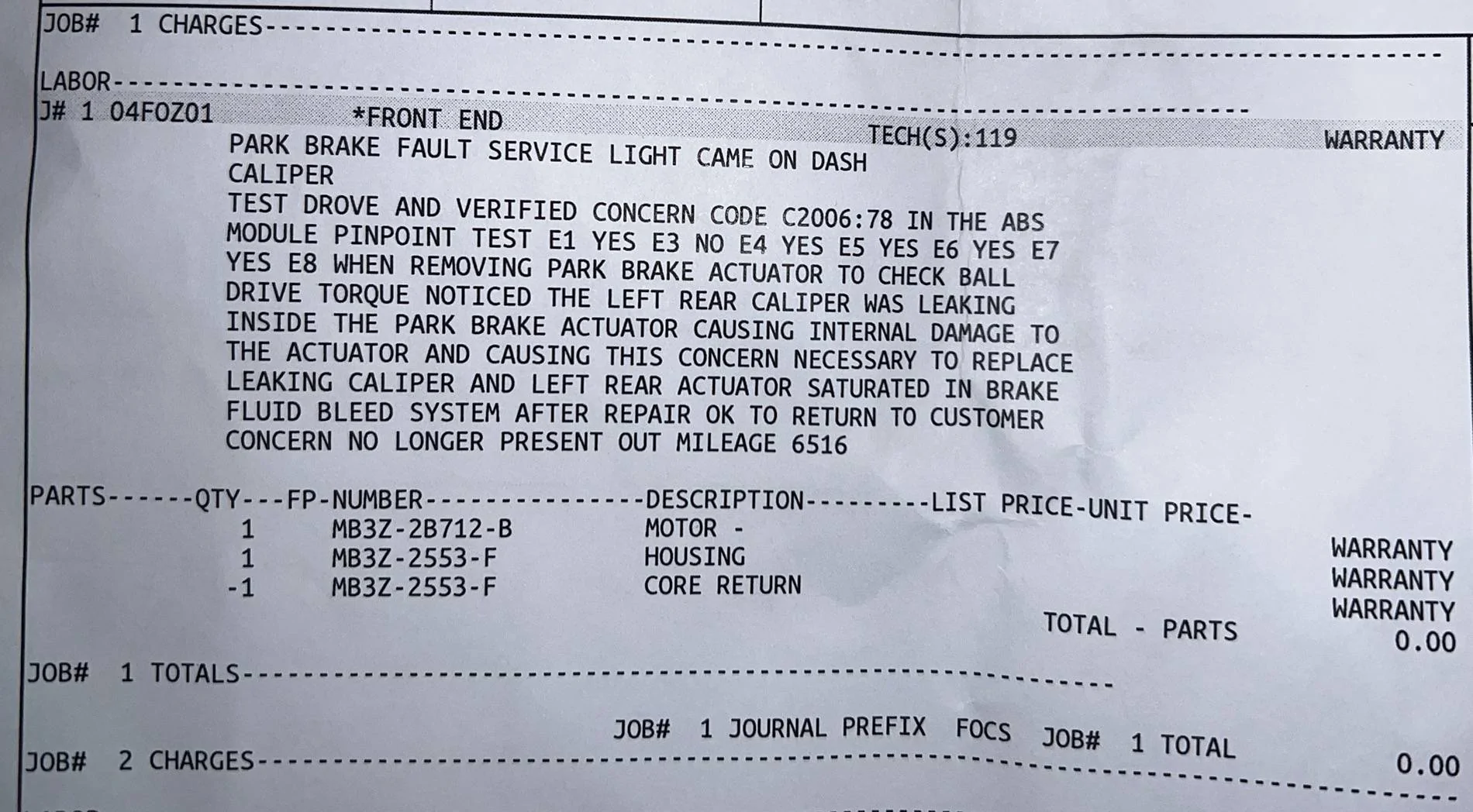

Just heard from the dealer finally. Turns out it was an actuator. Or rather the caliper. Caliper was leaking brake fluid into the actuator. They have an actuator in stock but a caliper wont be in until Monday or Tuesday.
Learned something, too. The actuators are on all 4 corners, and it was the right-front that failed on mine. When I got under the truck to see things myself, i only looked at the rear axle. Not that i would have necessarily seen anything. But I’m old i guess and only expected to see EBrakes on the rear.

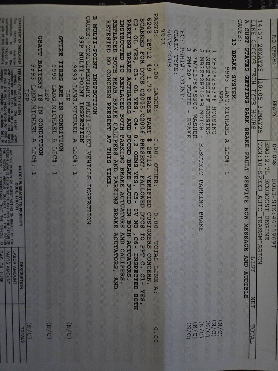

Got my truck back this morning. It was actually ready yesterday but, as i told the guy when he called just after 5pm, I’d already been fighting traffic for an hour and was on the other side of town. LOL.
anyway, slight correction. It was left rear, not right front. Guess the service writer got mixed up. Still gonna get under there later and look at some things.
Here’s the invoice:
Ford Ranger Parking Brake Service NOW!!! IMG_2061
